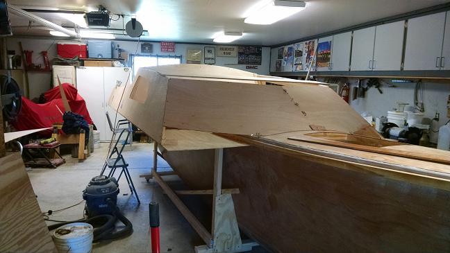

    getting the cabin pieced together!

    looks like a boat! I'm interested to see details of how the parts go together round gunnels.As example, I see rail goes down sides into cabin area, is there false floor on the bunk areas there to cover all that? or inside is that the floor and theres a lip inside.

    Barry,
    I think what you're seeing is where I am planning on a catwalk area to the front. That rail is where it'll be fastened. It only goes in so far and not past the crossbeam tube.The photo may be misleading because I have not trimmed the floor back yet. I've been putting the rear together and haven't got far on the front yet. As slow as I'm going, I'm not expecting to be on the water this summer after all. Looks like next summer, for sure. Got my wife semi-convinced on a sail to the bahamas, but I wonder if the Buc is a big enough boat for that.

    Not from Kansas! Lol
    But I think I see what you mean now on rail
