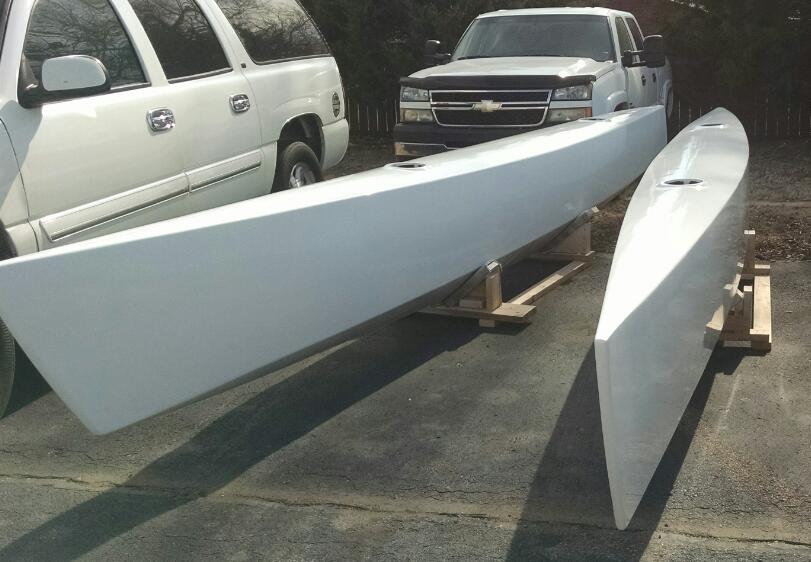

    I am going to try a new filler made by Evercoat. It is a hbrid epoxy/polyester and it's supposed to have the adhesion of epoxy, be real easy to sand, and can be used under waterborne paints. It's called Quantum 1. I'll post after trying it out.
  4. freddyj
    Joined: Oct 2013
    Posts: 291
    Likes: 25, Points: 28, Legacy Rep: 37
    Location: kansas
    freddyj Senior Member
    I tried the Quantum 1. Not awfully impressed for the price. Its a little easier to sand than regular filler but not much. It looked like all I needed is a thin skim coat of which most got sanded off, so I finishednthe amas with regular filler. I only spread about a gallon and half on both hulls and sanded moss of it off or so thin the substrate showed thru. I was careful not to sand much epoxy off. I primed them with two coats of urethane 2k primer and hope to spray paint on Saturday. I'm using du pont imron aircraft paint. It's the same paint they use for watercraft except in watercraft they specify a different mix ratio, which is supposed to make it more humidity proof. It is nice to own a bodyshop to do this in. For a few years my painter was a paint rep for dupont aircraft paint, and once they had him fly to Florida to paint a huge yacht, which they actually painted in the water at the dock! He said it was a gold metallic color. Interesting. Anyway, that's how he knows so much about paint chemistry. So that's what I'm planning and I hope the hulls are not too wavy for glossy paint!
  5. freddyj
    Joined: Oct 2013
    Posts: 291
    Location: kansas
    OK, if anyone is interested. I reweighed my hulls now that paint is on. The first one I built weighed 138 before paint. Now weighs 150lbs. The other one weighs 132lbs. The first one weighs more, I believe, because I screwed up learning to fiberglass and had to put on extra epoxy to make it look good.
    Anyway, they turned out much better than I expected, though not as good as I hoped. I am sure, in a 30 knot breeze no one will notice a minor flaw or two! The paint is extremely shiny!
    Fred
  6. freddyj
    Joined: Oct 2013
    Posts: 291
    Location: kansas
    Here's a photo.

  7. dialdan
    Joined: Jul 2008
    Posts: 59
    Likes: 4, Points: 18, Legacy Rep: 56
    Location: brisbane
    dialdan Junior Member
    Nice work Fred

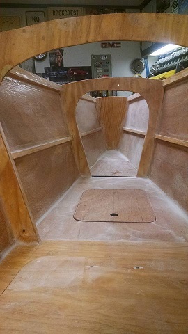

  13. freddyj
    Joined: Oct 2013
    Posts: 291
    Location: kansas
    Getting some interior work done. Forward berth.
  14. bruceb
    Joined: Nov 2008
    Posts: 1,280
    Likes: 59, Points: 48, Legacy Rep: 214
    Location: atlanta,ga
    bruceb Senior Member
    perspective
    That is a view I have never seen in mine :).
    Fred, I am not suggesting it is acceptable, but.. some of the "west coast" style multi builders have used insulation foam for some parts of decks and cabins quite successfully, and I have been using "pink" foam for some of my non-loaded bulkheads and furniture. I have had to go to insulation suppliers though to get 1/2" and 3/4" "roof" grade foam that is a little denser than the usual stuff from the big box stores. Sometimes the local stock just depends what your local building codes require. Yes, even "good" foam has no compression strength at all, so you have to plan (or waste a lot of time redoing) for all your hardware. Its easier on the second boat you build :D.
    FWIW, my 33's hulls were built with 1/2" Airex and a single layer 10 or 12 oz glass in and out, and the hulls are still in good shape 40 years later. I have been using a small layout table for my foam core bulkheads and it is a really fast and easy way to build flat panels that come out almost finished.
