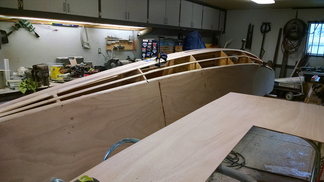

    Getting the bottom panels glued on today. I used 2 layers of 4mm on the very bottom, 6mm between chines, and 4mm on the rest. Got the centerboard trunk installed, and mocked up a board. The floats are done and ready for paint, and at this point I have worked 255 hours on it and I've spent 5k so far. I will make good time because of the parts boat i bought for all the aluminum and stainless stuff. So a little less fabbing for me to do.

    Thanks for the photo freddyj. Your progress is amazing. And thanks for the time and money figures. It is nice to know what other builders are spending on their projects.

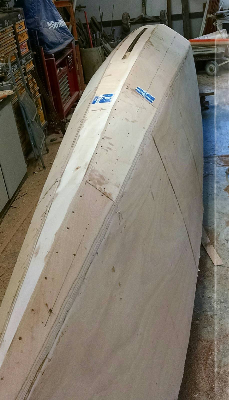

    Bottom panels on.

    Bottoms up!
    Congrats Fred!
    You are making good progress, and I like your choices on bottom plys. With your recycled parts you are well along on your build.
    Another savings with the used Buc parts is the time necessary to measure and cut the beams and water stays. Since yours are already cut and drilled, installing them should be straight forward :).

    looks great! are you justg doing provisions for outer boards for now?

    What do you mean?

    Oh! lol i saw that pic and thought for a second it was a float! lol saw it on phone last night, just saw on pc its main.
