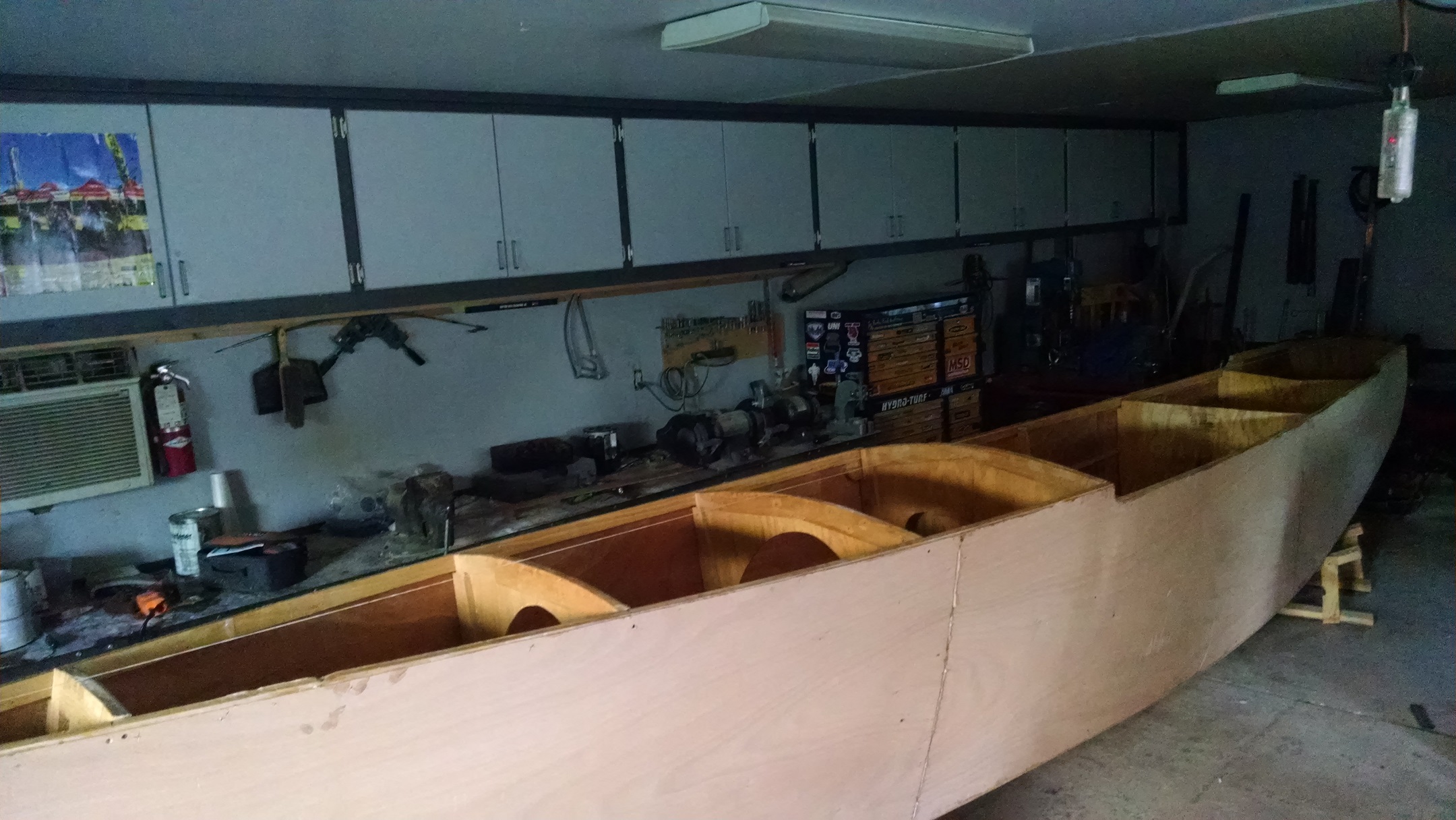

  4. freddyj
    Joined: Oct 2013
    Posts: 272
    Likes: 18, Points: 18, Legacy Rep: 37
    Location: kansas
    freddyj Senior Member
    Frames going in main hull
