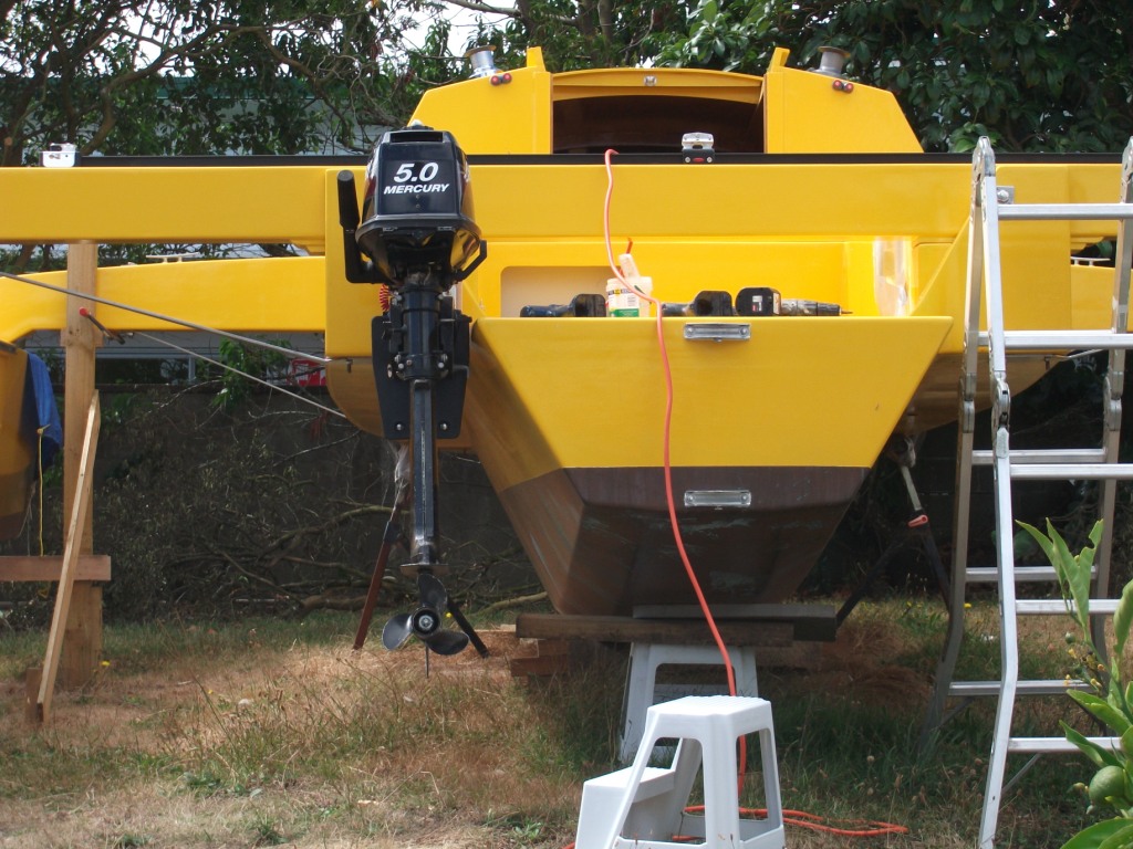

    Steering
    I can link my engine to my outboard rudder, and I think it is extremely desirable. With it, I can do a 180 at low speed in under 35', and really adds to the turning and course holding at speed. My old slip was at the inner end of a row of transoms less than 50' apart, and I never had any trouble leaving or returning. No current, but usually a crosswind. My "link" was a length of PVC plumbing pipe with a line run through it attached at the back of the engine and the back of the outboard rudder and run forward to a cleat on the tiller. Dead simple and less than $10 in materials. I don't have a remote throttle or gear shift, but the side mounted engine is pretty easy to reach and has not been an issue. I intend to set up a little fancier system on my 33, but only because the 33 has an inboard rudder and is not as easy to rig.
    I also have a lifting engine mount that I adjust for conditions. The highest setting works well for easy starting and very flat water, and also gives the best speed. Deeper for windy and rough stuff, and the prop can still come out of the water sometimes. More HP would not help with the prop in the air.
    With my 5 hp 2 stroke, in very flat and calm water I can get a GPS top speed of 6.8 kts wide open, and a comfortable cruise of 5 to 5.8 kts in average conditions. The Buc also motor sails very well, with very low throttle settings.
    I don't have to cross any bars on my lake ;)

    Tom.151 Best boat so far? Crowther Twiggy (32')
    jamez,
    what is the design shown (pics of yellow hull) in your post?
    any more pics ? mayv=be a link to more info ?
    Thanks
    TomH

    Thank you very much jamez,
    Followed the links and can see what you've done - very nice. I like simple.
    Thanks for being patient -- could not mentally connect the recent post pic(s) to the older info.
