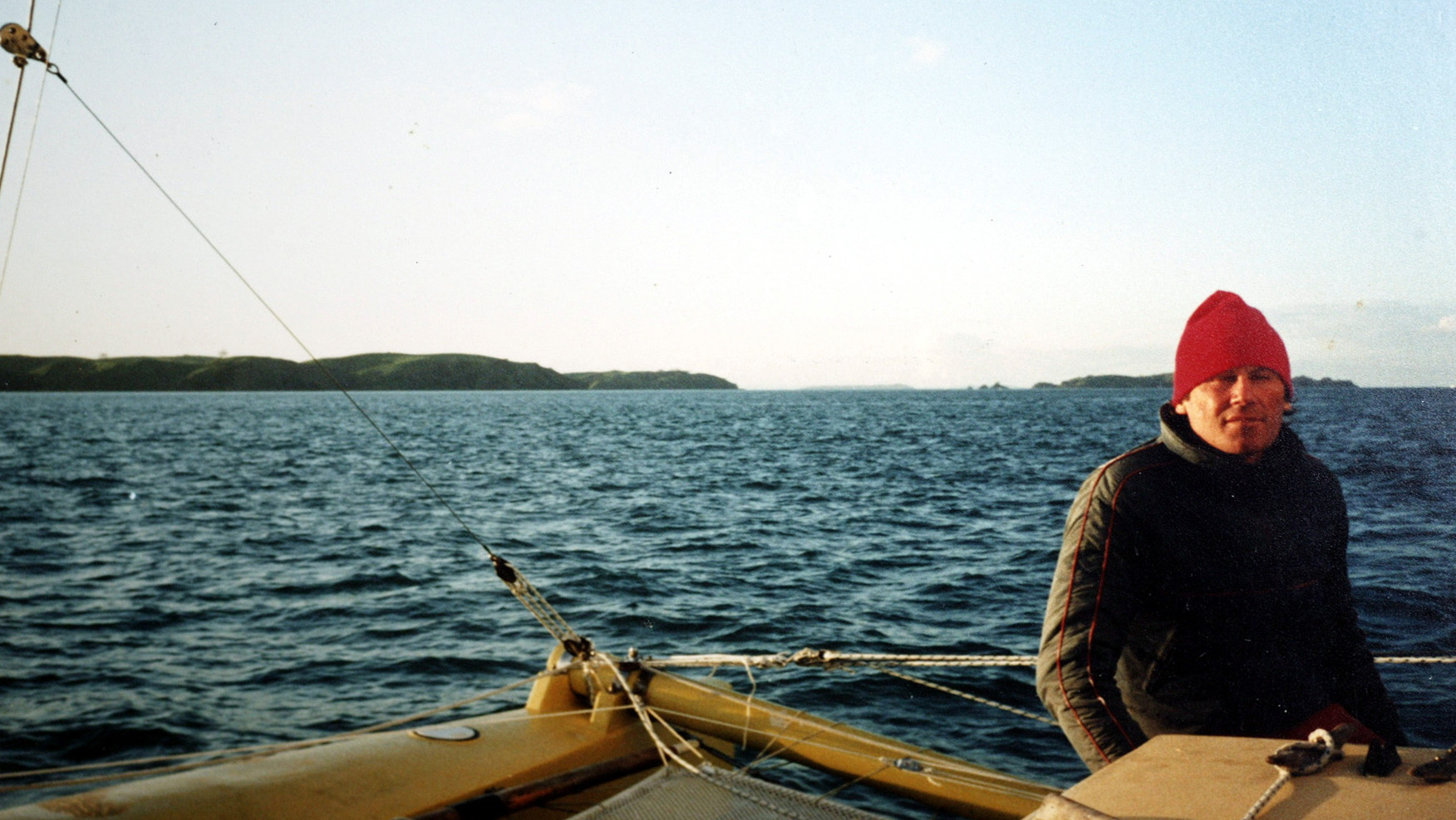

    Here's an old shot of B24 Miranda (pretty stock in those days except for rotating mast and 7/8ths rig) and me taken by owner Malcolm Cheadle during an overnight shorthanded race around Hauraki Gulf islands- but the important point is the tensioning runner on the shroud, sort of a compromise stay and backstay in one (and a half); - very simple, very effective in keeping forestay tight.
    We had a main traveller problem an hour or so after start, had to bodgy it up, lost time there but still came in 6th next day ... and an easy first on handicap - we were smallest in fleet.

    Old photos
    That must have been a LONG time ago- that guy in the pic looks young ;). Nice photo though, thanks :)
    Is that a "stopper" right below the tackle to keep the block up the stay? My new side stays for the 33 are dynex dux, and I am expecting to do something similar or add running backs to the rear corners.

    Young punk I was, yes, look a bit sleepy eyed, helmed all night. Would have been in the mid 1980's.
    Yes, that is a stopper.
    Another method would be a spllt rigging connection with an eye and shackle at junction.
    You can see our lash up with the main traveller in the above shot.
    Later went to a curved track instead of the original wire and clutter; see this photograph..
