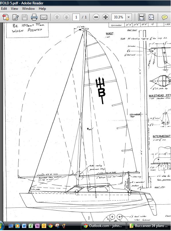

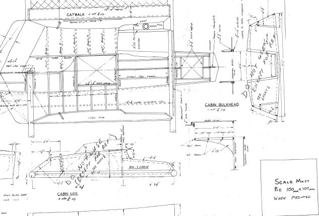

    Here's another, maybe dumb, question. The plans call for a centrally located rear chainplate. How does this work when the same space is where the rudder resides?
    Confused in Kansas
  12. outside the box
    Fred
    As shown on the sail plan as attached the transom chain plate is not used.
    As shown on the Transom in another as attached it is there.

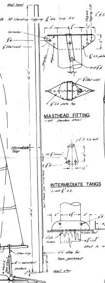

    Our own did not have the transom chain plate nor did the masthead fitting as built to plan have provision for same aft stay, only provision on the masthead fitting area on plan as attached is halyard and topping lift.
    Hoping BB or OS7 can offer a qualified opinion to help you further.
    Regards
    Craig and Team Ezifold

    You could always split the backstay with a bridle above head height and attach the two tails to a chainplates at both corners of the transom, in order to avoid the conflict with the rudder/tiller position.
    But only if you want a permanent backstay and don't intend on having a fathead main.
    If the latter, and you *do* want a backstay, then you'll have to settle for running backstays, and it's probably best to attach them to the outer end of the aft beams, with a tensioning line and block system attached further aft on the ama, lead back to the cockpit so you can adjust the tension at each tack, in order to allow the top of the sail to flick past the upper end of the backstay.
    And of course enable you to adjust the tension on the mast to adjust the shap of the luff on the main.
    Or at least, I think that's what it's supposed to do......perhaps someone with a better idea of the split/running backstays can correct this?
    I know I've seen lots of cruising cats with split backstays, but they are attached to the main hulls, and don't see as much flex as a tri might, and thus changes in tension....
    I'm a bit curious about the principles involved, so if anyone cares to comment - nicely - it would be appreciated.
  14. oldsailor
    Joined: Apr 2005
    Posts: 26
    Likes: 1, Points: 0, Legacy Rep: 17
    Location: Sydney. Australia.
    oldsailor Junior Member
    Sheet 2 of the plans clearly shows a chainplate on the transom.
    I cannot account for that. The B24 has twin mast top backstays which extend out to chainplates on the floats. There is no provision for a single back stay in the design. It may just be an oversight from an earlier drawing. :eek: Or it may have been a re-inforcement for the backing of the rudder pintles which was mistaken by the draftsman as a chainplate. We will never know. :(. When we built our own B24 in 1971 we just ignored it and never had a problem.
