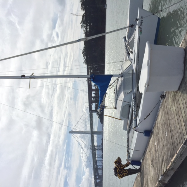

  8. Cleveland
    Joined: Nov 2013
    Posts: 29
    Location: San Francisco
    Cleveland Junior Member
    Really nice Freddy.
    Got my boat back in the water, dry as a bone! Motored over from Richmond to Ti this morning where she'll be berthed. Gotta reinstall all the rigging and build a new dagger board still before I can sail. She's so light, I can tell its going to be a rocket ship.
    I found out I have a larger mast on it already. I need to contact the place that made the sails to find out the measurements. I ended up cutting out and replacing a couple feet of the gangway on both sides as well as the starboard cockpit seat. Also sanding and glassing the rudder again. So now that its back in the water ill paint the topsides completely before reinstalling all the rigging.
    Im so excited, thanks to everyone who gave me advice.
  9. Marmoset
    Joined: Aug 2014
    Posts: 380
    Location: SF Bay Area
    Marmoset Senior Member
    Awesome, congrats! Boat looks good in the water. And is it me or did they do a bit of bubble or something on the roof line? Maybe it's just the angle but it looks more than just usual rake, it almost looks convex or something.
    Barry
  10. Cleveland
    Joined: Nov 2013
    Posts: 29
    Thanks Barry, Yeah the cabin top is domed is that not standard? i haven't compared it to the plans, lets me sit on each side with a couple inches head room towards the back of the cabin. The hatch cover is also curved and slides nicely forward. The strips in the cabin top are nicely laminated curved beams.
