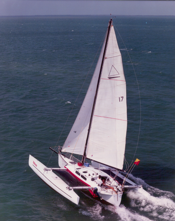

    Thanks for the response philSweet. Correct, it is called a cat due to its cat rig. Indeed I am interested in this kind of rig on a catamaran or a trimaran since a rotating free standing mast would be easier accommodated on the tri. Ideally it would be a production boat in the 40-45ft range that can be sailed prior to purchase.
    Since I sailed the Wylie I've been doing deep searches but so far no luck.
    BTW about AICW Bridge Clearances, all the non-opening bridges have a project height of 65 feet. The one exception is a fixed 56-foot bridge at Mile 1087 between Fort Lauderdale and Miami.
