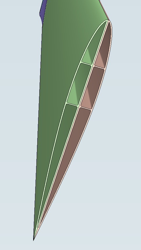

    been trying to work up a plan for fabricating/laying up the central support and it seems really really difficult to do accurately.
    are you a hundred percent sure that split asymmetrical boards are fantastically better than a single symmetrical board?
    Single is far easier to build and maintain and operate. Its plain cheaper.
    occasional 1/2 knot loss? I'd take the symmetrical
    2 knots down? maybe.

    @uponstands: This seams to be a good implementation suggestion. The attachement is similar to what they use for dutch tjalk leeboard.

    large helo blades are likely to have some weird camber built in so most likely not useable. Break out the carbon tow and the resins.

  9. brian eiland
    Joined: Jun 2002
    Posts: 4,962
    brian eiland Senior Member
    That might be true, I've never really tried finding them before. But I suspect you could find one blade (one is all you would need) that you could convince the 'authorities' that you intend to cut it up into several lengths (maybe in front of their eyes). And I'll bet there are some really nice carbon fiber ones around.
    No sir I am not 100% sure that the two asymmetrical boards are that much superior, .....probably are superior, but to what degree, question mark. I likely chose that arrangement for its 'symmetry', and the fact I was replacing two boards (dagger or centerboards) of the conventional approach,...so two asymmetric boards became my choice.
