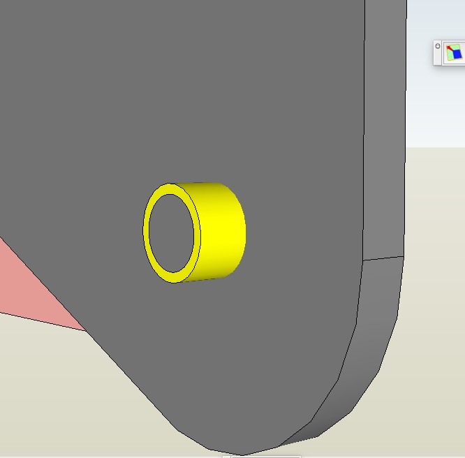

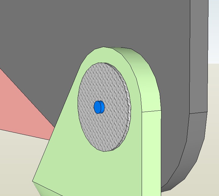

  13. UpOnStands
    Joined: Nov 2015
    Posts: 681
    Location: Sydney
    UpOnStands Senior Member
    this suggests possible implementation
    yellow is UHMW
    4 cm dia hole thru the stub arm is not shown :mad:
  14. brian eiland
    Joined: Jun 2002
    Posts: 4,962
    brian eiland Senior Member
    You are pretty handy with those computer generated illustrations. Wish I could do it,... just never took the time to learn this new technology
