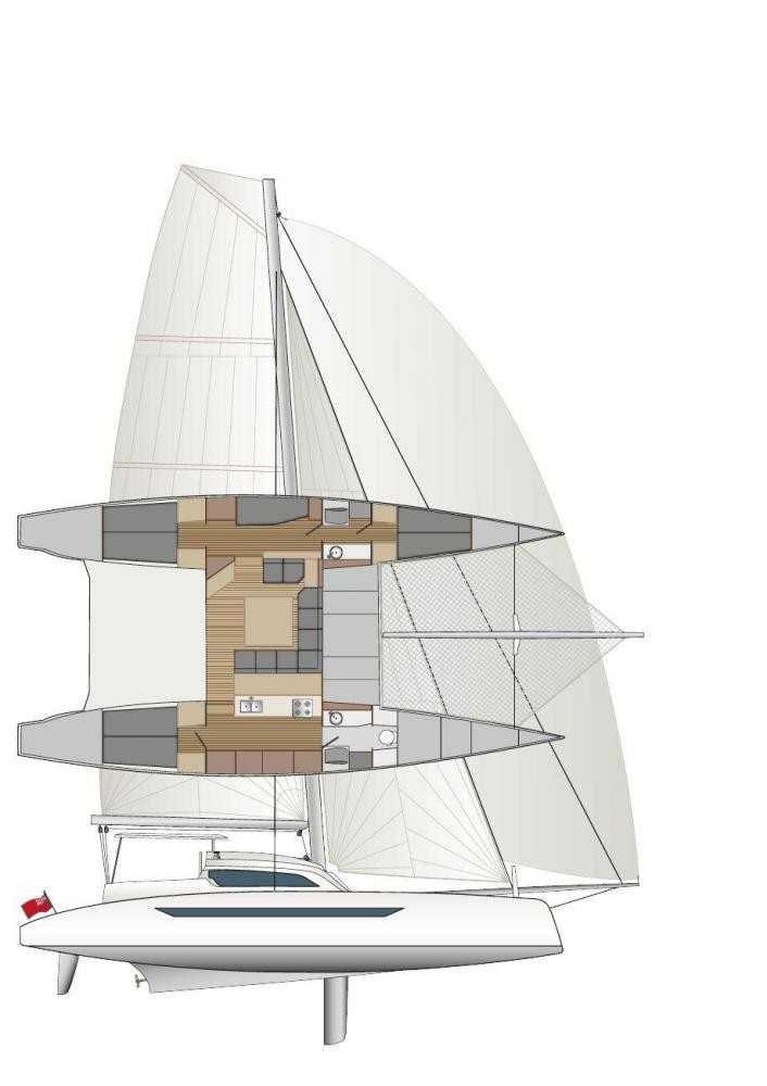

    You would surely think they would say something about it on their website,...or there would be other chatter somewhere?...or maybe at least one photo (not just a dwg).
    I can find NOTHING yet.
    In fact I am still so confused about their website and their subsequent builds, that I am unsure as to whether they are still utilizing any type of skeg, and/or how many vessels they built skegs on.

    Concerning the tiny canard board, the " zero degree stabilizer", that one that seems to exist only on the drawing :
    perhaps it's advantage , the " new feature" ( avoiding broaching ) , is still too unproofed, too new, too hot to handle ?
    Or, simply unknown.

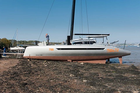

    Note the shadow, i guess that this keel is not a dart keel, it's a delta keel- a skeg.
    Also interesting , board's slot is not in the delta.
    Newton made a lot of compromises.
    pogo

    The skeg is an interesting design point. You could say its the fixed equivalent of the bow centerboards (mirrored asymmetrical? probably) of the design drawing. The skeg could have positive values but do they outweigh the extra drag? Probably this is for another thread.

    The mirrored equivalent of the fixed canard board ?
    Mmh.....
    No.
    The farer the delta keel , respective it's center of lift , is positioned towards the stern, the less effective it's function as stabilizer---lever arm.
    The rudderblade , directly under the stern , thus farer aft , can't act as a stabilizer ( a course holding zero degree stabilizer) at all, ' cause of the position of the pivoting point -- at cl of delta keel ( or conventional daggerboard)
    The rudderblade is set to leeward, lifting the stern back to windward , avoiding the curve to windward.
    Note ; we are talking about surfing , broaching , yaw effect.
    pogo

    should have been more descriptive. The port bow canard mirrors the stbd bow canard is what I meant.

    Edit: Joking aside the Dazcat D1495 & 1395 use regular daggerboards as leeway preventers; the fin-like skeg on the dart-like keel provides yaw resistance and a solid exit point for the props and ??.
    Dazcats would have tell us how much lee resistance the keels provide.

    I think you got it all correct there Pogo, .....including that unexplained canard fin/board/whatever. I do know for a fact that I would NEVER consider such an item on an ocean cruising boat.
