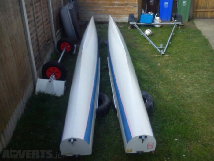

    ...from another forum discussion, Asymmetric Cat Hulls
    With the Prindle hulls you will notice a more pronounced 'toe-in' of the keel lines. ( I termed it 'biting their way to weather')

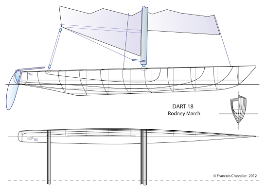

    Dart 18 cat
    Look at this website I just found while looking for a close-up view of a Dart's hull,...very interesting material and history
    http://sailingtrivia.ravenyachts.fr/2013/08/the-evolution-of-sailing-multihulls.html
    ..at the very bottom of the page, the Dart

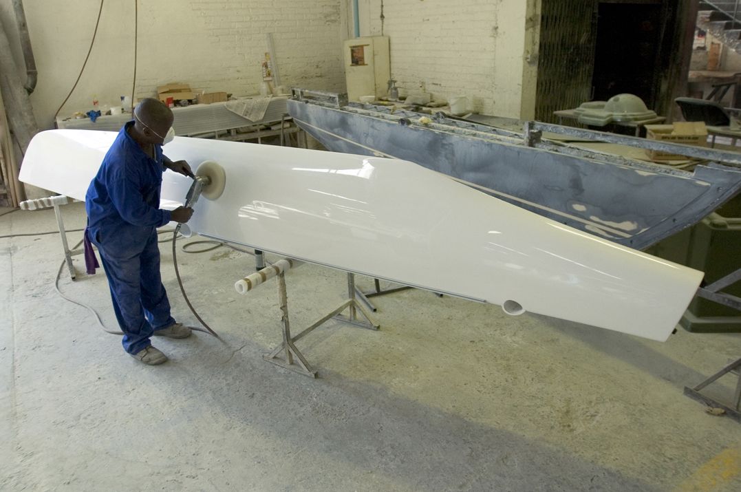

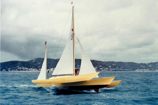

    thanks, this is the good information. Now does it scale, say to 10m?
    Immediate reaction: just from lines it looks like it would hobby horse just about everywhere.
    Max buoyancy at a station, pronounced rocker, fine fwd entry.
    If you load it down so the WL is far above forefoot, wouldn't tacking be difficult/impossible?
    We need Ilan Voyager's help in finding his friend's cat. 14m at 3800 kg. You are probably the closest to the last known position of Mekong/Cambodia.
    edit: Must be getting old, looked at those photos hard and still can't see how the hulls resist lee drift, anywhere.

    I wrote that the boat was made in my shipyard. So you can assume I made it.
    About the light weight. That ¡s for your education; do not compare 2 very different boats. The lone common feature they have is to be catamarans.
    Imagine now a boat for the tropics 12m like a 1988 F40 with already slim low freeboard hulls (1 m at the LWL), just add 2 meters in the central portion. Very moderate width.
    Spartan accommodations for 2 with only 1.50m head in the hulls, not luxury for 6. Just 2 light outboards 100 kg each and a 2kw genset (25 kg) not hybrid diesel engines.
    2 short masts with only a 35m2 mainsail per mast. A very low center of sail, so the stresses on the rigging and the hardware are very moderate. The compression by the masts on the beams is ridiculously low. A 95m2 mainsail on a 18m mast is another thing...
    The efforts on the hull induced by the Dart keel are nothing compared to a beefy deep daggerboard. Furthermore the dart keels act as protectors of the bottom of the hull. So no need there of a thick lamination against the abrasion and punctures in a dry mooring. The dart keels add a lot of vertical mechanical inertia to the hulls, so you can go lighter in the scantlings. It's a virtuous circle.

    I don't detect pronounced rocker. As far scaling it up it would have a very fine slenderness ratio. I've only sailed on one twice in my life, and it certainly did not exhibit the hobby horsing that a Hobie cat exhibited.
    I also liked very much the boomless feature.
    BTW you do realize that tacking a multihull (big or small) is a little different that monohulls. You are best advised to sail the multihull in an arc to complete the tack,...sail it thru the turn. DO NOT throw the rudders over quickly expecting the boat to 'pivot' around'. Sure having bows just kissing the water can be helpful, but they are not necessary in all instances.
    If its over in this area I could make a real effort to go find it, as I am up in the northern part of Thailand right now for the next 3 weeks.
    I don't quite understand the hydrodynamics of it myself, but as Pogo pointed out earlier there are 'body shapes' that can accomplish what some of our foils/wings can do.

    Many thanks for the Dart pics and drawings. I did not remember that the hulls were so in V, The Loday's dart keels are very different.
    On the cata of my friend there were true apexes, more like a skeg, with thinner sections. When I built the boat, I made the bottoms of the hulls in strip plank and added and faired the apexes, that was the only way to make them. The leading edges were very thin, a 5 mm titanium rod was added after routing the fiberglass edge , glued, screwed and faired to respect the radius of the edge. The trailing edge a 2 mm plate was embedded in the fiberglass.
    My friend insisted heavily that the complex profile should be respected within the millimeter and controlled several times the work. That means for me that he calculated carefully the shapes and wanted to have it working as intended.

    Thats funny. I'm not sure why we are comparing H16 and Prindle 16 hull shapes . INFERIOR?? really.
    Geof Prindle had Hobies work to build on yet performance was similar. Infact the VYC yardstick for the Prindle 16 is 2 points slower than the Hobie 16.:D:D
