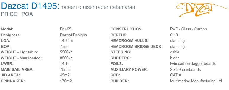

    Are you saying that the Dazcat 1495 has both a Dart appendage and daggerboards?...seems like it??
    I looked pretty thoroughly thru there website and saw none of their models that utilized both of these features concurrently.

    taken from the Dazcat website for the 1495
    "A combination of optional dagger boards and dart shaped keels are optimised to create "
    "as the keel shapes are designed to reduce the yaw effect that can be experienced in larger seas sailing downwind."
    assume you will check with the Dazcat site to confirm http://www.dazcat.com/d1495.html
    D1295 - no mention of dart keels only daggerboards
    ditto D1195 and D1095.

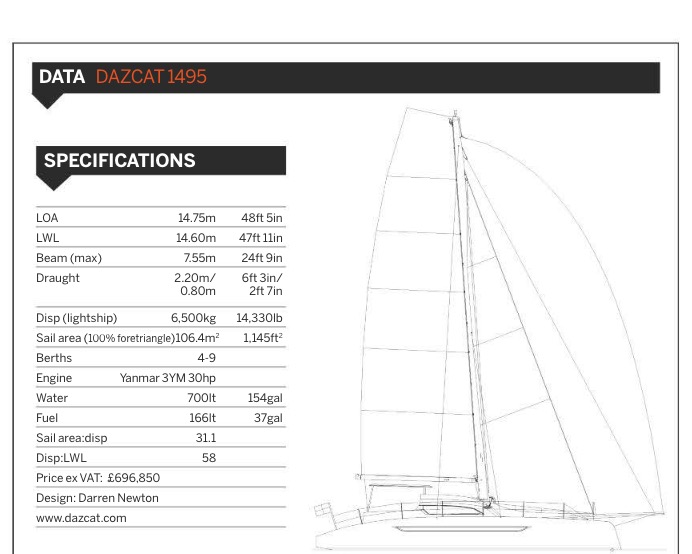

    of interest. No draft numbers are given on their web site.
    see http://www.boatdesign.net/forums/mu...d-why-dont-they-work-57051-29.html#post799043 for what is available.
    is 2 ft 7" shallow draft? see page 63 https://ia601907.us.archive.org/0/items/Yachting_World_March_2016/Yachting_World_March_2016.pdf
    my error. they must mean with boards down and boards up.

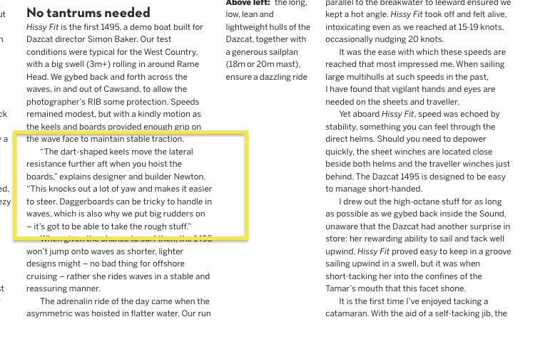

    Perhaps their 'claims' are mis-spoken, or they have mistakenly made the claims for their whole line of designs in that one statement. In other word you can have the option of daggers or dart shaped keels. LOOK thru all the photos on their website and find me one of their designs that has BOTH daggers and dart keels on it?? I don't think you will find one. You might say they have an error in their own description.
    While we are on the subject of their website claims,
    I believe what they are saying here is that the keel shapes (vs daggerboards) act to help reduce the yaw effect. I could agree with that statement, but contrary to what you are insinuating that the daggers and dart keels act to accomplish this. As I have said before one would NOT want any daggerboards nor centerboards down when running downwind in a big sea. You don't want a grip on the sea in these situations

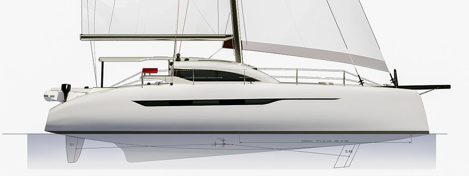

    Hissy Fit has "dart shaped" keels and daggerboards. Note: Not "Dart" shaped meaning like the Dart beach cats (which are integral part of the hull, almost deep V) but dart as in a triangle shape.
    other Dazcats have round bilge hulls, kick up rudders and daggerboards, no keels. it depends on the design. And as I always say, if you want inboard engines you need keels, with/without daggerboards as well. As on for example, my Transit 38
    I won't post photos to prove it as you can easily google the Dazcat site and Facebook page. As i say, I know Dazcats well and have known Darren, Biffa and Derek for over 30 years.

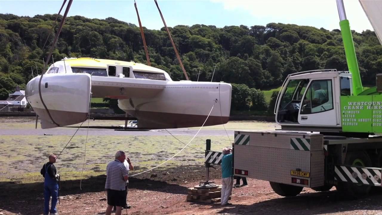

    how about the launch of an actual boat D1395? Dart plus daggerboards
    https://www.youtube.com/watch?v=8R6G-3ZVrSc
    how about some photos and interview with the designer? Yachting World March 2 2016.

    Isn't the keel on this D1395 an integral part of the hull?
    edit: I suppose my real question is "what hydrodynamic feature constitutes a Dart keel?"
