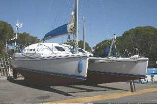

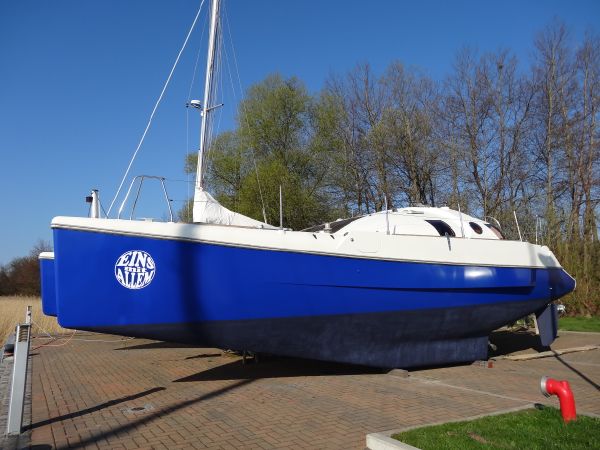

    Could someone please explain the hydrodynamics of a dart shaped keel to me please :)
    I assume it has a naca type profile ? Is it the Delta shape that makes them work ?
    I assume they aren't " all the rage" because unlike the stub type they don't support the boat on the hard ?
    Or is there another reason ?
  7. pogo
    Joined: Mar 2010
    Posts: 342
    Location: Germany Northsea
    pogo ingenious dilletante
    Such a "hull intergrated keel " gives a deeper forefoot and volume for a motor .
    similiar to ancient longkeelers the keel is the hull and vice versa. The frames in the fore-and midsections ,are more ore less , of S-type--more surface.
    http://sailboatdata.com/viewrecord.asp?class_id=4542
    Note props at trailing edges:
    http://www.boats.com/sailing-boats/1989-beneteau-blue-2-5953791/
    http://en.advisto.com/auctions-classifieds-sale/boats-107217.htm
    pogo

    dazcats now use daggerboards. only the 1495 model has a dart appendage supposedly for relief from broaching in following seas. Main foils are daggerboards. Deep forefoot = not so great draft.

    Hope you don't mine, but I chose to excerpt a few of those skeg photos from your links,...because they are 'for sale items', those links will disappear.

    I'd have to see an accurate lines dwg to be sure but it appears that the max depth is reached mid point of the hull so there is little emphasis on fwd volumes. The Dart keel simply stops the aft of boat from skewing sideways and thus takes some of the loads otherwise resisted by the rudder.
