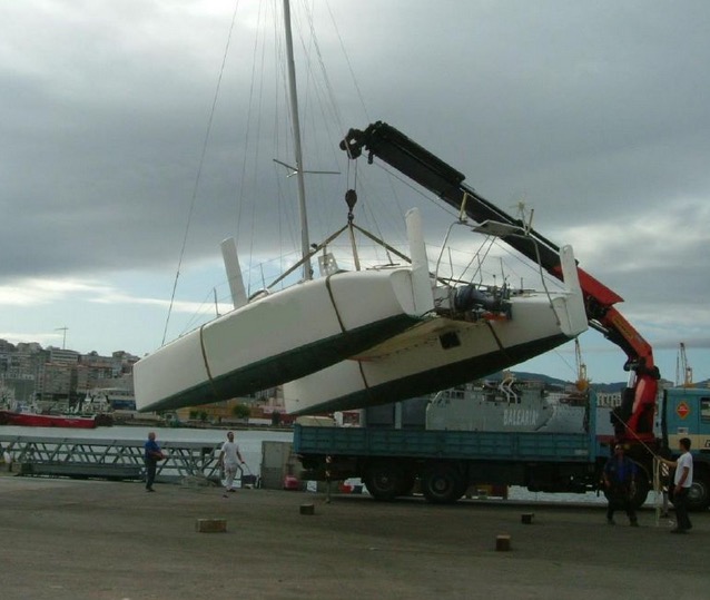

    The father of the idea is Rodney March, and it's an excellent idea. This supremely elegant solution works pretty well on any size of catamaran, it has just to be adapted during the design stage. It's simple, rational, and has nothing to break. Surely the winner of the Occam Razor prize.
    Like I said already if I want a no worries cruising catamaran with decent performances I take this solution, and I work hard on the displacement, sail plan, rigging and hardware which are the true factors of good performances on a cruising simple tech catamaran.
