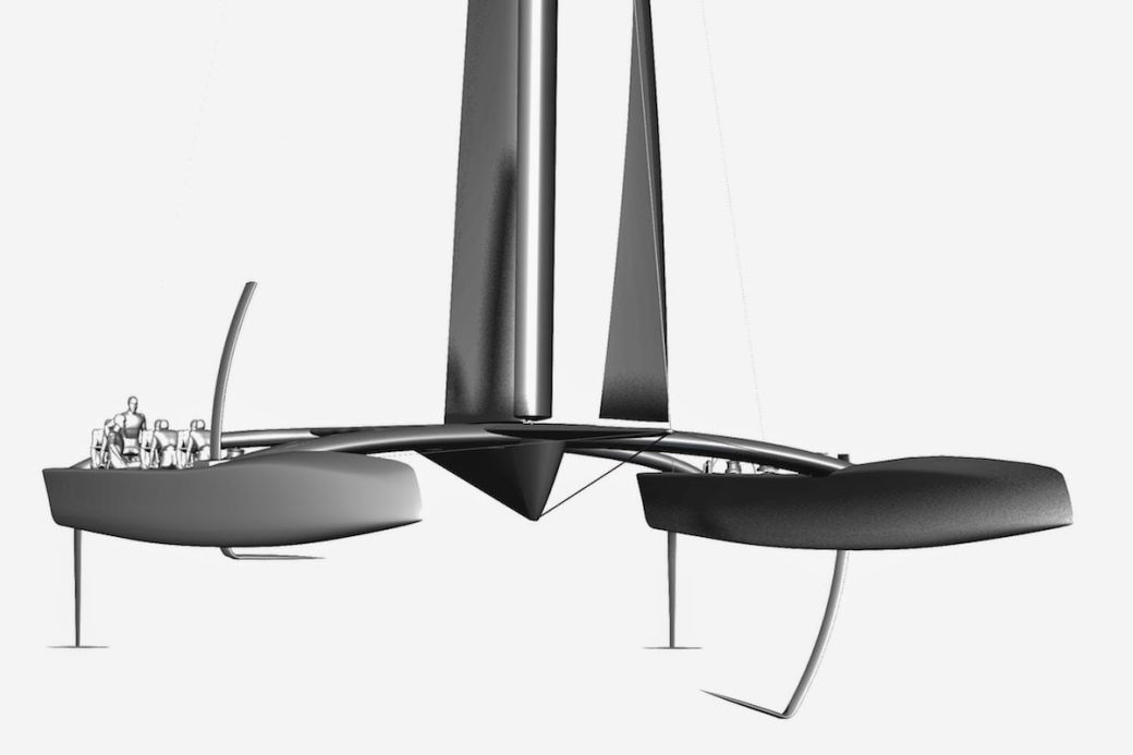

  7. valery gaulin
    Joined: Jan 2017
    Posts: 177
    Likes: 4, Points: 18, Legacy Rep: 7
    Location: Montréal
    valery gaulin Senior Member
    Kind of like this simple picture

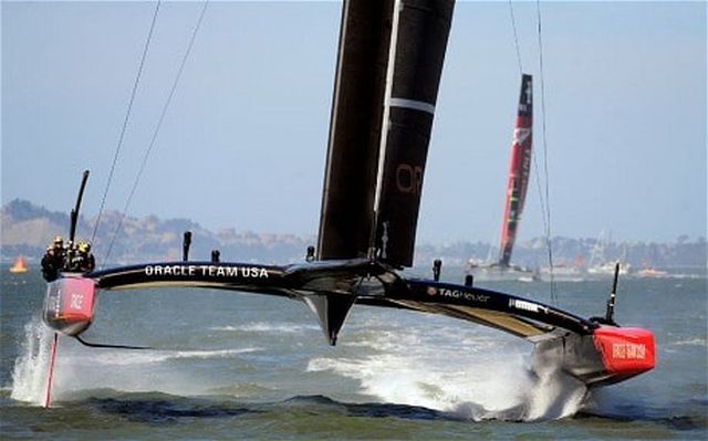

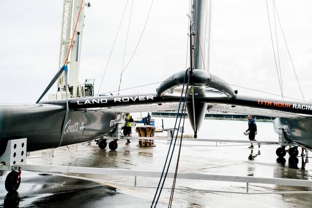

  11. brian eiland
    Joined: Jun 2002
    Posts: 4,962
    brian eiland Senior Member
    Center Structure on Team NZ
    Take a look at that upper portion of that center 'pod' structure on Team NZ's new boat,....at time frame begining 2:08
    More on TNZ's new boat: https://www.youtube.com/watch?v=4SVT44tmWFw
    ...not that we would build a cruising cat like that, but we might try to emulate that central spine.

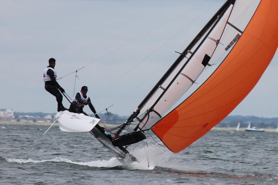

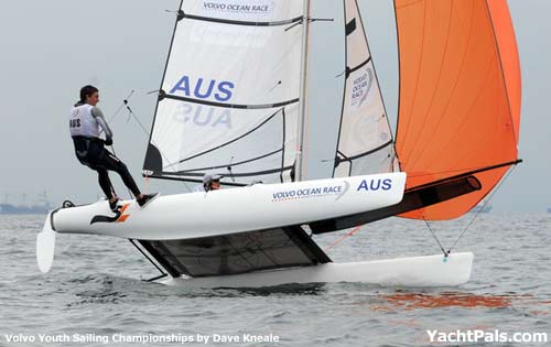

    You have also the very good solution shape, first designed bu Rodney March (he "committed" so many good designs) in 1976 for the DART 18 beach catamaran.
    This design has been copied on dozens of designs small and big catas with always good results. The performances are very decent even good. I remember a pair if sisters, no more than 220 pounds together, with their improved Dart 18, who were a pain in the a** for all the machos in the regattas in light and medium wind. Their Dart was astonishing fast.
    There is nothing to break, and if hitting something, the hull simply climbs and slides on the obstacle.
    On big catas that gives plenty of room for the tanks. As always there are cons; more work making the hull, more wetted surface, a bit heavier.
    If I want a no worries beach or cruising cata, I take this design immediately.
