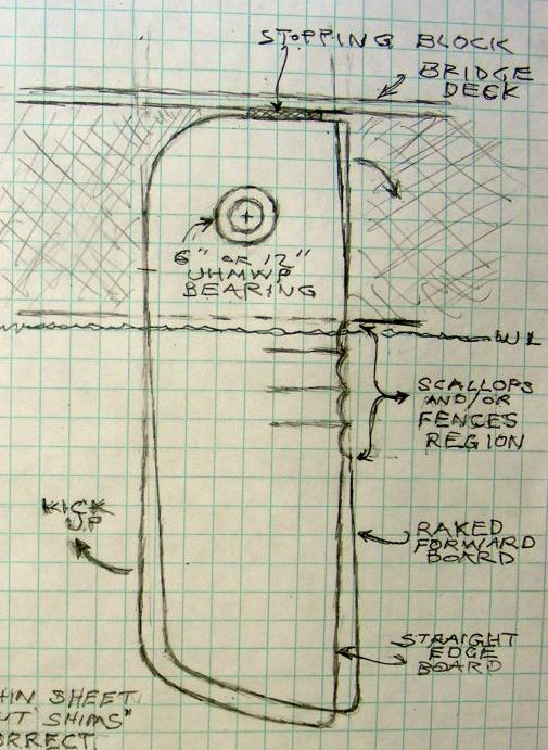

    It was for this reason that I chose to have my centerboard foils to be ALL asymmetric in shape from top to bottom.
    Now take this asymmetric shape and give it a more elliptical rounded leading edge, and cut the foot and the head off of the board something like I shown in the sketch here...

    Perhaps that multiple scalloped board I displayed in the first sketch I posted could be modified to a single big scallop at the leading edge waterline region,
    .....with a mellow fence like the ones on this skeg
    This might purposely mis-align the board's leading edge juncture at the waterline with the rest of the leading edge down deeper,...upsetting the direct path that ventilation might take down a leading edge.

    A single small scallop in the LE works only if the ocean remains perfectly flat. Something with vertical extent of 40-60 cm is needed. And most that under the static WL.
    edit: this of course means that your uniform profile is no longer uniform. sorry about that.
