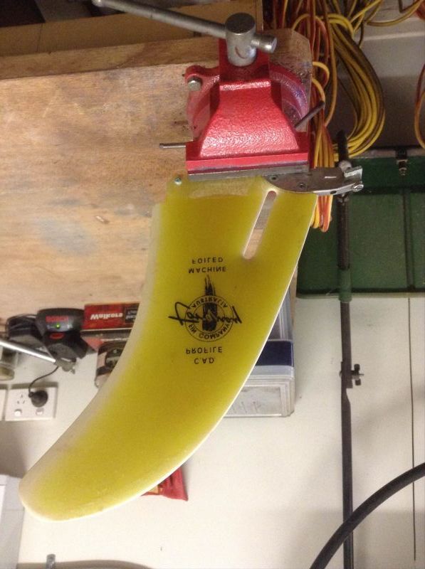

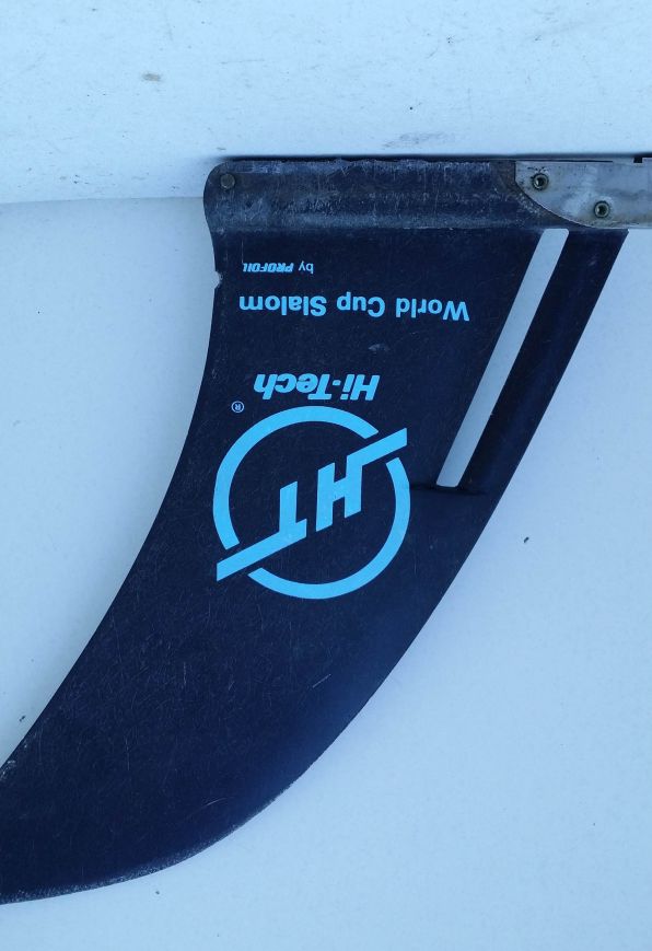

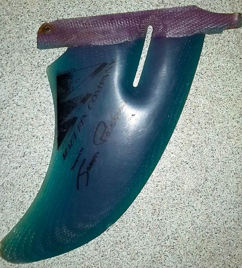

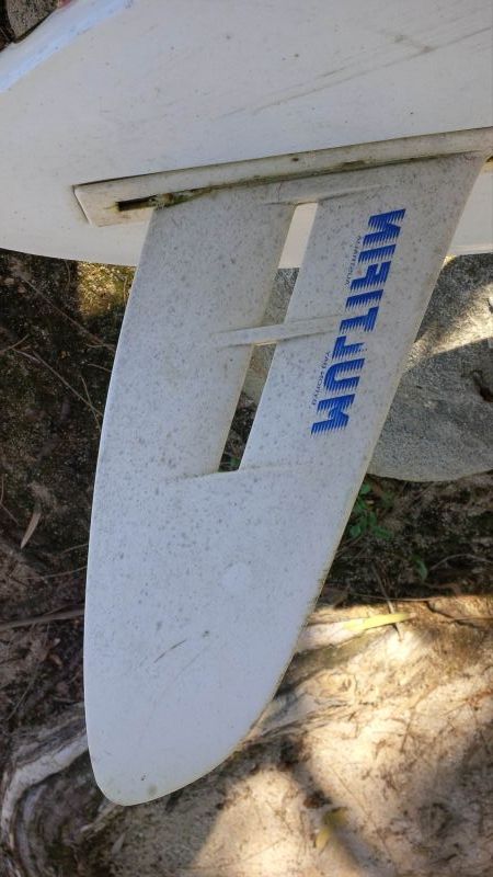

  7. brian eiland
    Joined: Jun 2002
    Posts: 4,962
    brian eiland Senior Member
    Windsurfer Skeg Experiments
    Wonder if we could learn anything from wonderful old windsurfer skeg experiments? I just ran across this old memory lane....
    http://www.seabreeze.com.au/forums/Windsurfing/Gps/Sailboard-Dinosaur-Fins?page=1
    Wonder what a slot up behind the leading edge of the board at the waterline would do to stall off ventilation initiation at that venerable point?...and/or keep that ventilation propagation from traveling down the leading edge of the foil??
    ...just brainstorming ;)

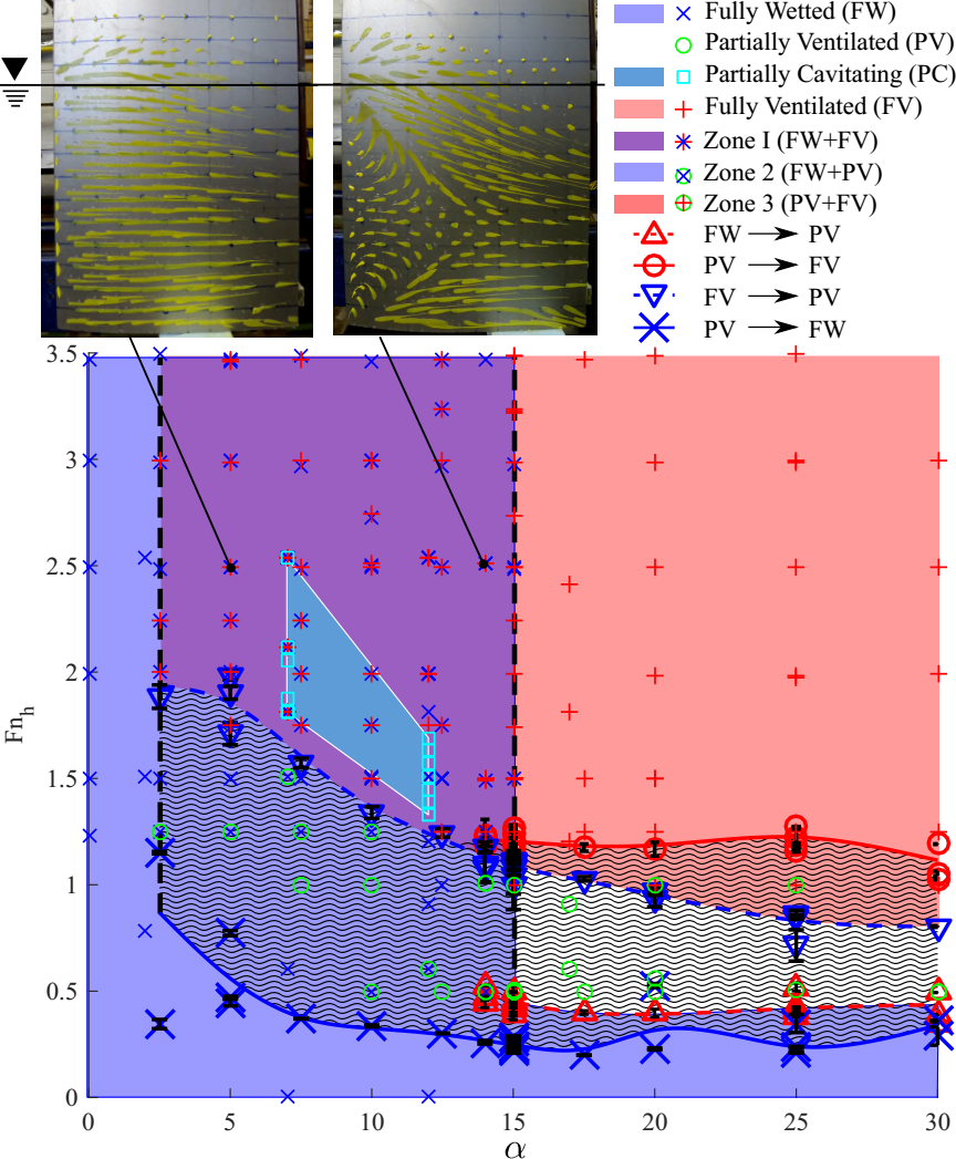

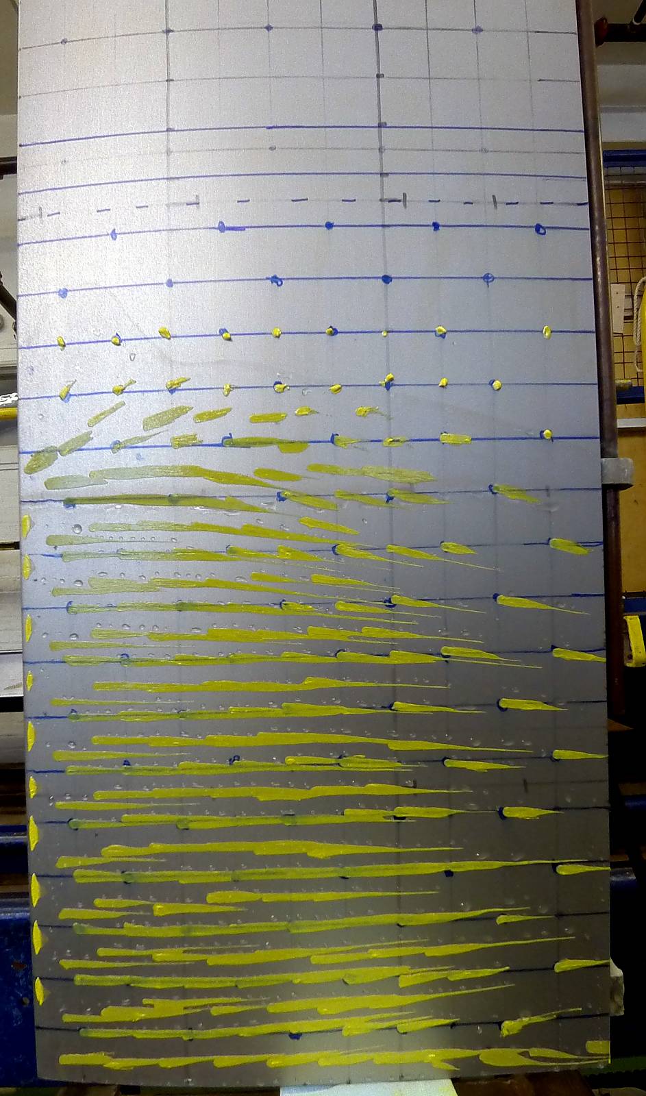

    Hi all,
    I was referred to this thread by Brian, who left a comment on one of my YouTube videos. I've been reading some interest, as ventilation has been my research topic for several years.
    There honestly isn't a whole lot for me to contribute at this point. Daiquiri hit upon almost all of the salient aspects of ventilation. For suppression, minimize adverse pressure gradients (and thus suction peaks) near the free surface.
    Fences can work, but some of the work by Swales, et al in the 1970's showed that fences can increase the tendency toward ventilation in many circumstances. (http://journals.sagepub.com/doi/abs/10.1243/JMES_JOUR_1974_016_005_02)
    Daiquiri also mentioned the fact that ventilation itself modifies the flow, and I want to add my agreement. All it takes for the inception of ventilation is a tiny region of separated (i.e. stagnated) flow and pressures low enough to pull air into that region. The fact that the free surface cannot sustain any chord-wise pressure gradients (in most cases) means that the requisite flow separation never occurs AT the free surface, but rather just below it. If something (waves, debris, etc...) perturbs that thin attached "seal" at the free surface, air may enter into the ventilation-ready regions residing just beneath and "blow out" the flow. The ventilation doesn't remain confined to the separated region, but will create it's own flow separation as it propagates across the foil.
    In the attached picture, you're looking at the paint-streak flow pattern on the suction side of a strut run at 5-degree yaw angle (AoA). Only the first column of paint dots are swept forward, indicating that flow separation is confined to less than 5% of the chord length.
    However, if you look at the linked video, you'll see the foil running at the same speed and same yaw angle. When the free surface is disturbed (in this case by blowing a puff of air upstream of the leading edge), the ventilation quickly grows beyond the original bounds of flow separation.

  12. cmharwood
    Joined: Feb 2017
    Posts: 5
    Location: Iowa City, IA
    cmharwood Junior Member
    The use of a fully-streamlined section will help mitigate ventilation, yes. However, I think the greatest benefit would come from the leading edge, rather than from the trailing edge. In my tests, air was never observed to travel upstream from the TE, but rather always started out near the suction peak -- near the leading edge. My leading edge was sharp (intentionally so, as I wanted a well-defined separation point for my studies), but a rounded LE would reduce the local streamline curvature and mitigate the flow separation. I'd wager that by choosing a medium-to-thick airfoil section (to delay stall) near the free surface would help you out.
    The thing to remember is that the ventilation makes its own "home" in the flow. Once you cross that boundary from wetted flow ventilated flow, it can be difficult to return to wetted flow, regardless of the section shape you're using. Breslin and Skalak put together a NASA report in 1958 that (in my opinion) remains one of the most complete and eloquent tech reports on ventilation. They used geometries with sharp leading edges and a cambered NACA section. The takeaway (if I recall the report correctly) is that the NACA section was more resistant to stall, and thus to ventilation, than the sharp-nosed section, but ventilation persisted town to near zero AOA for both sections once initiated.
    Oh, and I'm a whiskey man.
    Hard to say for sure, but it could be a combination of a few factors.
    At angles of attack below around 10 degrees, it's entirely possible to maintain wetted flow. I found that below 15 degrees, even my bizarre-o section was able to maintain wetted flow. However, it was also possible to cause ventilation above about 2.5 degrees. Between those two, ventilation was possible, but not unavoidable. So, it could be just luck.
    They may also (by distributing some of the load across two foils) be operating at even lower angles of attack.
    I don't know the aspect ratio of the foils, but if the span is especially long, then ventilation which does occur may remain confined to the shallow sections (and may be periodically washed out by the orbital wave velocities).
    I'm sure I'll think of more possible reasons. Gee, it's almost like hydrodynamics is tougher in the real world than in a big laboratory.
    Anyhow, here's a useful little map I pieced together. The X-axis is angle of attack / yaw angle. The Y-axis is the depth-based Froude number, or Fnh=Velocity/sqrt(submerged span * gravity). Different colored regions indicate where types of flow were observed. As you can see, at moderate angles, across almost all speeds, wetted and ventilated flow were both possible. The little insets indicate that flow separation were secondary to the fact that SOME flow separation preceded ventilation.
    "Kill that flow separation, kill the ventilation," is what I say.
