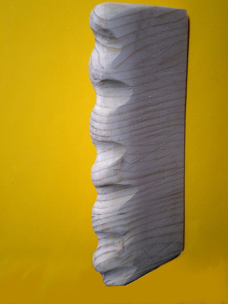

    Let me throw a curve ball at you fellows.
    A long time ago there were some discussions of the shapes that mother nature provided us. One such discussion referred to the shapes of the leading edges of whale fins.
    Here just one reference I found real quick. I'm sure there are more.
    http://newatlas.com/bumpy-whale-fins-set-to-spark-a-revolution-in-aerodynamics/9020/
    What if our centerboards, daggerboards had some sort of scalloped leading edge :?: :D (maybe not as radical as this image)
    .....a few more references....
    https://www.technologyreview.com/s/409710/whale-inspired-wind-turbines/
    https://www.scientificamerican.com/podcast/episode/005E4190-9DE4-32A2-015B43F0702189EA/
    https://en.wikipedia.org/wiki/Tubercle_effect

    I like it Brian. I like it a lot, and probably very tolerant of changes in angle.
    I've seen this before, interesting concept, could be just the ticket, going to make fabrication interesting.
    Im thinking you would not have to go further down than perhaps the top 1/3 - 1/2

    I like it too Brian, an interesting thought, Natures fences?

    Maybe they could help supercavitating foils but at those speeds I'd think smaller or a texture would be better.

    more useful on the rudder as its a more direct analog of the whale fin -- would be a floating trash magnet of course :D
    for the center board, may be switch to a high performance laminar flow foil and add the protuberances with ribblets to make the foil more resistant to stall?

    The issue with tubercles and fences is they will not really be compatible with one of the major benefits of a pivoting centreboard. IE they will serve to create drag and ventilation at all besides one pivot angle.

    Of course movable fences are exempt
    probably more practical to design for 5% forward rake in normal operation condition to suppress ventilation, no fences-ribs whatever, and accept some loss at other settings.
