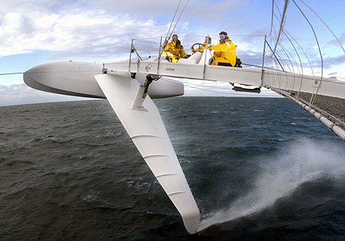

    Hi Brian,
    Without entering into complicated talks about the boundary layer, pressure gradients etc., for practical purposes it is IMO sufficient to know following few facts about the ventilation:
    1) The onset of surface-piercing foil ventilation can be triggered by any water-surface perturbation (waves, aerated water, wake of objects in front of the foil etc.), when the foil is working under a sufficiently high hydrodynamic load (in this case, lift). And, for a given speed, hydrodynamic load is proportional to the AoA.
    2) The onset of ventilation is particularily sensitive to:
    a) loading of the foil area closest to the water surface;
    b) pressure peak immediately behind the leading edge of the foil.
    3) Once the water surface is breached by the air, the air stream propagates downwards along the path connecting of minimum pressure, approximately until the point where the atmospheric air pressure equals the local static pressure on the foil (which can be quite deep).
    Knowing these basics, one can draw some conclusions about ways to minimize the probability of ventilation.
    First, minimize flow perturbations. In practice it means - avoid placing water-piercing objects in front of the centerboard. That's all you can do about it. The other forms of perturbations are out of your control (waves, air bubbles etc.).
    Next, you can decrease the hydro load on the centerboard in the proximity of the water surface. In practice it means decreasing the camber (variable-section centerboard) and/or decreasing AoA (variable twist). From the practical (constructive) point of view, both are a demanding and hardly doable solutions, and I am mentioning them for the sake of completeness.
    Third, you can decrease the pressure peak by adopting foil sections with the point of max. camber and thickness placed more towards the trailing edge. NACA laminar sections (6-series or 7-series) could be a good place to look, for example.
    Fourth, increase the depth (span) of the centerboard. This increases the probability that deeper parts of the foil will remain washed by a clean flow even when the more superficial ones are ventilated. The drawback is an increased root-bending moment, which requires heavier, bulkier and more costly centerboard scantling.
    Finally, impede the propagation of the air stream downwards along the span. It is done by placing one or more fences (plates) along the span of the foil.
    A single fence is used when the water surface is at a known fixed height. This is not your case, since wave motion can be significant in between the two demi-hulls of the cat, so you actually don't know at what point along the span will the foil pierce the water surface at a given moment.
    For that reason, a series of fences is IMO a better option. The first one should be placed some 10 cm below the still water line, and a couple of additional ones should be added down to the lowest expected water level along the centerboard span. Since the ventilation propagates along the suction side of the foil, it is sufficient to place them on the outer side of each of yor centerboards. In this way, there will be no mechanical interferences between centerboards.
    As an example of multiple anti-ventilation fences, see the hydrofoil of Hydroptere:
    This is IMO probably the most effective and simplest thing you can do to minimize the ventilation on your centerboard. In this CFD work you can visually appreciate the difference in ventilation levels between a clean foil and the one one with a series of fences: https://bib.irb.hr/datoteka/837663.Sorta2016-ventilation.pdf
    Hope it helps.
