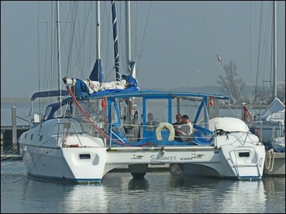

    That solution looks much lighter, simpler, cheaper and easier to build than 2 boards plus cases and the extra interior room would be nice.
    Can we say the myth is busted that the bridgedeck centerboard does not work? Its simply untrue and just has pros and cons like everything.

    Nobody said "the bridgedeck centerboard does not work."
    They just said its inefficient compared with through hull daggers, or LAR keels.
    Any surface piercing blade providing sideways resistance will have pressure on its leeway resisting side which will produce a surface wave and turbulence, which in turn means DRAG.:(.
    The extra complication and weight of the means to support it, against the conderable sideways force it needs to exert to do the job, helps make it inefficient.

    Quantifying it is beyond me, but it's pretty clear experimentally that two boards and the associated drag are still better than a single larger board. For proof see the entire A-Class Catamaran fleet prior to the introduction of C boards. Despite a fully open development class, where a center board would have been perfectly legal, no one adopted a surface piercing centerboard.
    You find the same result if you look at the C-Class, and the Formula 40 Cats.
    Experimental data from a number of very innovative classes with a lot of money and development tossed at them, and everyone selected twin daggerboard in the hull.

    You don't have to sell me on the fact that twin daggers in the hulls are more efficient,...I agree
    But when you consider all of the other benefits of the 'central board(s)', no hull penetrations, etc, concept for cruising boats, I think the alternatives weight in significantly for alternatives.
