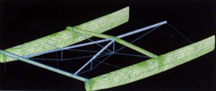

    What if this solid plate in the dwg was my flat plate nacelle down the centerline of the catamaran, and the two boards (one raised, one down) were the twin asymmetric boards as I have suggested.
    Now what if those twin boards were 'modified a bit' (extended) into up-tip foils. :idea:
    That just might work on a light-weight cat :cool:;)

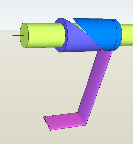

  7. UpOnStands
    Joined: Nov 2015
    Posts: 681
    Likes: 15, Points: 18, Legacy Rep: 16
    Location: Sydney
    UpOnStands Senior Member

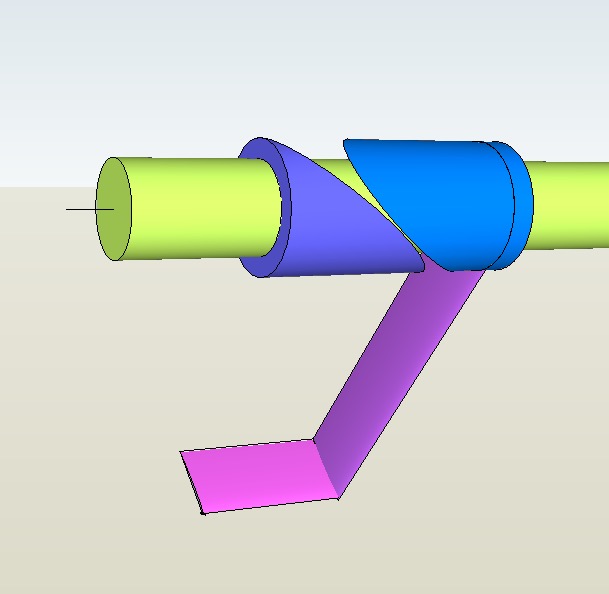

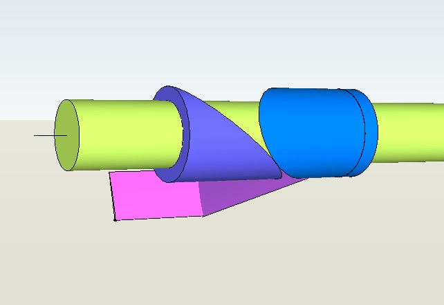

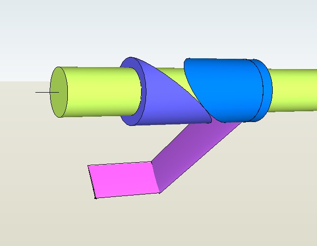

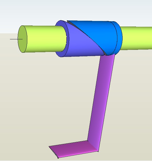

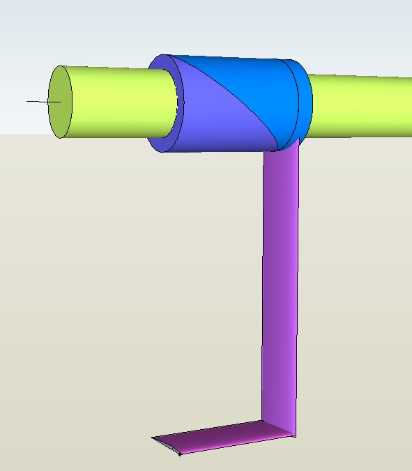

    if you want kickup foilers here is one idea
    these show the forward beam of the bridgedeck -- CRP pipe 40 cm diameter.
    boat is moving from left to right and only starboard foil is shown.
    The horizontal foil lies partly under the starboard hull - when it kicks back and up the cam forces the foil inboard clearing the inboard side of starboard hull.
    There is a mechanical trip that holds the board carrier in position.
    Each foil itself is 80 cm long with 40 cm chord
    The foils are rotated forward when not in use
    The demi-hulls are basically lengthened Woods Gypsy with flat bottoms, no keel.
    There is a third foil on the aft cross beam to balance the front 2. It also trips but just straight back.

  13. UpOnStands
    Joined: Nov 2015
    Posts: 681
    Location: Sydney
    brian, suggest you build your longitudinal beam with say four 10 mm dia holes for the thru bolt spaced fore-aft over a distance of 1 m to allow the sweet balance spot to be found on the water. Once found, you can then glass the pivot pin permanently into position. and the thru bolt then only has to restrain movement of the boards. Certainly impossible to do with dagger boards.
