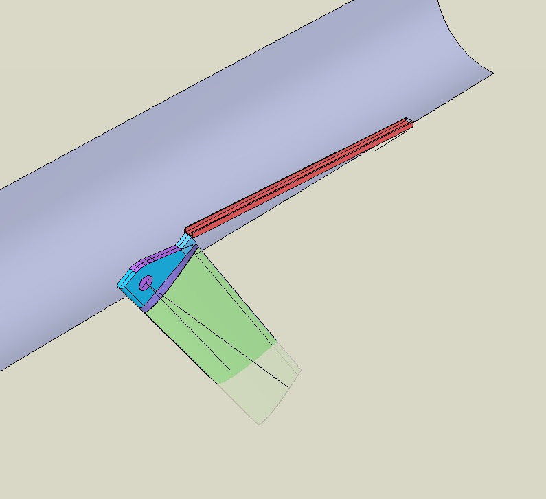

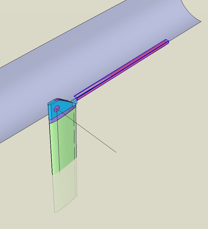

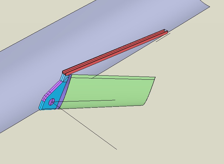

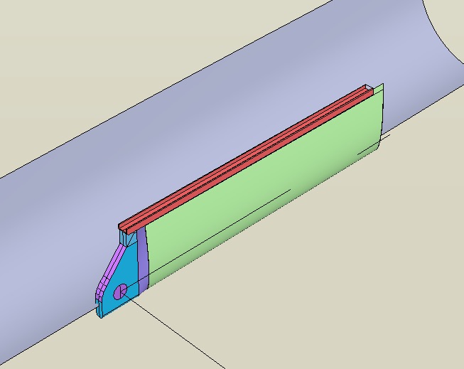

  8. UpOnStands
    Joined: Nov 2015
    Posts: 681
    Location: Sydney
    UpOnStands Senior Member
    how's this? the brown stuff is not the water level :D
    the red sealing strip is hinged to the back edge of the board and is wider than the slot opening
  9. brian eiland
    Joined: Jun 2002
    Posts: 4,962
    brian eiland Senior Member
    Is that meant to be a hull mounted CB?
    And if the 'closing strip' is "wider than the slot opening", how does it ever get up into the slot with the board in its up position?
  10. UpOnStands
    Joined: Nov 2015
    Posts: 681
    Location: Sydney
    the closing strip works only when the board is down.
    basically when the board is up its front face projects slightly below the bottom of the hull which provides sealing of about 70%. Fore and aft of the board there are matching skegs, not an LAR but more of a beaching strip.

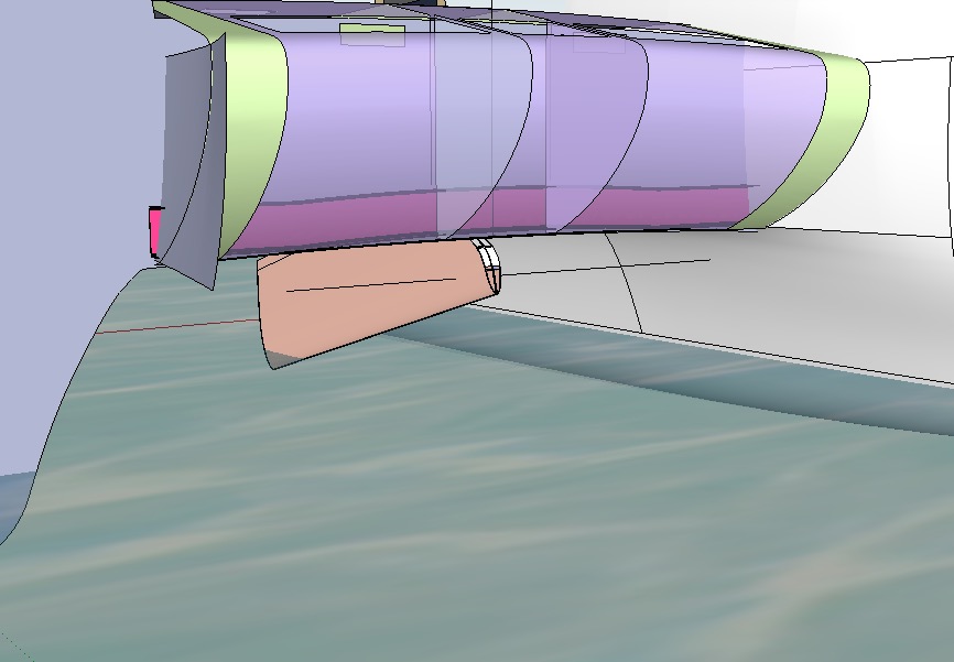

  14. UpOnStands
    Joined: Nov 2015
    Posts: 681
    Location: Sydney
    For general comment.
    To minimize intrusion of the centerboard into the bridge deck, how negative would it be to trail the board as shown here?
    The board (orange) is in the up position -- no support structure shown.
    Getting a little more interested in the idea -- but.
