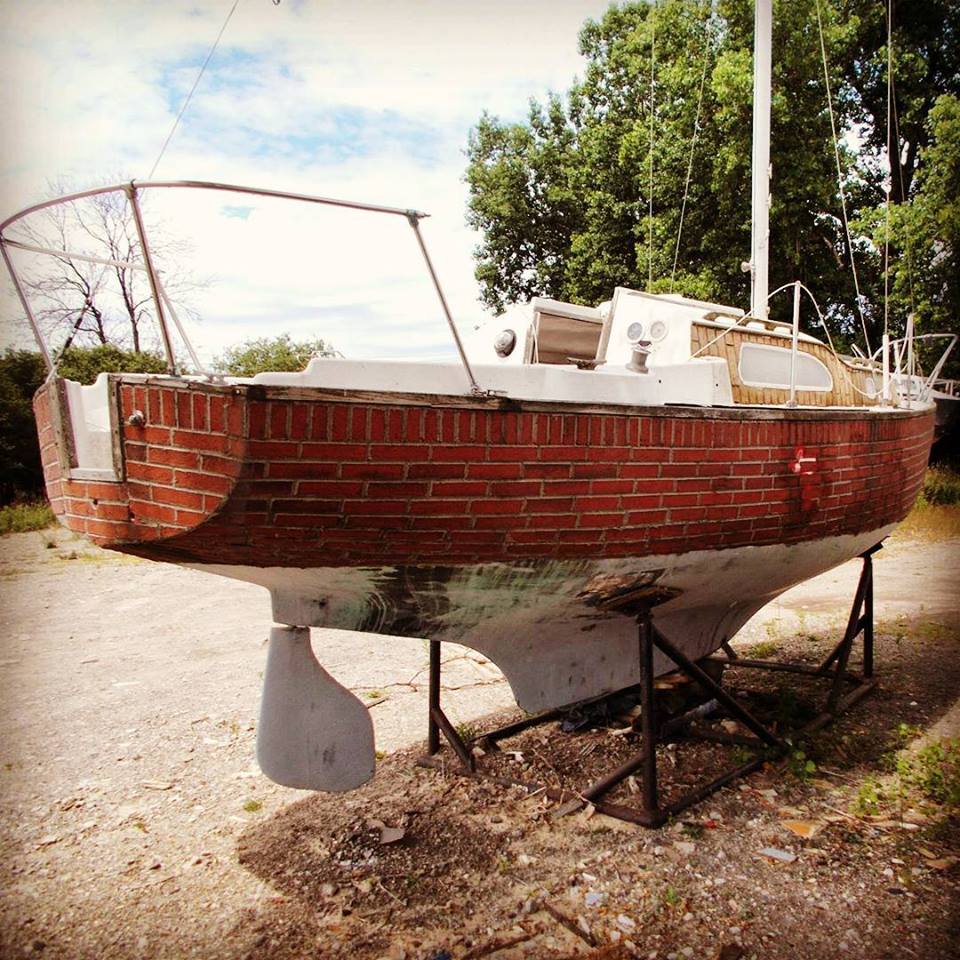

    Few minutes ago , I found an brick mortar built boat picture at facebook discussions. Located in Buffalo New York Seven Seas marina.
    NOW , This is big , very big thing. Ferrocement construction and steel rods are still very expensive for me. But high quality concrete or earth bricks are extremelly cheap.
    Please , laugh if you want but lets discuss the strenght of the method. Please keep thread technical.

    I spent my whole life understanding bricks to be porous.
    The mortar here starts to fail and doesn’t withstand freeze/thaw.

    Are you sure that the sides are built with bricks, or is it a decorative exterior layer? .

    TANSL I checked the facebook and they are talking about wall paper covering but I cant confirm.

    The pictured boat is not really built of bricks. And there is no technical solution to build a boat out of bricks.

    post #1 picture . . .
    I'm afraid someone has misunderstood ‘‘Brick Slips’’ for ‘‘Brick Ships’’, but then since the Brick Slips were already ordered, has glued them onto an old GRP hull to have a decorative Brick Ship anyway . . :)

    If you have to ask why not brick construction (veneer or otherwise), then the best advise you can receive is continuing your education in engineering, as there are several mostly obvious reasons, this can't work on a boat.
    FWIW, veneers (slips) are more expensive than regular bricks, by a fair margin. In the above image, it's being applied with construction adhesive, over a preformed lath, which has raised ridges for the veneer placement. This is why there's no "story board" at the corners to keep the courses straight. It costs a lot more to apply a brick surface this way. You save a small amount in labor, but lose a lot in materials. Lastly, one of the best benefits about a real brick facade is the thermal mass it provides the exterior walls, which you get little of with a veneer wall, though admittedly the insulated, poured concrete walls on the job above, will do very well in this regard.
