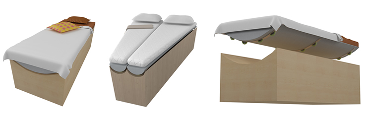

If it is to hard too gimbal the working space of the whole vessel. Perhaps individually gimballed elements of that space would be a good compromise.
halbkardanische Koje | kardanische Schiffskoje | gimbal bunk | gimbunk http://www.gimbunk.com/
The concept is simple. And can be refined by adding a second axis.
Those look like huge consumers of valuable onboard space. AFAIK, hammocks still work; you just have to learn how to get in and out of them.
I like the simple idea of hammock chairs and beds! But wouldn't occupied hammocks have a pulsing feel with at least some of the wave disturbances, or is there some kind of damper (springs?) effect that keeps them steady? Just thinking there might be a noticeable inertia effect depending on the amplitude and frequency of waves that causes a temporary and repeated change of boat speed and direction plus elevation? Maybe the inertia effect would be small and unnoticeable... And I guess the inertia Factor might also also be a consideration for the other approaches, like suspension or gimbals? Hammocks maybe not equal to the motion smoothness of a swath or hydrofoil, which are more or less decoupled from waves?
I agree with portacruise in that hammocks chairs and gimbal beds don't really satisfy the design brief. First, You can't cook, go to the bathroom, walk around, etc in a hammock or bed. And we've tried hammocks on a moving boat and at times it swings around dangerously and is even more uncomfortable. Even if the hab space was on gimbals, you haven't decoupled from heave. I think that up and down, weightless feeling, contributes a lot to sea sickness. So without decoupling from heave, you have only solved half to design brief.
