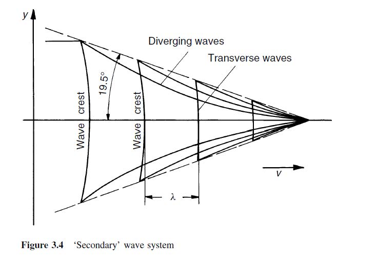

    I suspect I'm on a 2+2=5 with this, but if wake leaves a boat at angle of around 19 degrees does it help to have a bow angle smaller than this so that the wake doesn't run along the hull?

    It doesn't have to be "hull shape". Any pressure field that is moving has the same effect and same classic Kelvin wave pattern.

    That's why I was thinking that if the bow angle was less than 19 degrees the wake might diverge from the hull. If the hull angle was greater the wake would not diverge from the hull and would rub along the hull increasing drag. So maybe this is a critical bow angle, below which there is a step change reduction in drag?

    No.
    It can be a single point, and has the same kelvin wave pattern. There was a hull desigmed and made in the late 1800s with such a hull shape, extremely fine.....I can't recall its name name, but can dig it out for you, if you're interested. Didn't work.
    Reduction of drag is a different matter. That is influence far more by the length displacement ratio.

    A more accurate representation of the Kelvin wake is shown in the attached
    graphic from Newman's "Marine Hydrodynamics".
    Note how the Kelvin angle is defined. It is not, as depicted incorrectly in Ad
    Hoc's graphic and many other places, the line through the intersection of
    the crests of the transverse and diverging wave systems.

    "Principle of Naval Architecture", Tupper&Rawson's "Basic Ship Theory" and Molland's "Maritime Engineering Reference Book" define it just like shown in Ad Hoc's picture...
    So you say that it is mathematically defined as an angle to the line connecting intersections of divergent waves and their tangents set at an angle of 35°16' to the centreline? But why, for God sake???

    You need to go through the relatively simple derivation, but the mathematics does work out exactly.
    See:
    http://www.wikiwaves.org/
    and especially:
    http://www.wikiwaves.org/Ship_Kelvin_Wake
    The Kelvin angle is equal to arctan(1/(2^1.5)) = 19.47122... degrees,
    which occurs when the wave angle theta is equal to
    theta = arcsin(1/sqrt(3)) = 35.264... degrees.
    The situation is a bit more complicated in finite depth water.
    The incorrect graphs seem impossible to eradicate. It's like the myth of flowing glass windowpanes :)

    Let's say that we defined the Kelvin angle as in the "wrong" illustrations, the one given by AH. Do you know perhaps what would be it's value, according to that definition?

    I don't know if there is a precise simple formula as for the Kelvin angle and
    the wave angle (theta_K) at which it occurs.
    The correct definitions are not that complicated, and are very useful
    because they allows us to separate wave resistance due to the transverse
    wave system and the diverging wave system.
    Transverse waves are those for -theta_K < theta < theta_K
    Diverging waves are those with |theta| > theta_K.
    The "incorrect" angle would not allow such an easy distinction.
    It is also possible to derive that waves along the cusp line (theta = theta_K)
    decay like 1/cuberoot(x) and hence they persist downstream for much
    longer than transverse waves, which decay like 1/sqrt(x).
    Waves along the line at the "incorrect angle" would decay like 1/sqrt(x)
    because they are inside the cusp line.

    Not according to all my reference books:
    Again, according to these reference books, it can be shown to be 35.267 degrees mathematically by superposition of parallel systems of wave crests. With the cusp line making an angle arcsin (1/3) = 19.47 degrees.

    Yes, the diagrams in your old references, and many others are incorrect and
    misleading.
    Now that I see what they are calculating I concede that they give the correct angles. But their diagrams are wrong.
    You can tell Whittaker he forgot about the phase shift. :)
    Newman is correct, and the diagram was reproduced in
    Faltinsen's "Hydrodynamics of High-Speed Marine Vehicles".
    Here's some evidence that there are many textbooks and
    papers with the wrong format.
    From an article by L. J. Doctors in the Australian Naval
    Architect, Vol. 6, No. 3, Nov. 2002, p 26.
