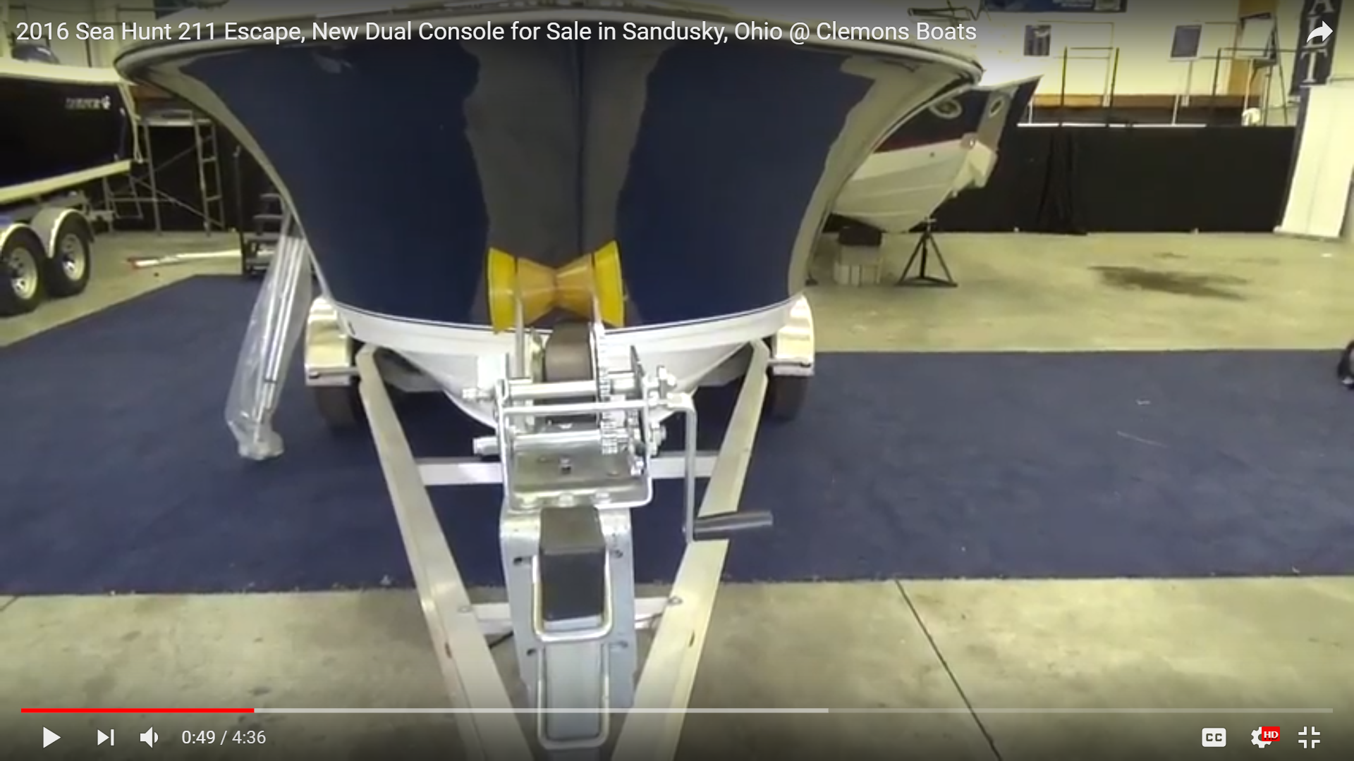

    Thanks for the video on dead rise. I need to know what angle of entry or dead rise angle at the forward end of the water line on an 18 to 19 foot boat with a 150 HP outboard will tend to cut through 2 foot seas instead of rising with the wave and then come crashing down.
    I am told the deep V hull design of a 186 (18.5 feet) DC Sea Hunt Escape has an "angle of entry" or dead rise at the bow of 50 degrees or so. When facing the bow of the boat the sides have a very sharp angle from the gunnels to the keel or center line of the bow. See photo attached. What I need to know is how shallow a dead rise at the bow will still cut through the waves? 50 degrees works but how will 40 or 30 degrees dead rise at the bow handle 2 foot seas?
    Just found a front photo of the bow. This boat has a Carolina flair with dead rise of 55 at the bow, 21 mid ship and 16 at the stern. My guess is this boat will cut through 2 foot seas well.

    Your question leads to 2 possible replies.
    1) 2 foot seas - cut through...in terms of slamming
    2) 2 foot seas...in terms of seakeeping
    In either case, 2 foot seas are small, except if the boat is small. .....in terms of 1 + 2, speed plays more of an important role in this behaviour.
    The angle of entry is defined by the type of boat you have anyway. A supertanker of 200,000 tonnes doing 10 knots will have a very different angle of entry to a 15foot 40knots RIB.
    Other than - nice to know -..what is your objective?

    Thanks everyone for your comments. I just found what I am looking for and am posting what I found to help others with the same question on seaworthiness.
    I discovered a comparison between a Tidewater and a Sea Hunt boat, both 21 feet long. What makes the Sea Hunt cut through rougher seas is an entry angle or dead rise of 55 degrees at the bow, 21 mid ship and 16 at the stern. The pronounced Carolina flair at the bow and the dead rise taper back to the mid ship, behind the driver and provides for a much dryer ride. The 16 degree dead rise at the stern provides a much more stable ride because the boat doesn't rock side to side as much if the transom dead rise were greater. The Sea Hunt also had much greater freeboard than the Tidewater.
    The Tidewater only had a 40 degree angle of entry or dead rise at the bow and a less pronounced flair, both of which didn't extend past the drivers seat. The Tidewater also didn't have as much freeboard as the Sea Hunt and tended to rock more than the Sea Hunt. As the owner said, the Tidewater was a great boat but just didn't handle rougher seas.
    The owner traded in his Tidewater for the Sea Hunt because he wanted to venture out about 5 miles off the coats and he found the Tidewater didn't work as well as the Sea Hunt in the rougher seas commonly found that far out to sea.
    Thanks. I hope this post helps others get their questions on entry angle and the ability to cut through rough seas answered.

    If the forefoot is in the water, which it often is, a 55 degree deadrise forward section is more likely to "root" than a flatter section. The slang expression "root' means that the boat will snap its bow one way or the other in response to quartering waves or wakes. That is a disconcerting characteristic. The flatter the section the more likely that the bow will pound. Also rather disconcerting.
    It is fair to say that adequate seamanship is as much a factor as the shape of forward sections.
