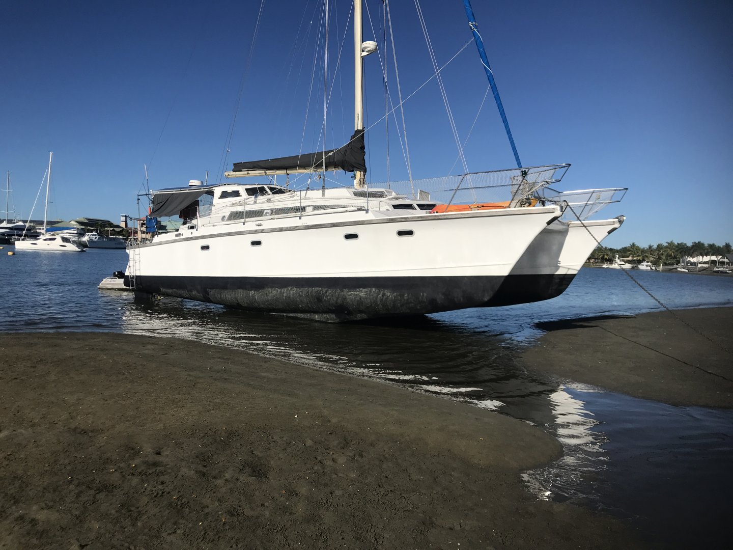

    Hi everyone, I'm just looking for some feedback on whether if extending the Bows and sterns on my 16m( 5.7m wide) Solaris cat would be a worth while project?

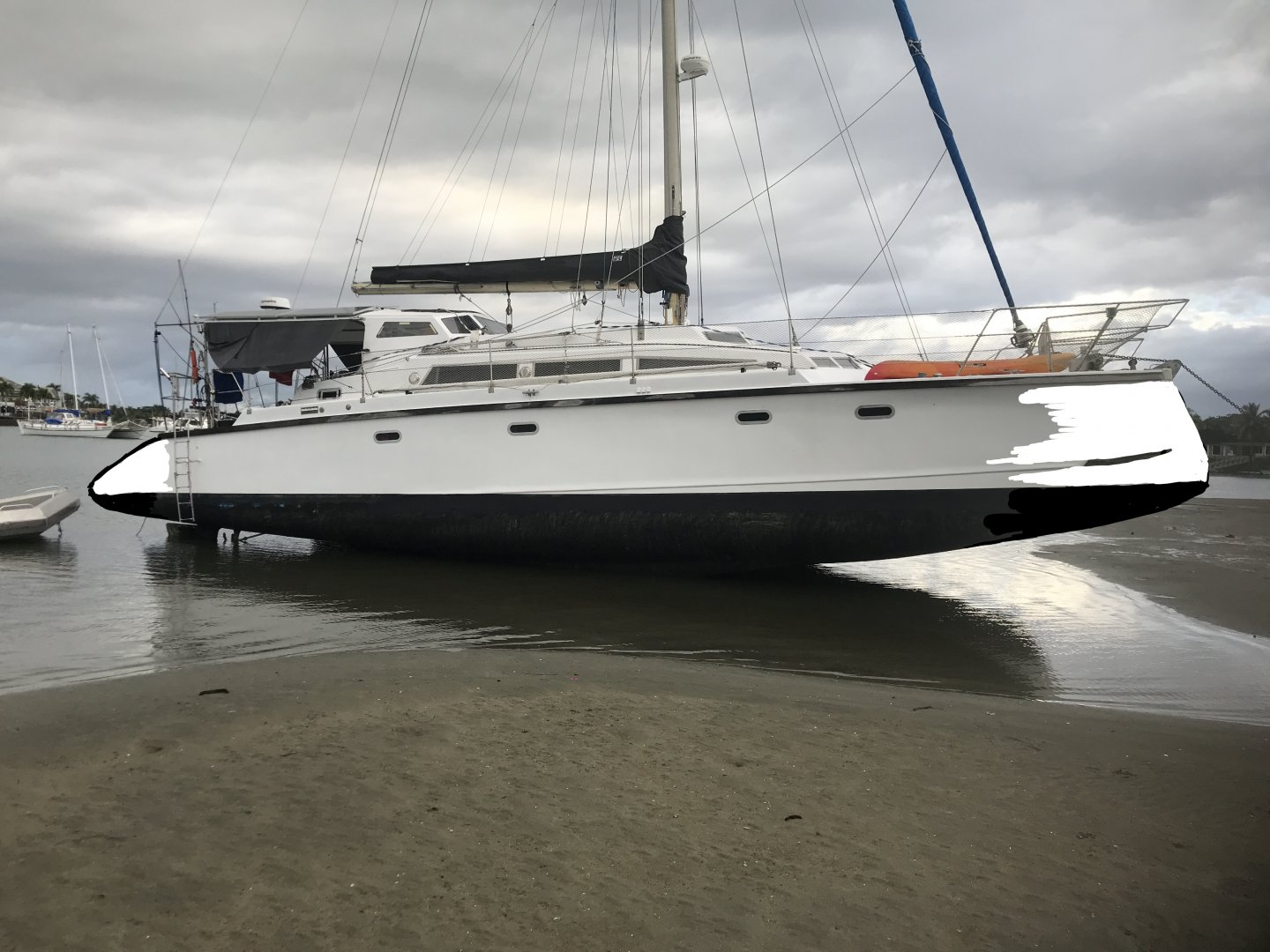

    The boat sails fine ( 5 to 6 knts in lighter winds around 15knts) at the moment but it would be great to get a little more speed (the sterns dig a little deep at low speed) and easier access to the water while under way. I've attached a rough before and after sketch to give an idea of what I'm thinking.
    There's also and idea of moving the backstay. Splitting it to attach to the outside corners of the existing sterns.
    The boat weighs in at around 20 tonnes so the thought is to get a little more water line length.
    Thanks, Mike

    In a nutshell - this would be a very big, complicated and expensive project.
    If you are not sentimentally attached to your Solaris, it might be easier to sell her, and look for a slightly longer and leaner cat?
    But if your heart is set on this, have a look at this article by Eric Sponberg re modifications that he designed for the bow of a Freedom class sailing yacht, to give her a bit more buoyancy up forward. If you want to extend your bow (and stern) this article should offer good initial guidance.

    Go for it, in fact I would go longer at the back.

    If you feel the thing is bogging down at the stern, and it doesn't "submarine" in a following sea, adding a little at the stern might be the ticket. How much, and how to do, the $64 question.

    Thanks for the feed back! yip as you say a pretty big job. The tricky part is the sentimentality.... how can you not get attached! The other thing is I do appreciate is the solid construction over newer boats and I suppose the price point! So if you threw x at it you might still be well under the price of a newer cat?

    It performs pretty well in a following sea at the moment. only stops bogging down when you start going over 8 or 9knts. I've got photos of her when she was first launched and she sat a lot higher in the water.... so I suppose due to later customised additions and cruising kit this has added a lot more weight to her.
