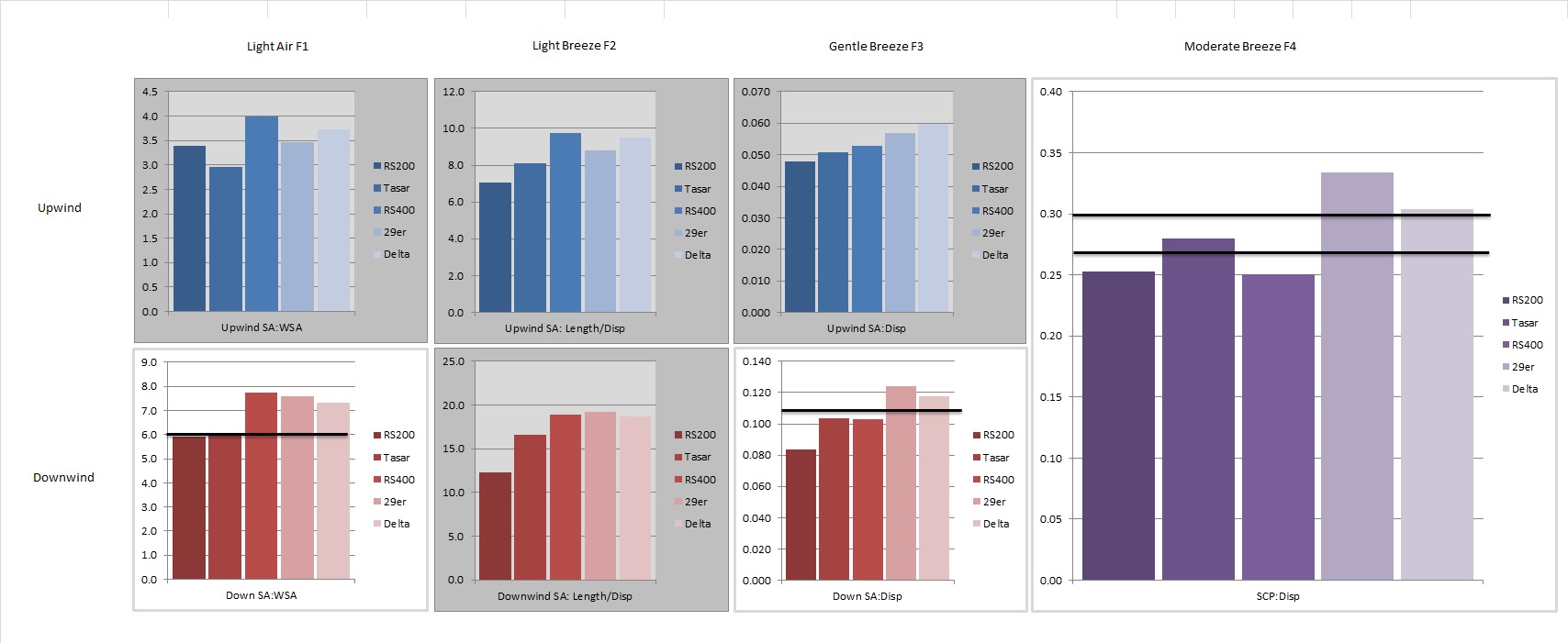

    Peaky Junior Member
    I put this graph together a while back. It is crude, but a reasonable indication, I think. It assumes that performance upwind and down is dominated by a few key ratios. Black lines are the values Bethwaite considered necessary to achieve decent performance, as given in HPS(2?).
  15. sawmaster
    Joined: May 2010
    Posts: 134
    Likes: 2, Points: 18, Legacy Rep: 30
    Location: tyler,tx
    sawmaster Senior Member
    cant get much out of the graph since three of the blues look to be exactly the same color on my computer as does three of the purples and three of the reds---so cant read the legends
