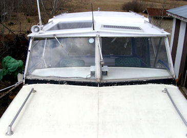

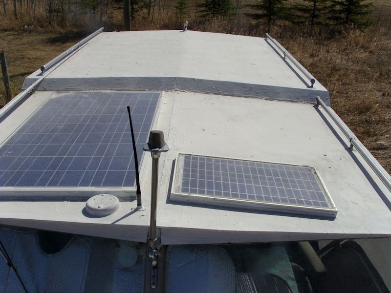

    About 10 years ago I refitted my 1966 Lonestar and added a hardtop over the wheelhouse and the after deck to provide weather protection and shade. The roof takes a step up between the wheelhouse and the after deck. At the time I couldn't figure out what material to use for the roof sheeting that would be 1) maintenance-free 2) have a long life 3) be lightweight 4) not heat up the interior and 5) not brake the bank. Since the refit left my bank account empty at the time, I used 1/4" plywood and the best white paint I had.
    The time has come to replace or repair the roof.
    There are a lot of different materials available now but every manufacturer claims theirs is the best but most of them give no long-term test results.
    Short of adhering sheet metal over the existing roof, what would you recommend to meet the above requirements?

    I am unsure of what the problem is.
    Is there cosmetic paint degradation?
    Is the roof failing structurally?
    If so is it systemic or localised!
    Great pic of windshield. Close ups of problem spots would be helpful.

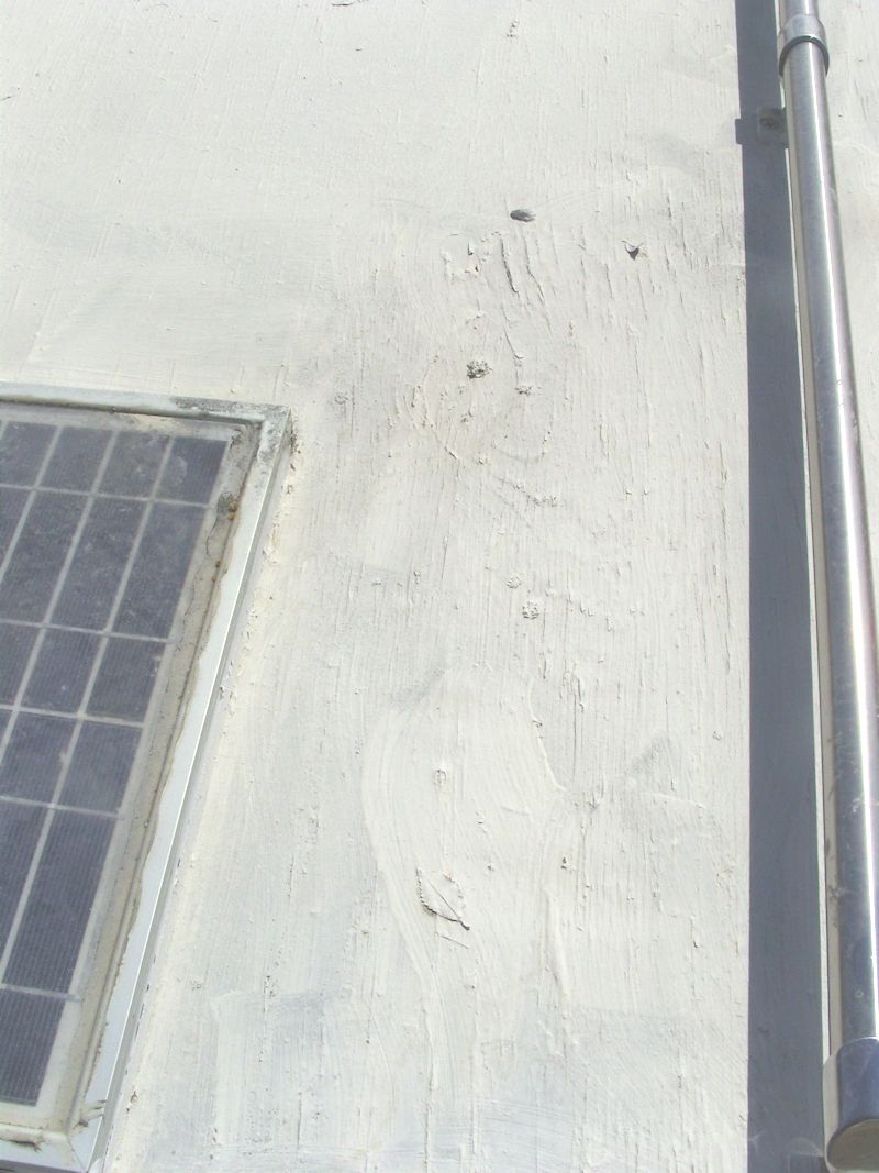

    The plywood has 'checked' in numerous places - it is just regular plywood. One corner is slightly damaged (from being parked too close to a tree).
    I hesitate to do fibreglass over the wood because of the added weight.

    I see lots of cosmetic issues.
    I don't see anything structural, but it might be hidden.
    What does the underside look like?
    Possible close up of tree damage?
    I would assess potential rot sites (along seams, at fasteners, under solar ect).

    It sounds like you used Douglas fir plywood (the stuff the big box stores sell) and this stuff does check, crack and split, if left in the weather, without epoxy encapsulation AND a 'glass sheathing. If the plywood seems in tact, except for some small areas, repair the bad spots, encapsulate with epoxy, including all cutouts, notches, fastener holes, etc., especially the end grain, then sheath (skin) with a minimum of 12 ounces of fabric. If the plywood is really cheap, use two layers of 6 ounce fabric.

    There is no problem with the underside of the roof and/or structure - still looks new. The tree damage was limited to abrasion that exposed the edges of one corner to water causing rot. That section is no more than 12" square and could easily be replaced.
