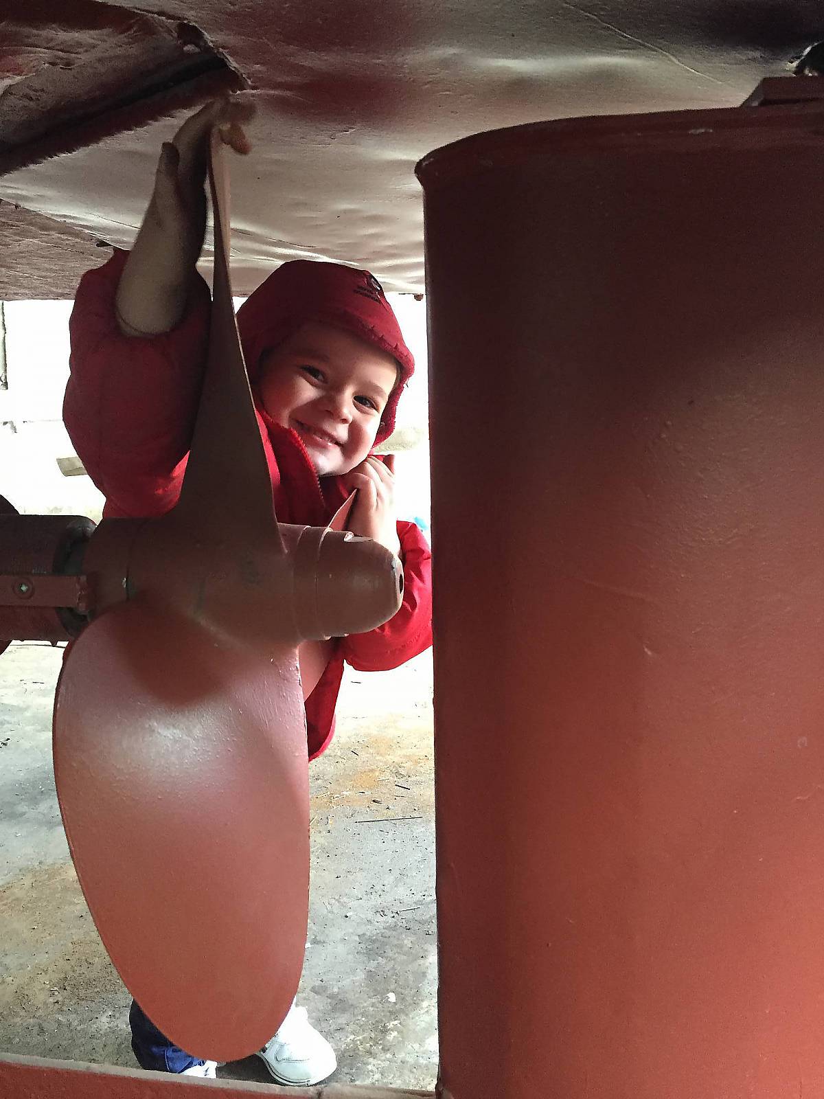

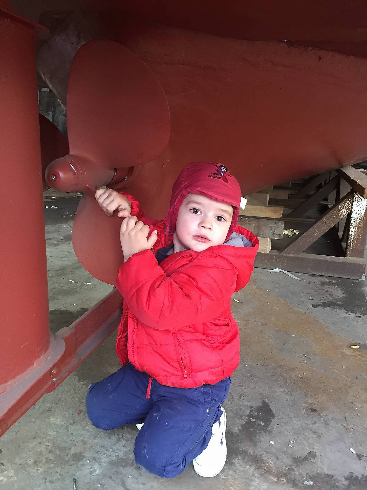

    Attached you can see the propeller.

    Ok Daniel, I see from the building log that the deadwood in front of the propeller is very, did I say VERY!? thick! The propeller is operating in a huge wake, which has a dramatic effect on its performance. I'll do some number twisting and come back later today.
