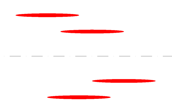

    Leo, what would happen if you took a Weinblum arrangement and then perform the following transformations:
    1) mirror the two hulls along some distant longitudinal axis, in order to create a quadrimaran
    2) shift one of the two semi-arrangements longitudinally by half-wavelength, to make the wavetrains from the two semi-arrangements go out of phase by 180°
    Would the resulting quadrimaran wavetrain be completely canceled out?

    I might be mis-understanding you, but isn't that the same as the diamond tetrahull (or quadrimaran)?

    Oh yes, you're right! A diamond tetrahull is a particular case of the arrangement. I was talking about something like this:
    Just an academic question, since a diamond tetrahull has a seakeeping and a maneuvering advantage related to longitudinal and lateral symmetry.
    Cheers

    It's not an arrangement that gives maximum (theoretical) wave cancellation of the diverging waves.
    The diverging waves made by the inner hull on the starboard side and travelling to starboard will be cancelled
    (in part) by the other hull on that side. But the waves travelling to port will not be cancelled as much.
    Similarly, on the port side, there will be waves that are not being cancelled by the hulls on the starboard side.
    Michlet can be used to investigate these sorts of arrangement. A feature that is not used often is the Free Wave Spectrum.
    Examination of this spectrum shows in which directions most wave energy is being shed by a single hull at a particular
    Froude number. The displacement of the other hulls and their location can then be chosen to cancel waves propagating in
    those directions at certain Froude numbers. (Godzilla can be used to minimise waves propagating over ranges of
    wave angles too, but that doesn't always give insights into why a certain arrangement works better than others).
    Examination of the Free Wave Spectrum for a Weinblum is particularly informative because it shows how the unusual
    wave pattern results from cancellation over certain wave angles and not others.
    (There is an example of a Weinblum bundled with the free version of Michlet).
    See also:
    http://www.cyberiad.net/library/pdf/tl98.pdf
    which shows how to arrange individual hulls to get (close to) maximum cancellation.
    (There is an interesting use of Pascal's triangle for the truly nerdy!)
    Leo.
