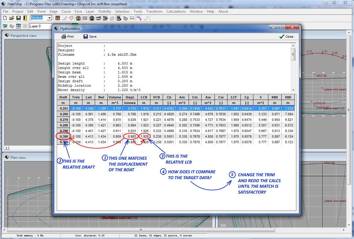

    I am trying to see how the boat sits in the water in a static condition. I have seen terms like static trim, hull orientation, boat attitude and static equilibrium. This is a small 17' boat I am toying around with and am trying to see the effects of the motor weight and the fuel weight on the boats orientation at rest.
  6. daiquiri
    Joined: May 2004
    Posts: 5,373
    Freeship can give you that info, but it is a trial-and-error process.
    First you need to know the target weight and CoG position (measured from the transom) of your boat. It includes the motor and the desired amount of fuel.
    Then you go to the "Calculations" --> "Hydrostatics" menu and specify the trim (in meters) and the range of drafts to be examined.
    Hit the "Calculate" button and Freeship will give you a table of various hull parameters for a given trim and for each draft.
    Note that the trim value is positive when bow points down, negative when it points up.
    In the "Displacement" column, find the cell which contains the value which is closest to the known displacement of your boat.
    Then move one cell to the right and read the relative value of the LCB.
    If the LCB is bigger than CoG, then decrease the trim by some small value and repeat the above calculation.
    After few iterations you will find the trim&draft combination which will correctly match the calculated Displ. and LCB values to your boat's weight and CoG.
    And that's how your boat will sit in the water.
    Hope it helps.

    What does the -0.100 m indicate? Does it mean that the stern is 0.100 m down and the bow 0.100 m up?

    Thanks, is that measured at the waterline (which would change) or LOA?
