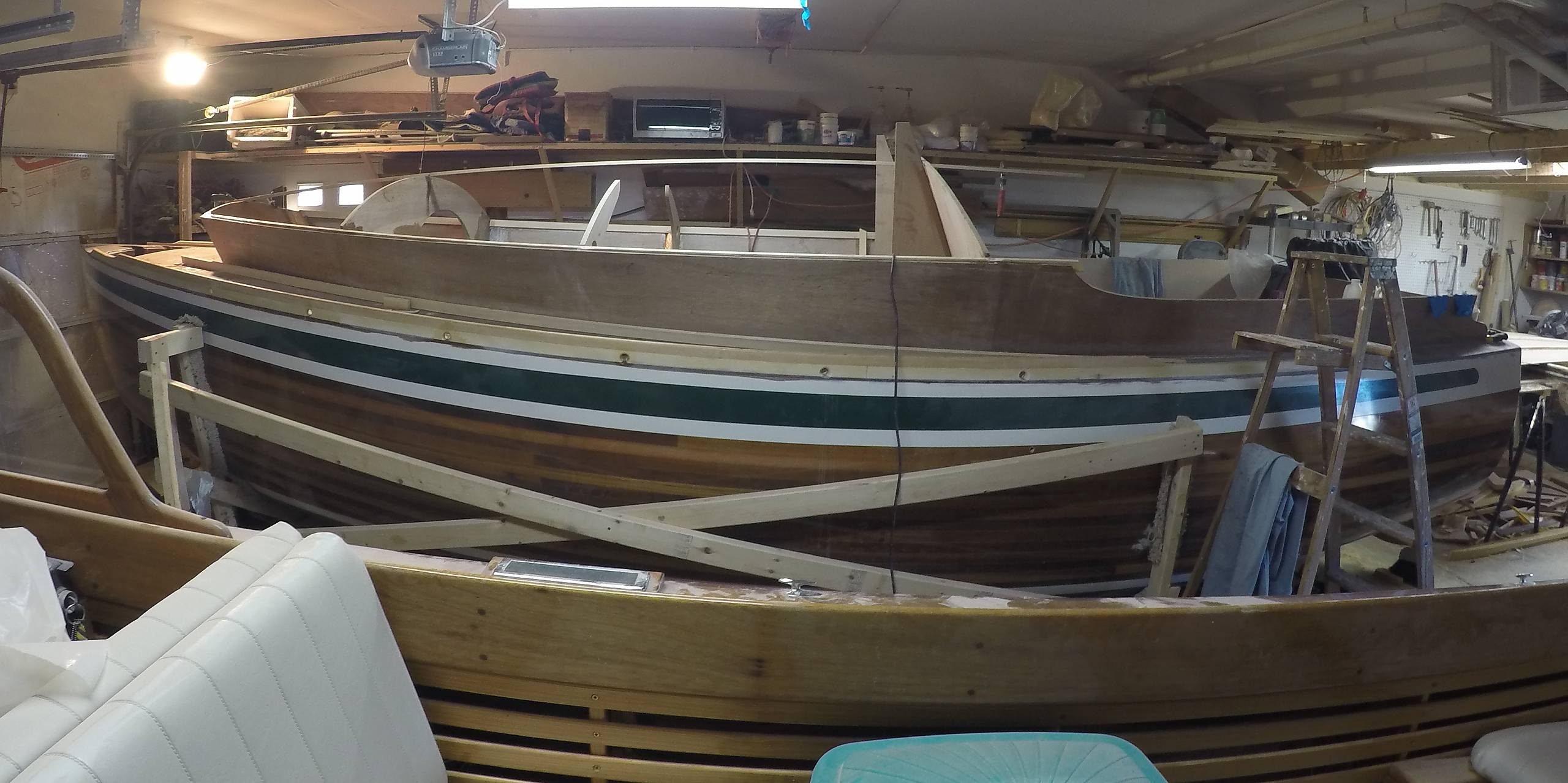

    Just an excuse to post a picture.
    The port cabin side went on without a hitch. Lots of goop and screws. Putting on the big pieces really gets the excitement going. I've shaped the monolithic piece I had saved for the aft coaming into something more attractive and functional. I'll save the picture until it's really installed. The decks are now all laminated and I've gone in and added the scuppers to the toe rails. Six per side. Maybe overkill, but holes are cheap I was able to do this without any difficulties as all fastener locations were marked and scupper locations were laid out accordingly.
    I've also laminated the aft coaming and forward cabin panels with 6 oz. cloth.
    The next few days should see significant structure additions. :cool:

    Upper Structure Tour
    I've been getting a lot of pieces installed over the few days. Some pieces have been cut for a while and others are freshly cut. Some are both.

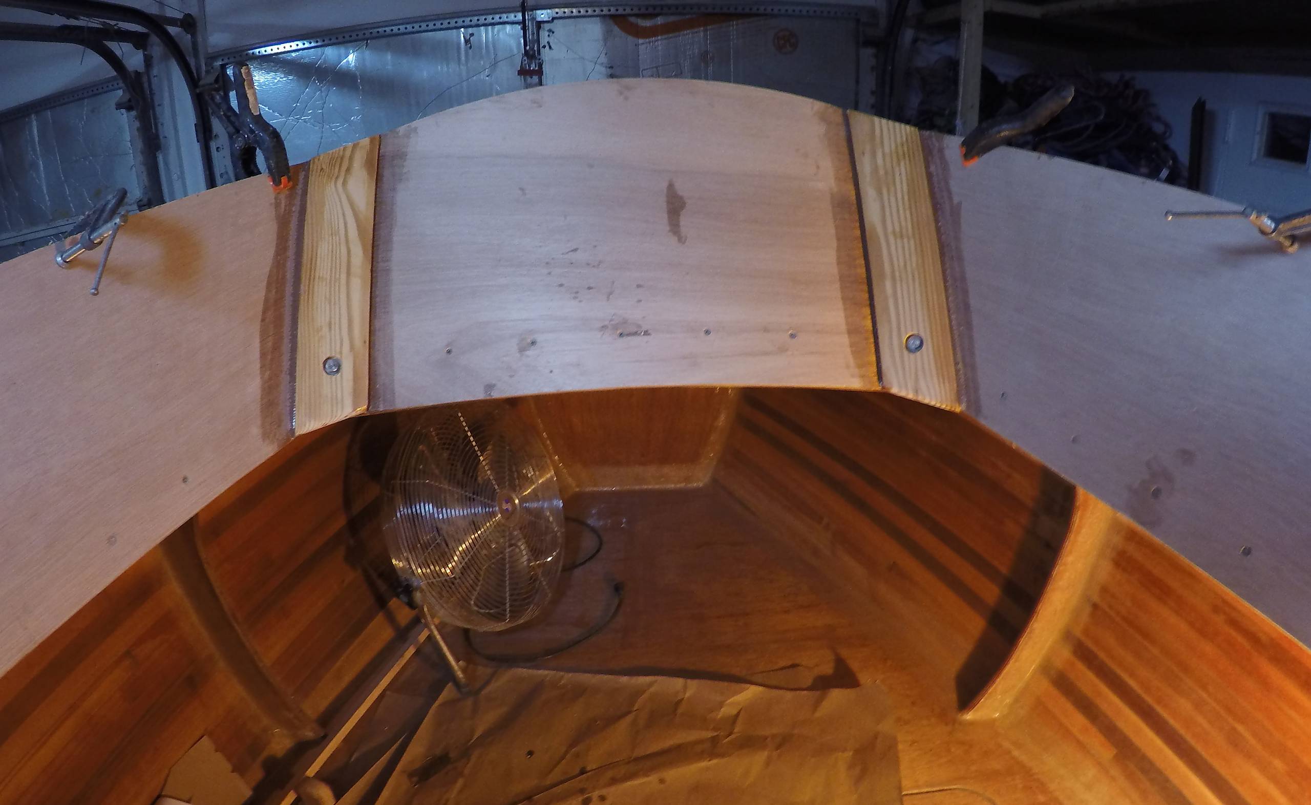

    The forward deck house bulkhead. There is the temptation to double up the corner structure with a triax wrap around the corner post. The way these posts are cut, there is plenty of faying surface for the epoxy to work on. Those are 3/8" x 5" SS lags in the bottoms of the corner posts.

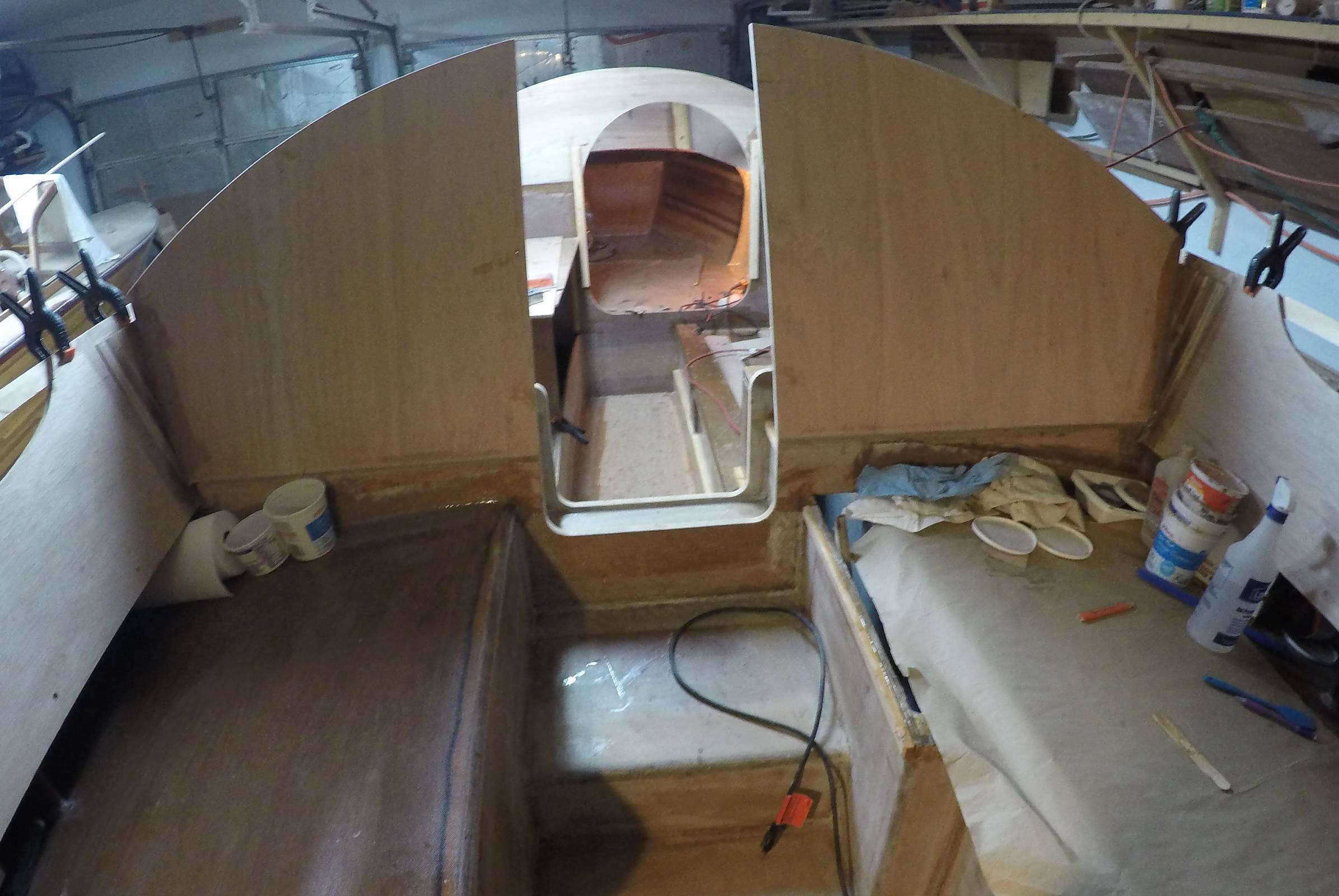

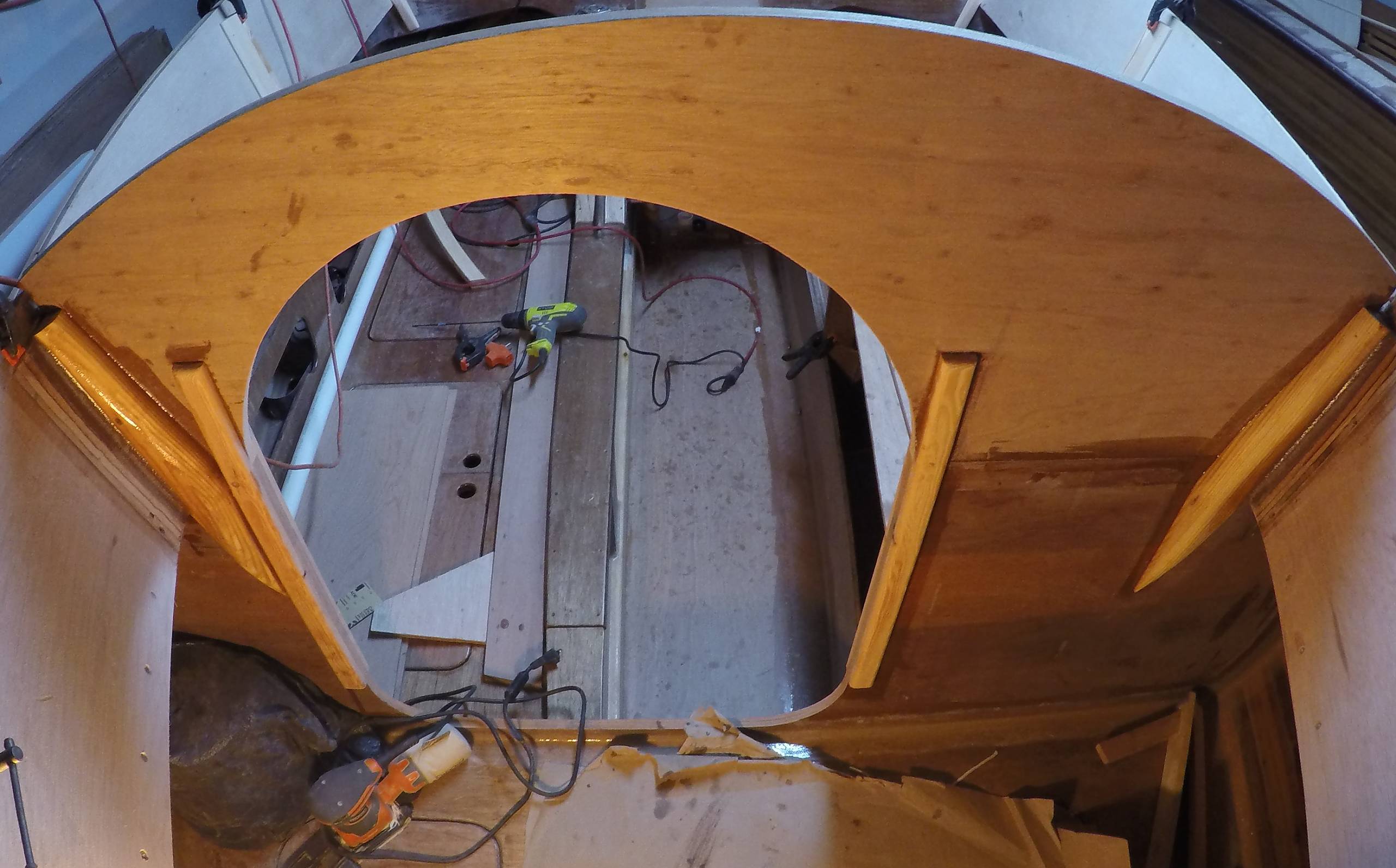

    Forward side V-berth bulkhead. The panels are simply butted together and glued. The vertical members are shear ties to carry loads down to the lower panels that solidly attached to the hull. I decided to enlarge the V-berth access for multiple reasons. I was originally smaller for more privacy, but practicality prevails. Better access means less chance of disturbing my better half when getting in and out. I can now sit in the V-berth, put both feet on the floor and brew coffee without getting completely out of the berth. This bulkhead is crazy heavy. 3/4" Meranti. A bigger hole equals less weight. Doing it again, I would go with a thinner panel here. The upper segment is Okoume.

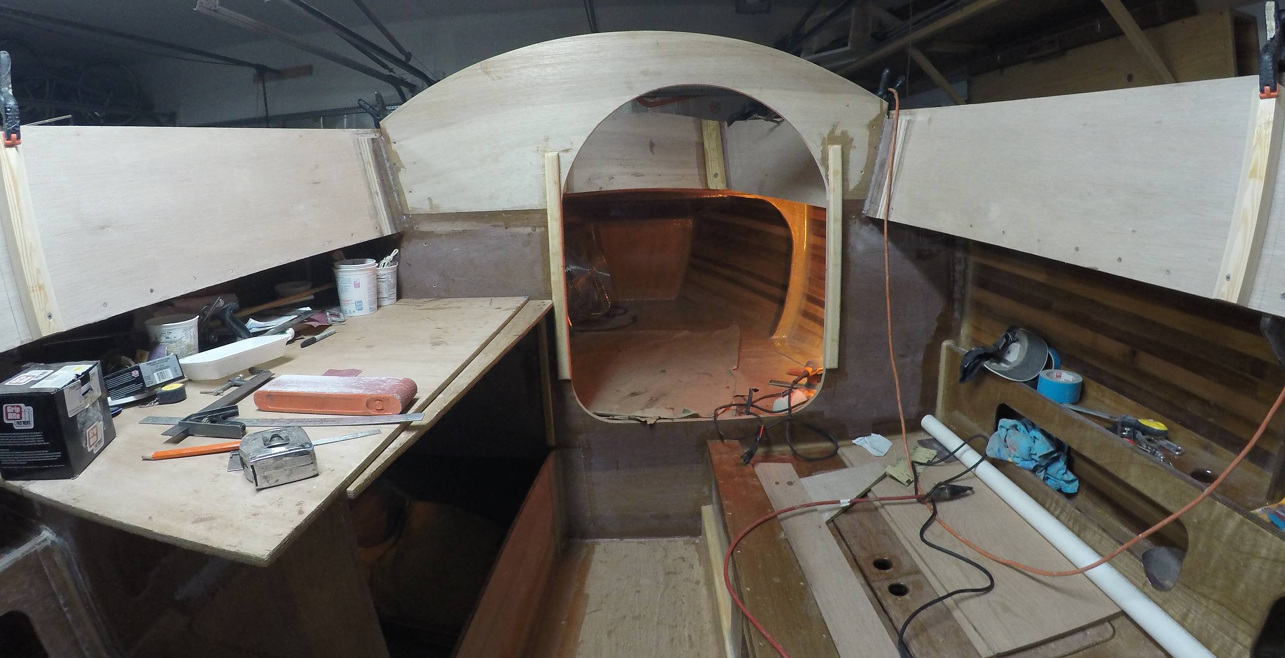

    V-berth bulkhead looking forward. Galley will be to the left. I plan to cut handle above the V-berth access for easier entry.

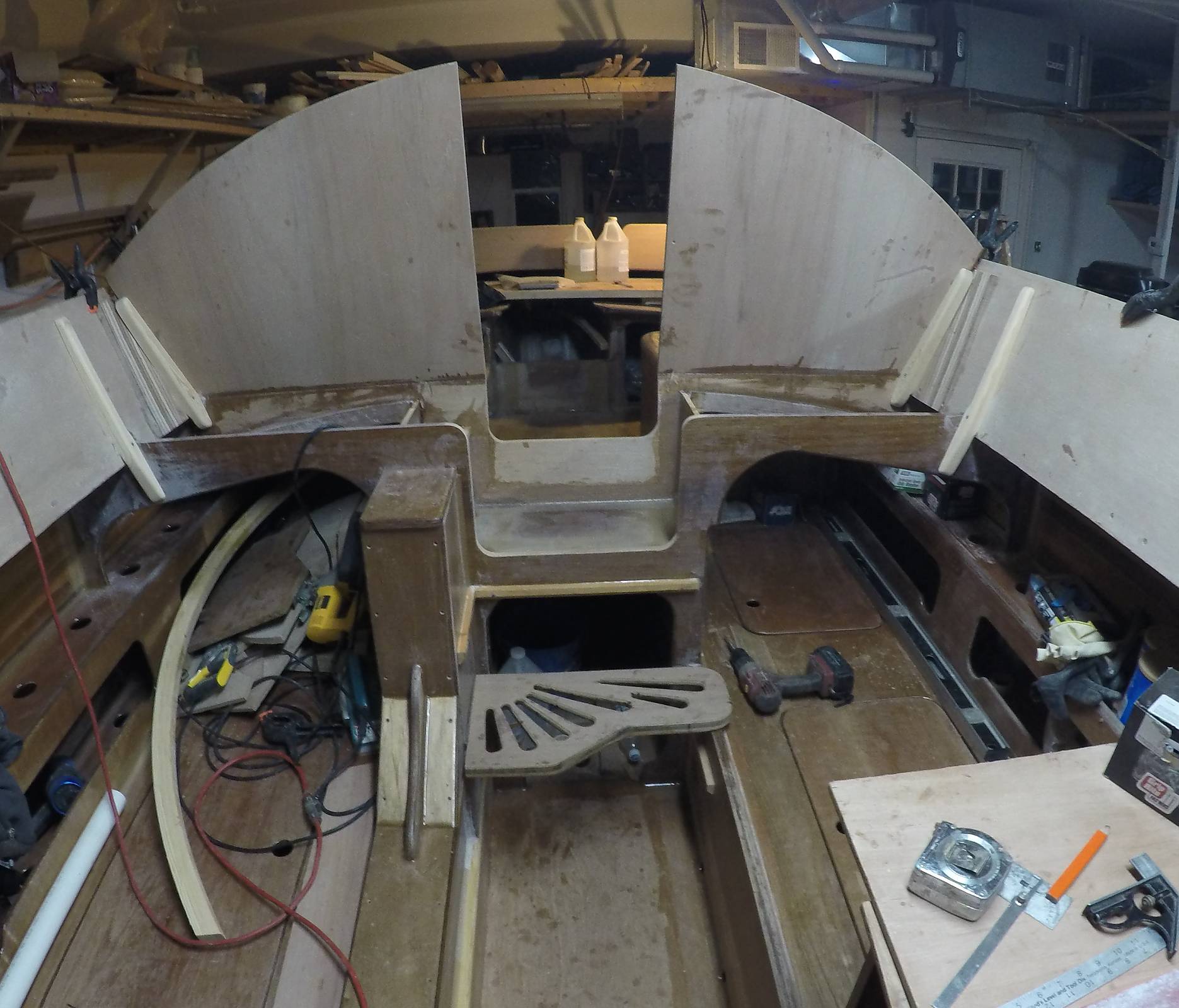

    Companionway, aft cabin bulkheads, etc. The step is a little so I need to lower it some. I believe I can get away with the single step. I notched out the lower companionway opening finally. It's been a real shin knocker up until now. This area is still fairly fluid and will see changes before being called complete. For now, I've simply left the companionway sides vertical. I'm still deciding on the actual positioning and width.
    Companionway from the cockpit. I mis-installed the right hand side and had to cut it loose from the cabin side. I also had to cut through 2/3's of the bottom joint so I could hinge it out 1/2" to get it in it's proper position. Measure twice, glue once, right?:rolleyes: All fixed now.

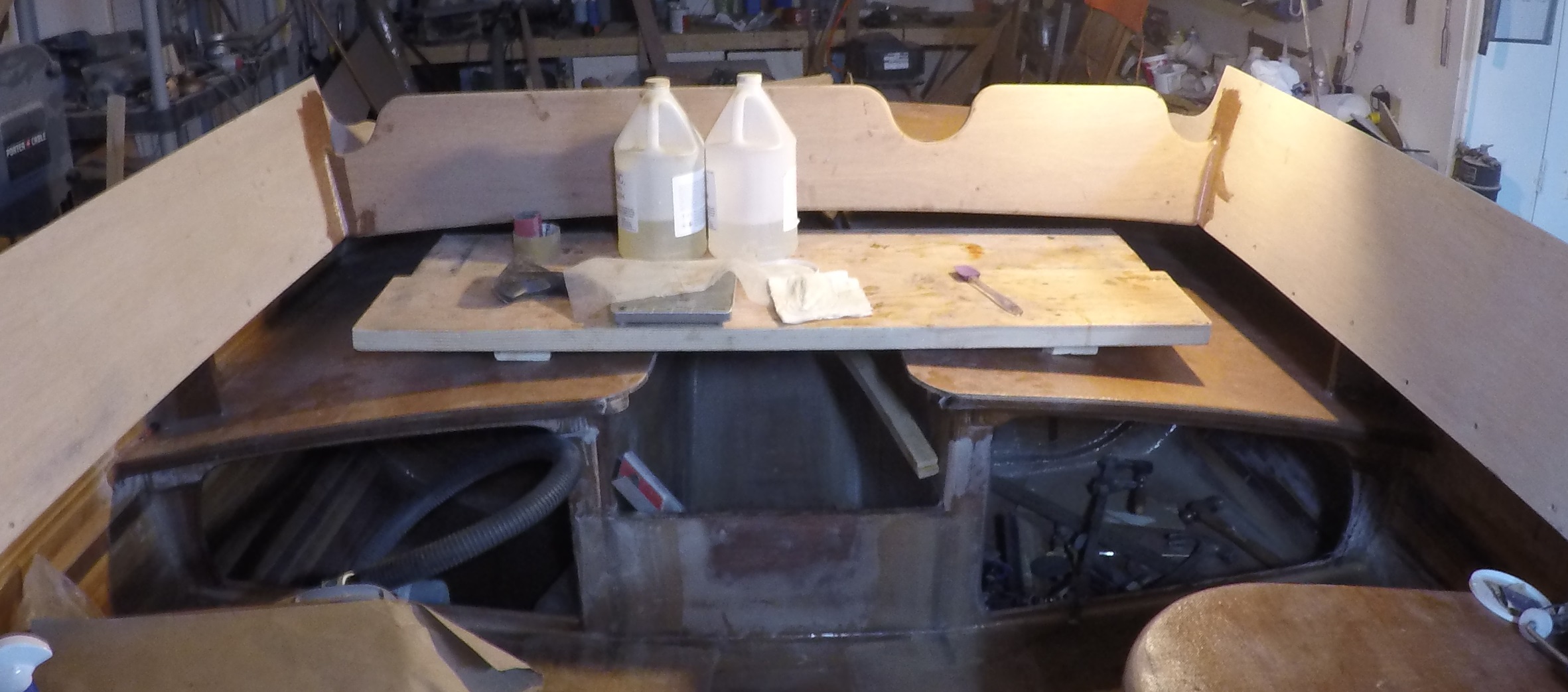

    Finally, the aft cockpit coaming. The notch is where the mizzen steps and is the first guide in stepping that mast. I almost feel that I need to trim the side coaming down about an inch. I'm not eager to do this though as I really like the way the cockpit feels as I sit in it. It's very comfortable and supports you in all of the right places.
    That's it for now. I've glued in some more support pieces and applied FG tapes to finish out the structures in the photos. I'm looking at installing the centerboard before moving on to the cabin top.
