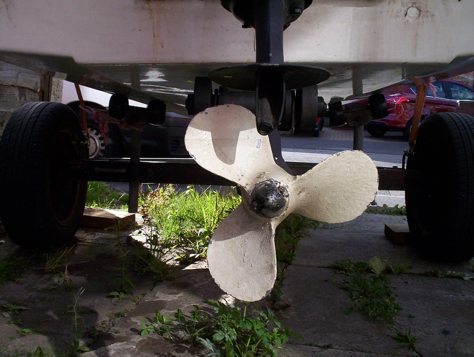

    Pics requested.
    I hope these will do

    Jim Caldwell Senior Member
    Oh My God!!!
    You need a new prop in the worst way!

    I didn't have much luck in your attached files, I did see a few boat pictures but I don't think there this boat.
    As to that propeller.... that surface is totally unacceptable, beyond surface I still question the geometry. If you were to take it off and set it on a flat surface and measured from the flat surface to the tip of each blade, do you think they'd be uniform?
    Gerald

    Might just be me, but that prop shape looks a little old fashioned - maybe 25/30+ year old design maybe more. At minimum, cleaning up the attack edges and smoothing would help ie clean off that rough paint.
    Might be worth investigating prop design changes for the Hp over the years to select a modern version compatible with the engine power/torque curve.

    My picture finesse needs a little attention I think.
    I've got the prop off,and it won't be being used again.
    I think Noah might of had it on his ark.Haha

    You don't have many choices when it comes to props on a 50+ year old motor, aside from pitch I don't think there are many options for performance.

    that prop suits those old engines and old designed boats.
    It looks like you could like the engine height a few inches if it slips then you are higher than that combo can deal with.
