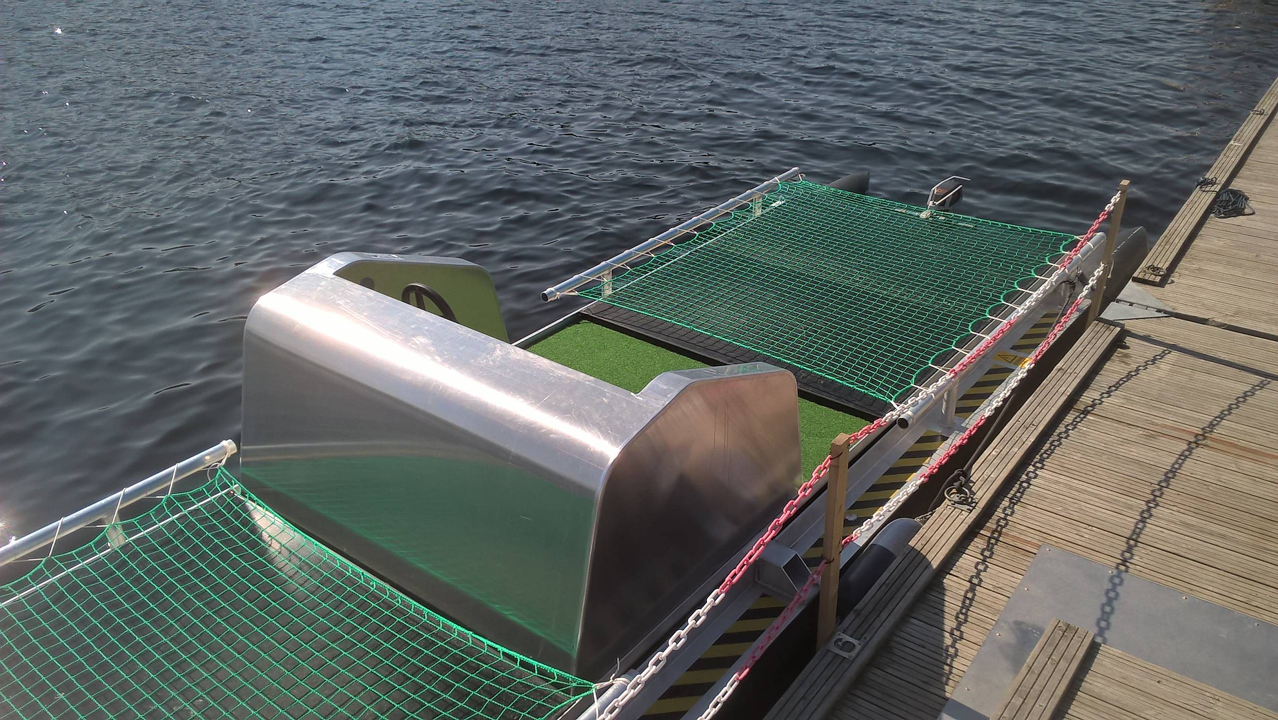

    Just some update. This is how my boat ended up looking, and i am pleased to see it technically works great. It looks quite ugly, but its my own buildt machine!:)
    Here are some images and videos.
    Average on a sunny day the panels give 6-700 watts pr. hour to the batteries. The speed is poor, but that is how it is. Average speed at 1200 watts, are 3,5 knots. Top speed at 2200 watts around 5,5 knots. Total weight 650 kg.

  13. serow
    Joined: Mar 2016
    Posts: 74
    Likes: 3, Points: 8, Legacy Rep: 40
    Location: UK
    serow Junior Member
    If you fall over or step backwards will the netting save the panels? Looks a bit close to me.
  14. Jon E
    Joined: Jan 2005
    Posts: 54
    Likes: 3, Points: 8, Legacy Rep: 22
    Location: Norway
    Jon E Junior Member
    It is just to tell people that this is no step zone. Children tends to walk on the panels when in harbor.
