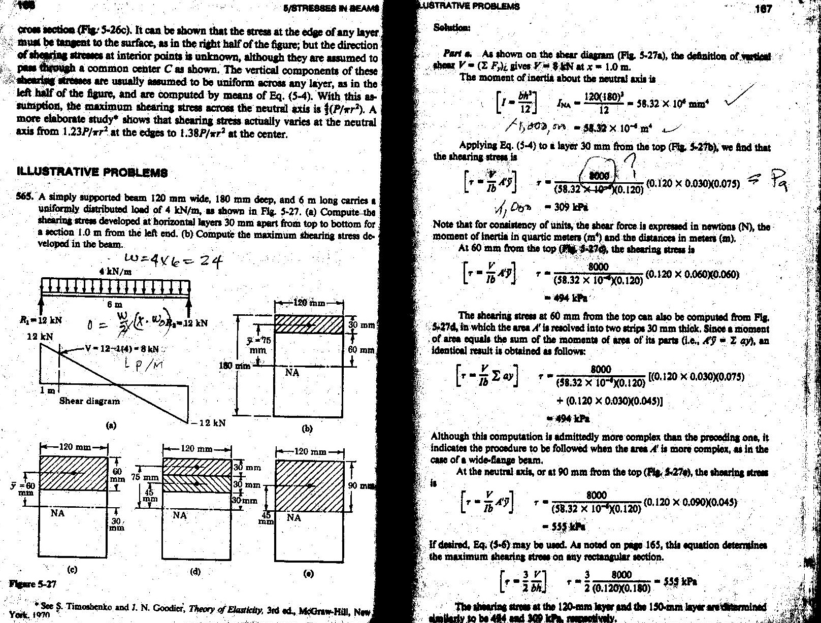

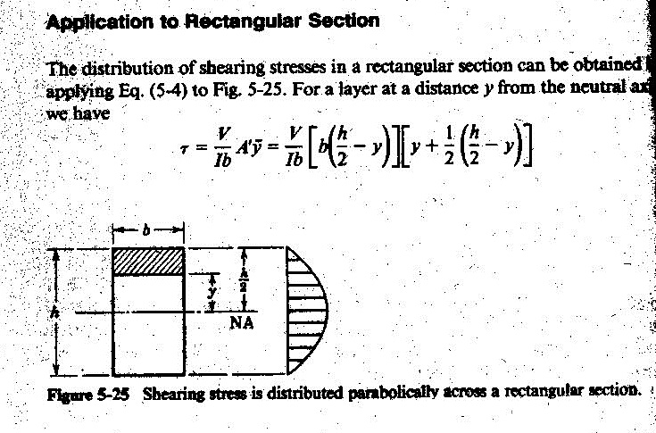

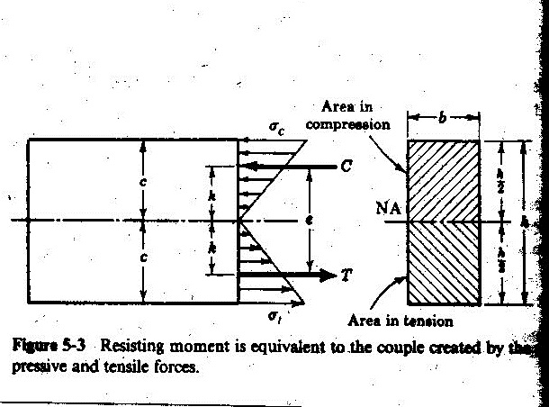

    Barry, you threw the whole book at me but failed to read it first. Here is some images to refresh your memory. The images were from book Strength of Materials by Pytel & Singer.
    Wood is anisotrophic and its greatest strength is when the fibers are aligned to the load. When the load is applied at an angle to the fibers, there is a corresponding loss of strength/modulus. The remaining strength could be anywhere from 17 to 25% of the ultimate depending on the species of wood. At +45/-45 degree angle, the fibers loses much of its vertical strength but gains 100% of the shear strength because the fibers are tugging at each other, preventing displacement.
    When the plywood is laid on its edge, the “I” is increased and there is greater stresses on the faces(edge) of the plywood. The fibers now is aligned at 0/90 degrees. The horizontal fibers will have 100% strength in tensile/compression region while the horizontally aligned fibers will retain about 25% in the perpendicular. Half of the strength to make it simple. The only way to achieve 100% strength is to have all fibers aligned along the load direction, that is to Cap it with a solid lumber or metal and the resulting beam is a reinforced beam.
    The mid portion or the neutral axis occurring in the Web will have the greatest shear stress as the fibers tends to slide past each other. As stated, the +45/-45 fibers has the greatest strength in shear, hence it is logical to use angled fibers in the web.
    In the example posted in No 3, it shows a concentrated load on a simply supported beam. Agree, the shear will greatest at he midspan but it is greatest at the support edge if the beam is uniformly loaded. This V shear depends on the load type.
    This V shear (vertical shear) is reacted by by a horizontal shear, a couple to counteract the vertical shear.
    When you say couple because the other fibers are carrying the load in a vertical shear this is erroneous because what is causing the fibers to bond is the glue or bondline which is usually the weakest part of the design. If the fibers are in +45/-45 orientation, the unit area is only increased as both set of fibers share the same degraded properties. In both cases, the limiting factor is the least mechanical properties of the glue or the degraded properties of wood.
    When a concentrated load is applied at the center on a simply supported beam, the load path is vertical at the point of load and changes direction gradually until it reaches 45 degree at about ¼ of the span. It then reverses direction and continue to change at it approach the point of support. This is because the support is resisting and applies a counter rotating force. The top region, which was previously in compression is now in tension as it nears the fixed support point.

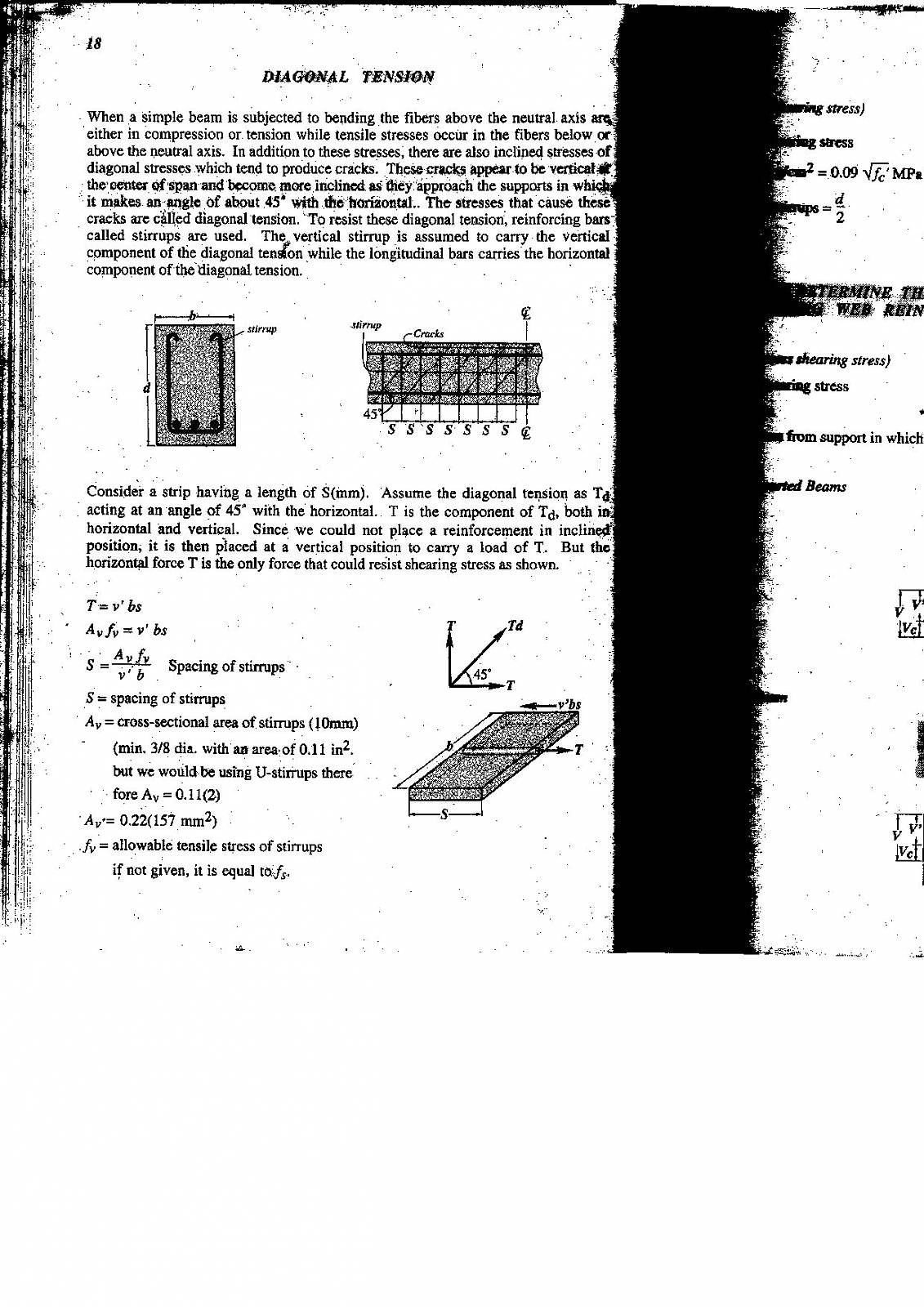

    Your comment that solicited my response was your comment that the 45 degree oriented strands make the beam act like a truss. A truss design produces compressive and tensile stresses in the members through out the structure while orienting alternating plys at 45 degrees do not produce the same stress directions.
    But regarding your last paragraph above.
    1) Your statement the load path changes from vertical to a 45 degree orientation. In about 40 years of practice, I have never ran across this theory and if you have some supporting data to back this up, it would be much appreciated.
    2) ""Then the load path reverses direction and the compression area at the top of the beam changes to tension. ""
    You said in this part that the beam is simply supported ( and that is what we were discussing) but then refer to the couple that results from the FIXED supports
    This is confusing. We are discussing a simply supported beam where all the upper fibres are in compression not the stresses/forces in a beam with fixed end supports
    Any information to clear this up for me would be appreciated

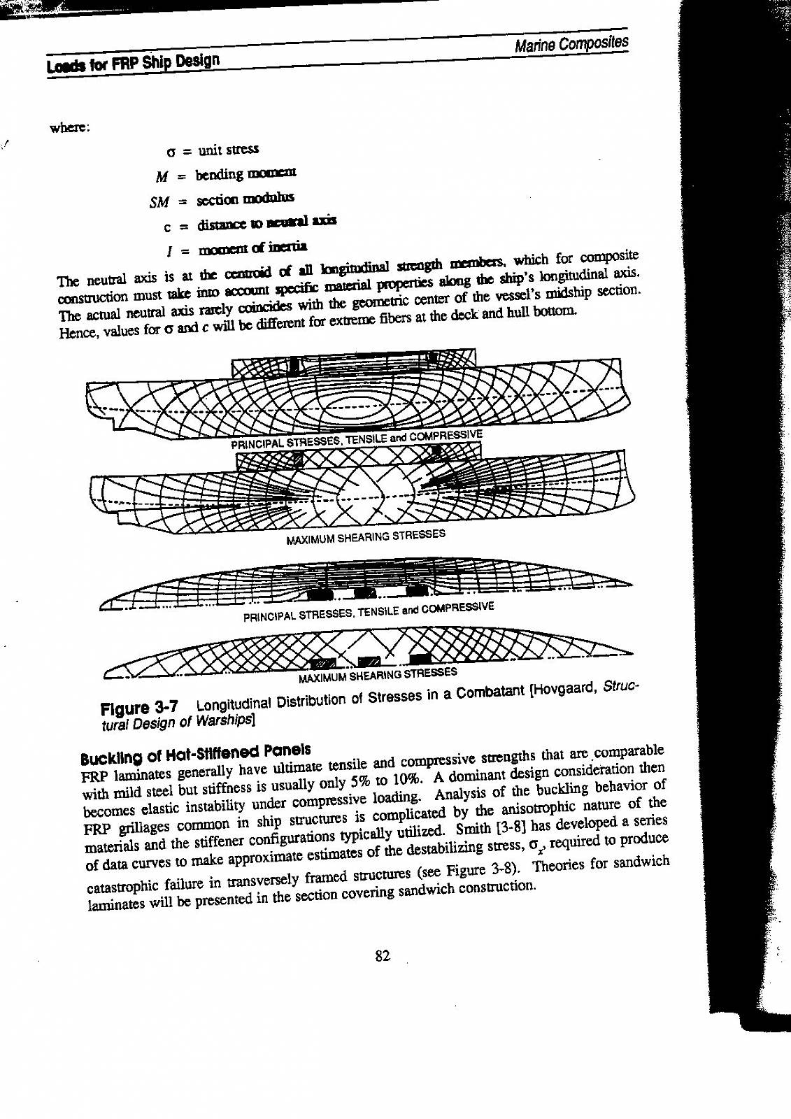

    In Marine Composites (E Green and Associates), where the hull can be considered a simple beam. It is shown that the v hear is almost vertical at point load and how it traverses the length and slopes down towards the mid point and reverses.
    In the second illustration it shows (in a uniformly distributed beam) how the v shear and the couple h shear orient itself in a beam.

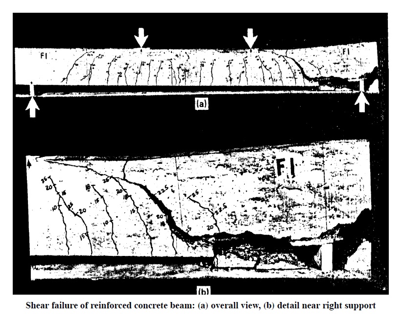

    In concrete beams (which can also be considered a composite beam), it explains the direction of stress as it approaches the support points (Reinforced concrete Design by Besavilla). Further from my reference article shows how the crack propagates in a concrete beam.
    The LR manual on composite design shows the regions of tension and compression and how it reverses due to reaction of the fixed beam or stiffeners and that is how I explained it.

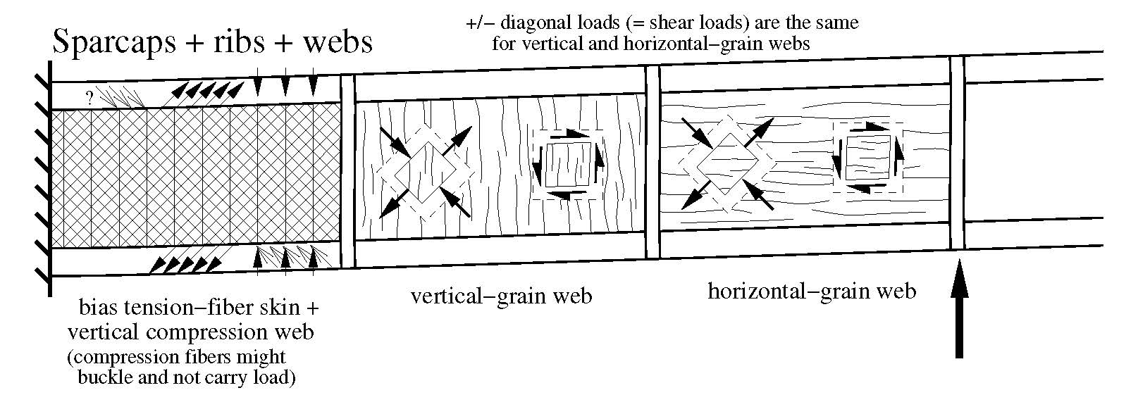

    This can also easily be seen with regards to wood, as posted in mark’s diagrams posted here.
    Which shows such behaviour and how it is indeed analysed.
