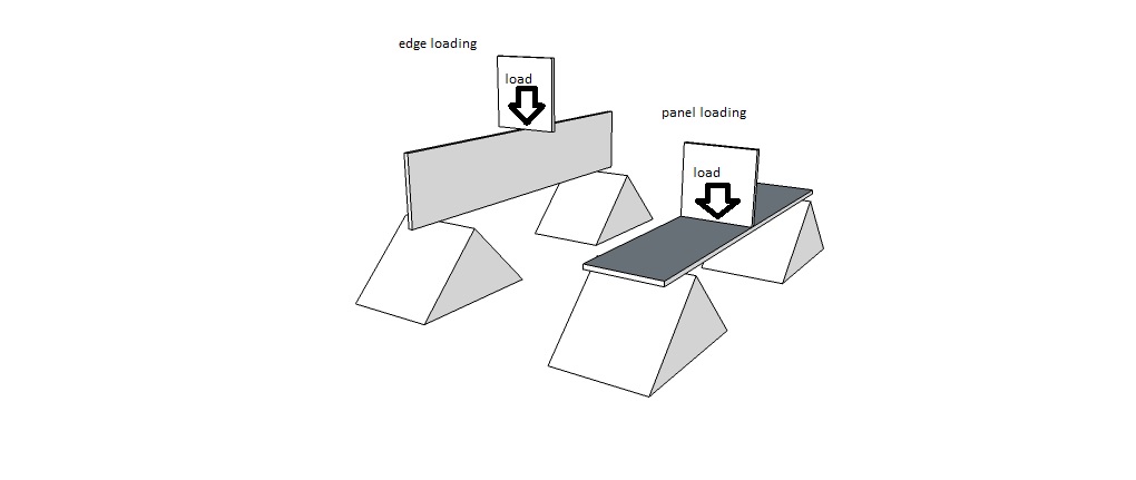

    One of the things that I have been researching off and on is the bending strength of edge loaded plywood. Every study that I have found except for one you tube video is testing the plywood being panel loaded. The one you tube video did not provide what their test results were. Just showed a video of the actual test. Can anyone point me to a study of edge loaded plywood?

    What do you mean by edge loaded?
    Can you make a sketch?
    I don't even know what you mean by panel loaded.

    Here is a sketch, Basically when you are panel loading the load is across the face of the plywood. When you are edge loading the load is against the edge of the plywood.

    You might try looking in 'plywood beam specifications' or something like that, construction type stuff. Maybe here http://www.fpl.fs.fed.us/ or the various plywood organizations, maybe this place http://www.apawood.org/resource-library .
    I kind of doubt there would be much about single thicknesses of edgewise ply bending strength, like a 'beam' 1' x 8' x 3/4" or something. It would be no good for anything in that configuration as it would buckle too easily, unless it was combined with other materials to make an 'I' beam type thing or multiple laminations of plywood that would overcome that weakness, such as an 8" x8" beam set so the glue joints are vertical.
    I think it might be called lateral-torsional buckling https://en.wikipedia.org/wiki/Buckling#Lateral-torsional_buckling

    I didn't specify any particular application because I don't have anything in mind at this time. Sometimes I just research stuff for the knowledge that I gain and store it away. I am retired with time to burn. In long bygone times it seemed like people would engage in research just to see what they might discover. These days it seems like everything is money driven. Thanks for providing the above links. Most of them I have already read. The Canadian plywood design link was new to me and did have a formula for calculating the bending strength of edge loaded plywood if the bending strength for panel loading is known. This was for douglas fir plywood. I don't know if the given formula would be accurate for other types of plywood.
