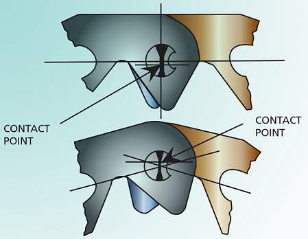

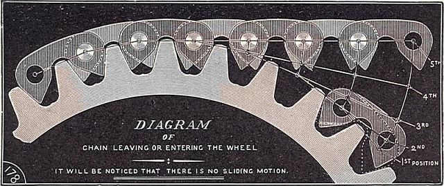

    Sliding Motions at Tooth Interfaces
    This was another reason I chose the chain drive vs belt drive option. Look closely at the interface of the chain with the teeth of the sproket compared to the sliding action you would experience withe the fiber belt arrangement. And look at the size of the contact patch.

  12. Barry
    Joined: Mar 2002
    Posts: 1,855
    Likes: 508, Points: 113, Legacy Rep: 158
    Barry Senior Member
    I understand that a ribbed synthetic belt can attain efficiencies of near 98%.
    Your pictures states no interference in the chain, ie sliding along the tooth to link interface. But this might only be where you are not running through a gear reduction where the Beta angle (the angle the chain is in contact with the sprocket) is 180 degree. Ie a one to one ratio but say a two to one the situation might change.
    Re no sliding, there will be significant sliding in the pins of the link and normally if you use a chain, a lubrication systems, oil feed, pump, reservoir enclosed chain case, seals etc MIGHT be required especially in high horsepower applications
    Of course there are many examples of dry chain power transmissions

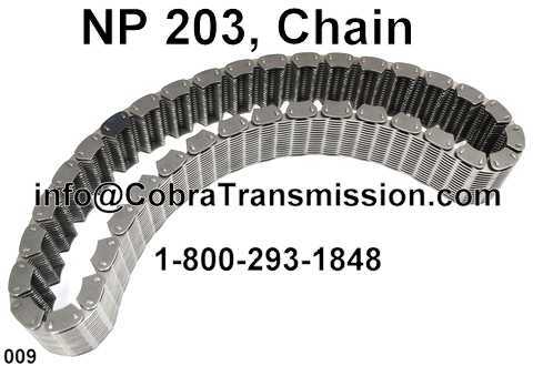

    For a wet lubricated chain drive system, there were literally millions manufactured by a company called New Process Gear for installation in 4 wheel drive trucks in the 70's 90's and perhaps even today. These would be coupled to engines up to 350 horsepower and were splash lubricated.
    NP 203 was the chain transfer case and NP205 was the gear to gear transfer case.
    This chain drive did not offer much of a gear reduction if any and the entire unit was quite heavy.
    The weakness would show over time as chain and sprocket wear. The chain had several parallel rows of links, ie like a link belt about 2 inches wide to carry the load.
    Regarding your comment, "look at the size of the contact patch" If you have a surface that has a convex curve touching either a straight or another convex curve, you will have only a linear contact line. Ie one thin contact line running at 90 degrees to the sprocket face. Much like a spur gear
  13. Barry
    Joined: Mar 2002
    Posts: 1,855
    Barry Senior Member
    NP203 chain

    Interesting questions you ask, and I am not sure i can answer them thoroughly at this time.
    Possible, but because of cordial actions I think the chain outlast the synthetic belt.
    The vertical drive leg configuration I would be utilizing would be more of a one-to-one application rather than any sizable 'gear reduction'. Any gear reductions would take place in the gear box & reverser attached to the engine.
    I had thought that some lubrication fluid would be needed for both the chain and the bearings in the opposing shafts. That could occur with a slight splash type lub, whereas synthetic belts might not like those lubs being supplied to the shaft bearings.
    I believe the PYI units utilized chains that were greater than 4 inches wide.
    "Width?
    Silent chain widths can range from less than 1 inch to over 20 inches. As width increases, so does cost, so it is most economical to choose the smallest width suitable for the application at hand. Whenever possible it is also advisable to choose from stock or standard widths rather than specifying a width that must be specially ordered.
    "Two Pin or Single Pin Joints?
    Two pin joints have pins that roll or rock on one another when the chain flexes. This type of joint minimizes friction, vibration, and wear while maximizing efficiency. Single pin chains contain a single round or oval pin in each joint. These are very simple to connect, resist fouling, and can be more economical for conveying or less rigorous PT applications.
    http://www.ramseychain.com/eng_fundamentals.asp?id=3"
    Somewhere doing my research I found an engineering site that discussed this 'gear/sproket engagment' issue but I can't find it right now.
