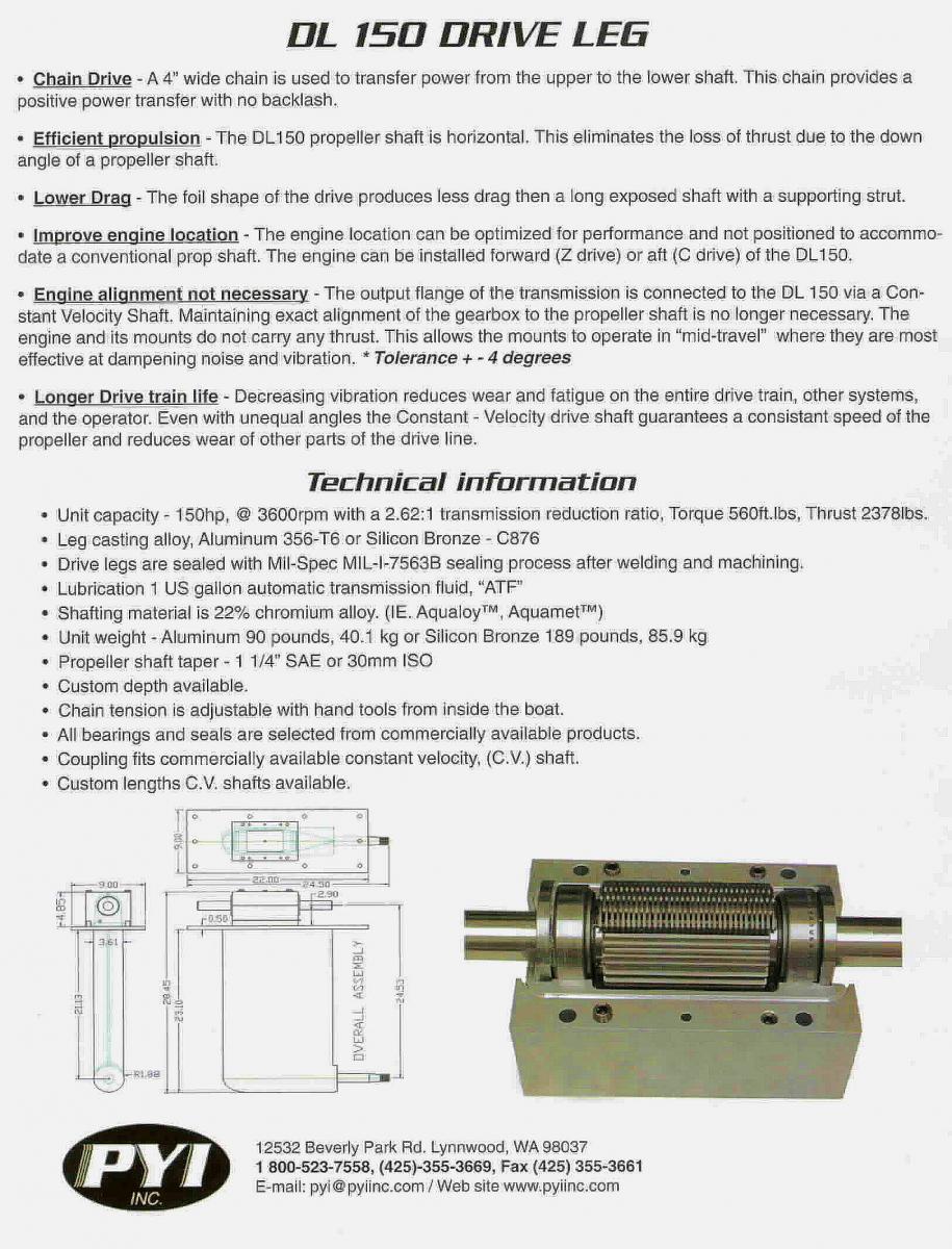

    In the case that I brought up with this PYI unit I mentioned and photoed back HERE
    the drive unit itself is an individual unit that is subsequently joined to the soft mounted engine by some sort of drive shaft with CV type joints.
    Of course there were other units such as 'sail drives' that directly connected the engine to the drive train, and then soft mounted the whole unit into the hull with waterproof diaphrams.
  14. brian eiland
    Joined: Jun 2002
    Posts: 5,288
    brian eiland Senior Member
    There was no development monies available.
    I had started out thinking Kevlar belts, but became convinced that the silent chain was a better idea. Here is a posting (2004) where I was going thru that transition:
    YachtForums.Com - View Single Post - New Drive System from Volvo Penta
    PYI had come out with a chain drive leg, but only marketed it for a few years. I'll see if I have a few other photos of it. I did collect a lot of info on these silent chains and identified a prime manufacturer I wished to work with on development of such an outdrive leg,...if some development monies should become available.
    One sample installation I saved on my older computer
    Paradise 60 :: Paradise Yachts
    One older spec sheet on the smaller sized unit:
