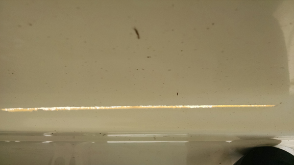

    IMG_20150502_125158754.jpg Not sure this is the right place to put this question.
    I was given a fiberglass 1983 StarCraft. In the process of removing the rotted deck I made the major blunder of getting the saw a 1/2" too far over and cut an 18" gash through the hull :eek:
    How do I go about repairing this cut through the hull to make it water proof again? I was pretty comfortable with redoing the fiberglass tabbing and other work inside the boat but this one has me nervous. Once the floor is put back in this will not be accessible from the inside without cutting out a section of floor to regain access so I really need to get it right the first time.

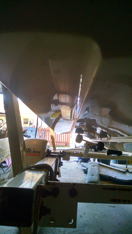

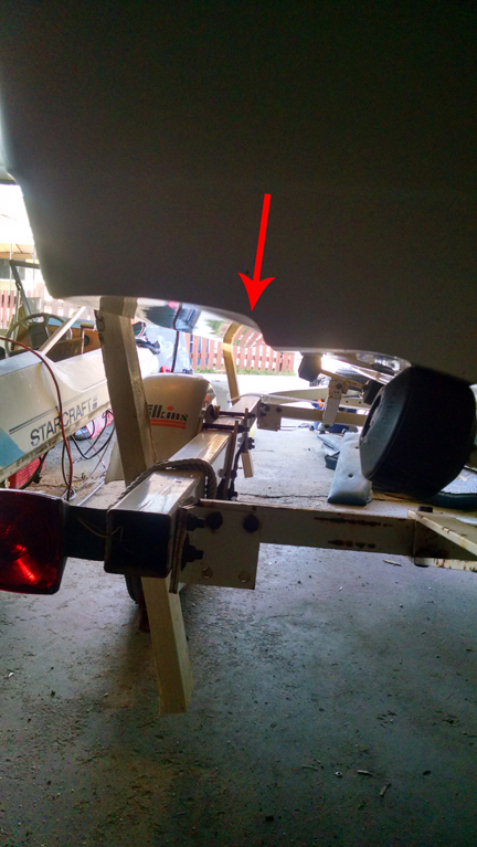

    It is on the bottom near the rear, in the one the cut is not visible but the arrow shows where it is so you can get a better idea. The cut was made with a circular saw so it has smooth edges as opposed to something hitting the boat and causing a ragged hole

    I haven't been able to get a good picture from the inside. The cut is on a flat section just after the hull comes up. Right next to it is where the plywood floor stops then the hull shoots up about 3/4 of an inch then levels off until it reaches the wall. The cut is very close to where the fiberglass goes from being vertical to horizontal so it is right against a curve that forms that change in direction and on the horizontal piece. I would guess the fiberglass is about 1/8 of an inch at that point but I will try to get a more accurate measurement when I get home from work tonight.

    I wouldn't try repairing it from outside, except the finishing touches, you will need to fill that gap temporarily with something you can remove later, that stops resin leaking through and running all over the bottom leaving a mess. If repairing with polyester resin, the surface prep will need to be thorough to ensure satisfactory bonding. I would just use mat, starting with bigger rectangular pieces, that extend well away from the damaged area, and then progressively narrower ones as you build the layers, all centred on the cut. That way the maximum thickness of the repair will be over the cut. Also, you get a big surface area of contact for better adhesion. I'd go with a good multi-layer lay-up tending toward over-kill. Then remove whatever you plugged the cut up with, and bog that from the outside with a suitable filler, preferably epoxy based, that won't slump out of the gap before it goes off. You will go nuts if you try and glass from both sides, inside and out, imo. But obviously you need to go about it properly, because there is the potential to start taking water dangerously if you don't.

    This isn't all that unusual a thing to happen or to repair. Grind down 2/3's of the laminate thickness on the inside of the hull, feathering it back a few inches away from the gash. You'll replace the material you've just ground away. The grinding back thing permits a large enough "purchase" area for the new goo and fabric to bond to. Next pick you resin system and there's three choices, polyester, vinylester and epoxy. Epoxy is the easiest for the novice to use and the strongest, but the repair can be done with the other resins too. Basically, you'll bulk up the removed laminate, with new fabric, until it's at least as thick as it once was. With this performed, now you'll have a gash visible on the outside, probably with some dried goo oozing through in spots. Grind this area down, so there's a slight depression along the length of the cut. Lastly, you'll fill this depression with a fairing compound of some sort, either home made or premixed (like Quick Fair from System Three).
    If you can't get at it from the inside, do the same thing from the outside, as described above, you'll just have more finish work to do. Paint over the area with a good quality paint, or you can have a shot at gelcoat, though it takes years of experience to make a good match with gelcoat.
