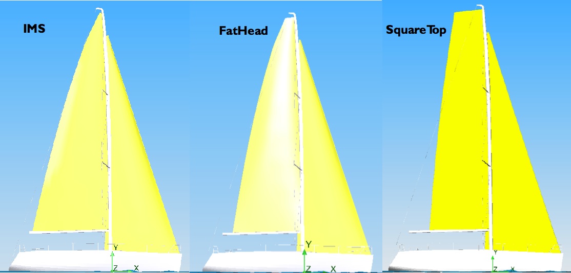

    Mikko while I understand the implications of downwash and heeling moment point to the benefits of a pin-head sail, I think Square tops have a practical performance benefit beyond just mast length limits. I agree the difference between a well set up pin head and square top sail isn't as large as some may think.
    The Star is likely to be one of few boats highly optimised for a pin head main. (tiny mast tip with no spinnaker load, and finely controlled mast bend)
    Some benefits to Square tops:
    In yachts, the drag at the tip of the mast itself is likely to be significant, mast's don't taper that much at the tip, so a larger sail chord will give that upper one or two feet better aerodynamics.
    In other boats, the range of the rig is likely to be better from a square top. It can be difficult to get the correct twist in the head of a pin head sail across the range, ie. not to overload the upper leech down range, and be able to flatten the head sufficiently up range - especially boats that cannot access sideways tip bend due to mast head rigs etc.
    If setup properly the square top achieves both of these - controlling the camber and twist of the sail more readily to the conditions at hand. Up range, the head should be completely flat and twisted off, while leaving the lower third with camber. The downside will be the extra skin friction of the square top, less so the incorrect downwash.
    Also fanning and incidental dynamic response during manoeuvres could be a large benefit.
    It would be interesting to compare the CFD video you have of a boat (star?) through waves, showing vorticity and loading changes as the rig pitches, to a correct aeroelastic model of a square top. (I imagine this would be impossibly difficult to model)
    I have seen some wind tunnel studies on square tops, but what I saw didn't show the twist setup correctly etc.
    I also agree that rule constraints often create 'overdone' square tops, ie big rigs on 18' skiffs.

    Ben G: Obviously, both pin head & square top will need a different mast and correct trim to perform at its best. When the question about classic vs square top sail raises, I usually point to the JPK 998 case: The builder had 2 boats built and optimised, one for a classic main and the other for a square top, and sailed a whole summer (with different skippers & crews) with both. At the end, the classic rig was chosen, being easier to handle (one permanent backstay vs. 2 running), always performing a little better upwind (pointing a tad higher), and similar off the wind.

    I've run simulations (quite a while ago) on fat heads & square tops, on the same mast length and sail area. In these, the fat head & square top did perform marginally better, but the mast length was the same. When over trimmed, with it's wide top, the square top has a large area stalled above the hounds, the classic sail a lot smaller area. I believe, like the plumb bow, it's much fashion.

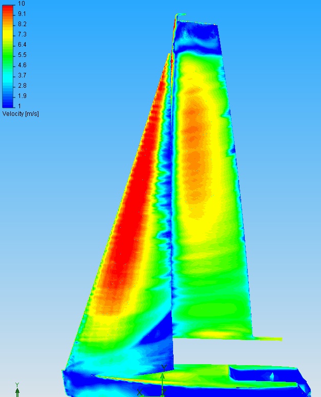

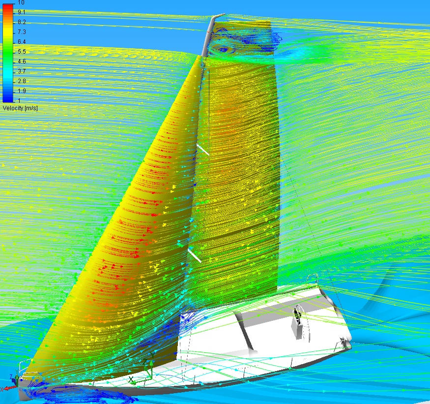

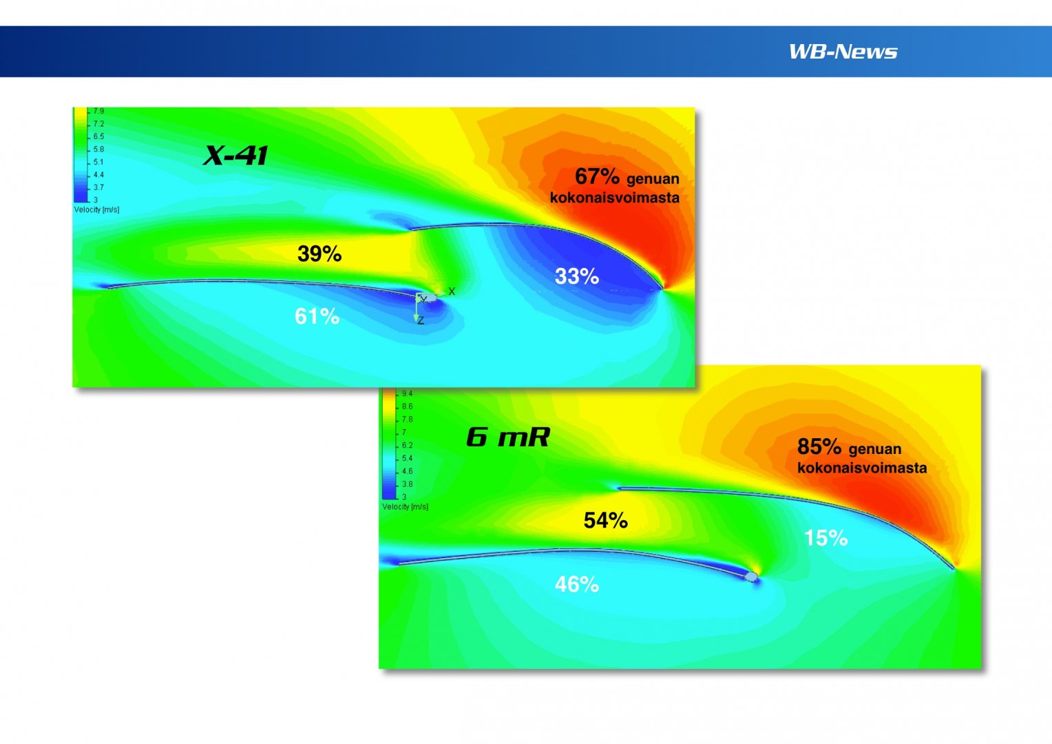

    What's the reason for having the hounds below the tip? Aerodynamically it doesn't make sense, since it promotes local tip stalling as your calcs show. This is why a leading edge slat on a wing always goes all the way to the tip.

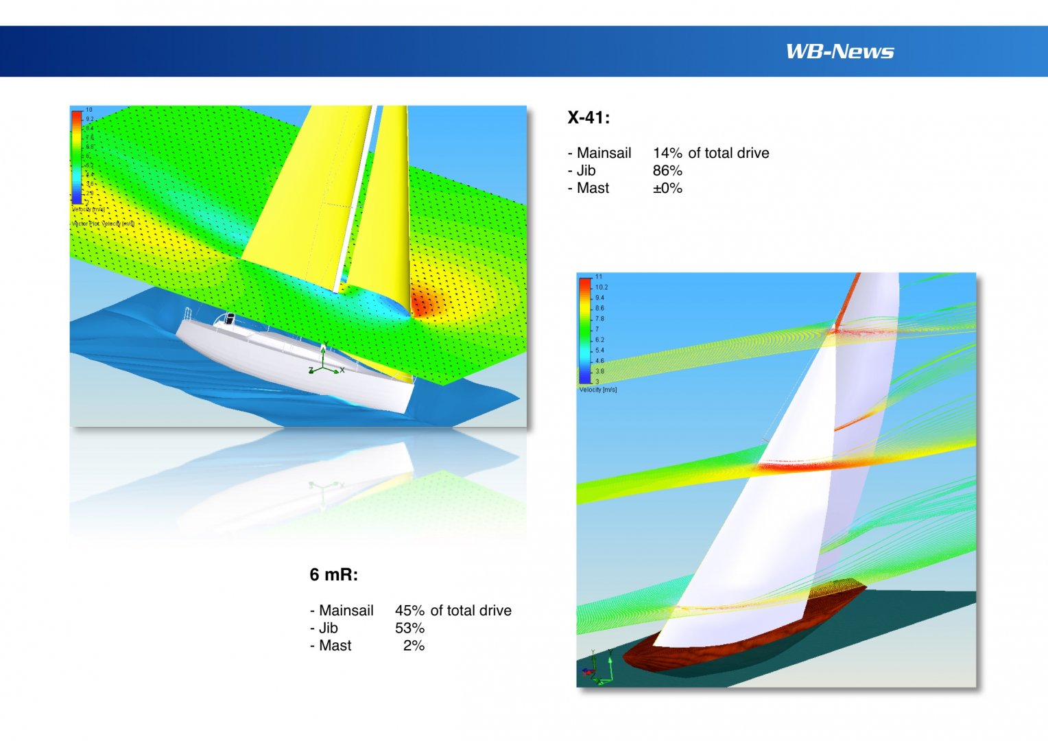

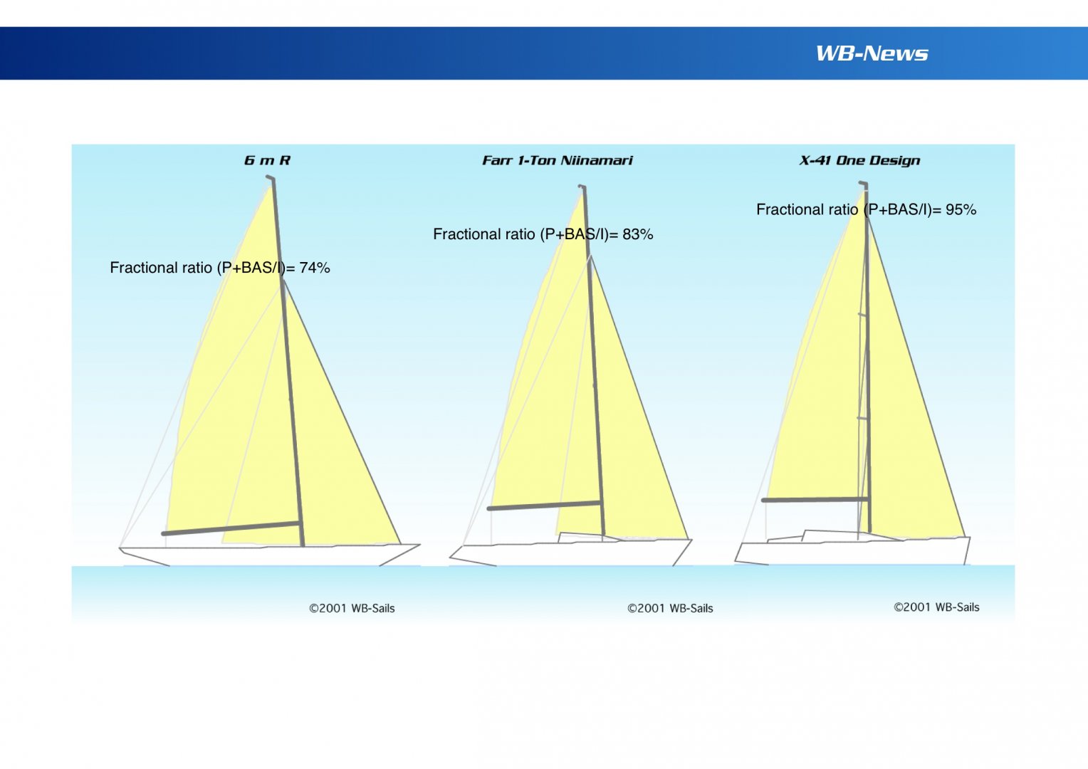

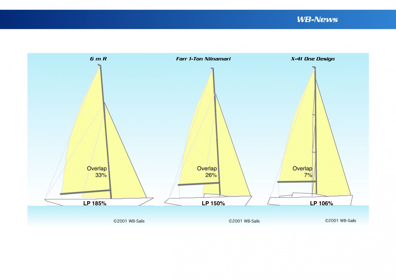

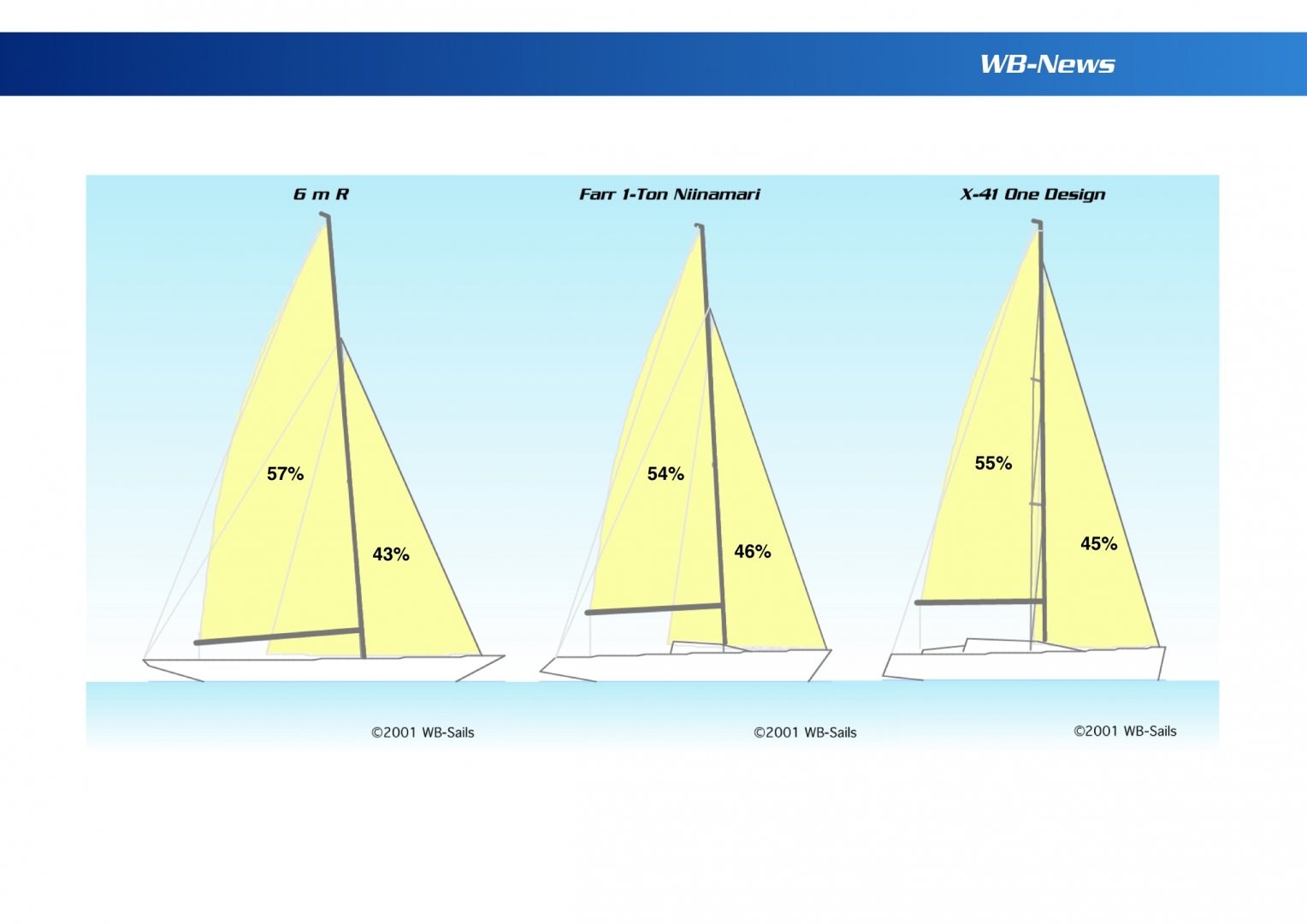

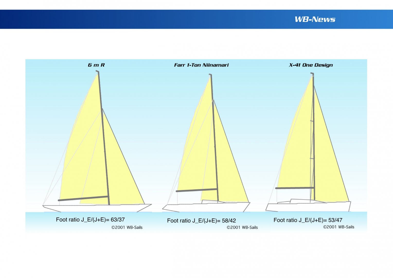

    It's a control thing - easier to bend the mast with the backstay when the forestay doesn't go all the way up. With the masthead rig, you need to add a "babystay" (inner forestay) to be able to bend the mast properly. For control, a fractional ratio of 75-80% is the best, as that kind of rig will work automatically: When a gust hits, the mast top will bend aft and the mid-mast forward (with the hounds as a pivot point), effectively flattening & twisting off the mainsail. The masthead rig as well as the current 9/10 rig lack this automacy, requiring manual adjustment as the pressure changes. You need a long enough topmast, to have the "lever" to bend the mast automatically with the leech pressure.
    Very much about sailboats is dictated by rating rules. In 1970's-80's, the IOR rule dictated how sailboats looked like. The era started with masthead rigs, aerodynamically most efficient, but with time the masthead rig was replaced with a fractional one, more versatile to trim and outperforming the stiff masthead rig. The mast is to the sailboat what suspension is to a race car - when it gets bumpy, the bendy fractional rig outperforms the stiff masthead rig. One reason is that with the masthead rig, the foresail gets so large - the foresail shape is more difficult to control (no mast), and the mainsail is producing most of the heeling moment. So a larger mainsail will provide more scope to power control. Sail trim is in essence power control.
    Attached (historical) rig types illustrated.

    As you may recall, the fractional rig era started with the Bruce Farr quarter tonner 45° South... the French quickly adapted the fractional rigs into half tonners, 3/4 tonners and 1 tonners. For bigger boats, it depended on how & where they sailed: Inshore on windward-leeward courses, the masthead rig with big spinnakers was good, while offshore, with fetching and reaching and bumpy (waves), the fractional rig was unbeaten. The large genoa of a masthead rig is not very good as soon as you ease the sheet - too full in the foot and too open in the head, while a large mainsail with a long boom and vang works much better. Then waves matter a lot: While pitching in waves, the pressure on the sails varies easily +- 30% in a 1-2 sec. period - here the fractional rig with its automacy easily outperforms the masthead. In waves, size matters - in 20 kn, the waves are large for a 30 footer, but an 80-footer power right through them without notice. I guess this is one reason why bigger boats still sport masthead rigs more often.
    In the late 80'ies, even maxi boats got fractional: In the Whitbread 89-90, I sailed on Belmont Finland, with a fractional rig, like all others... In the pre-racing/practicing, we sailed against round-the-buoys IOR maxis on windward-leeward courses, with no chance against them, finishing often almost half a beat behind. On the other hand, when we did a practice race across the Atlantic, the same masthead maxis were 3-4 days behind us - of course, there were other differences, the heaviest round-the-buoys IOR maxis weighed 40 tons, while the offshore maxis were 25 tons or so.

    It's interesting that you say the era started with 45 Degrees South. I know many English-speaking commentators say the same thing but I wondered whether someone from Europe may also have been interested in the earlier fractional rig 1/4 tonners like Listang and Quarto. Obviously their fractional rigs were of very different proportions to 45 Degrees, but one of them won an early worlds and the other lost in '74 only on protest so both showed good speed.
    I completely agree with all you said about the comparative performance of the rigs, of course, and it's very interesting to get information on Belmont Finland, which was a lovely looking boat. The fractional rigs had such an impact on us down here that it took me some time to work out how and why they didn't work all the time in the big boats.
    Years ago I did an interview on trimming Farr 40 sails with Grant Simmer, after he had won the worlds. He thought that basically, the stiffer the mast the better and I note that the Farr 40 seems to have about as high a forestay as the X41, yet you appear to thing the X41's forestay is too high. Have techniques and materials caused changes, or is the difference related to the greater weight etc of the X41 and the possible difference in sail shape, acceleration etc?
  15. Joakim
    Joined: Apr 2004
    Posts: 892
    Likes: 52, Points: 28, Legacy Rep: 422
    Location: Finland
    Joakim Senior Member
    Farr 40 fractionality is 88% and X 41 94%, which is a huge difference for trying to control forestay without runners. At 88% you really need a stiff mast for that!
