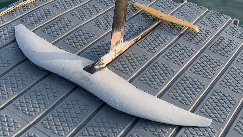

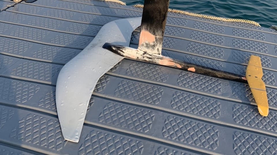

Has anyone seen a foil using bell shaped lift distribution? I have been looking at Al Bowers' prandtl flying wing, for a downwind foiling paddleboard the concept of wing tips producing thrust sounds very interesting.
Thanks I had found that just after posting this! although the talk there seems to be more on how to apply the theory to sails instead of hydrofoils. The equations all fly right over my head but I do agree with the basic principles- linear downwash distribution, not linear twist and load distribution.
As there is an immense amount of talent and knowledge here I was just curious if anyone had seen it successfully applied to a foil - T shape, not L or J
I should add I have already designed the foil (based on numbers defining twist/AoI given to me by Al Bowers himself) and started construction, I am only after opinions that arent mine!

<photos added to post using "Upload a File" near reply area>
I cant figure out how to upload pictures but as you can see in the vids it actually has 4 wing tips! Maybe a foil version of Al Bowers flying wing could do away with the horizontal stabilizer completely?

I don't want to dampen your enthusiasm, but I don't think there is a planform that results in a bell-shaped spanload distribution under all conditions. Instead, any given planform must be twisted to obtain that distribution under whatever conditions it is encountering.
That might be achievable in a sail if you had total control of its twist, but wouldn't work with a rigid foil.
Aircraft attempting endurance records (as featured in Bowers' papers) can adjust their speed to allow constant lift coefficient as their weight varies (due to burning fuel), thereby staying near their optimum loading, but a foil will need to use different lift coefficient to support a constant weight at different speeds.
Thanks doug that does make sense. the spread sheet Al gave me was based on a 1 metre span foil doing 32 km/h carrying 90kg I think. the total twist is 11 degrees from the centre to the tip ( +9, -2) I stretched the span out to 1.4 metres (1 metre is a bit small to be giving away area to downforce) and reduced the chord to keep the surface area around 1500-1700 cm/2. Ar is 14 if my numbers are correct. span squared divided by area? it is only an approximation off the drawings so dont burn me at the stake for not taking into account surface curvature etc.
speeds are usually between 8-15kts on a downwinder, although Al's guess was on the high side it is still realistic. I am also able to greatly vary the total lift of the foil by changing tail wings or tail wing angle (less downforce on the tail, less total lift) and can actively adjust effective load on the foil by moving my weight forward or back on the board. this works well as by taking a small step forward you can essentially double the load on the foil, keeping it in the water when you drop down a wave and your speed nearly doubles.
I think this design could very well work for tail less foils as the tips are performing the same function as the tail wing (at our chosen speed of course, this idea is only for downwind racing. who can do 20-30-40nm the quickest. simple.. right?), and if theyre swept back to a position behind the mast then that downforce will be aft of the CoE, and out in clean water.
I know nothing is ever black and white, especially when it comes to wing design and fluid dynamics. but I also know its not impossible and thats good enough odds for me.
