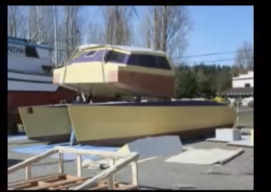

    This Skoota 28 is very close but no inside access to the hulls
    No swinging arms. Wonder how wide the two hulls side by side?

    The Skoota 28 hulls would be trailerable side by side.
    I am building a Woods Skoota 32 Demountable-powercat. Hulls are also trailerable side by side; about 45" wide each.
    I have considered a trailer; did some mock ups with wood.
    I am convinced the best solution is to launch the hulls conventionally with some temp scissors. So you back to the water and the boat is launched and spreads apart in the water. Then the trailer bunks have slides; like 3/4" ss linear bearings. You'd slide them out with hydraulics and set bunks on them (you cannot trailer on slide bearings-they will fret). You move the trailer back to the water then bring the hulls back on shore.
    Then you lift the cabin up and set the beams and assemble out wide. Back down again. Lots of variables, but it would work. Cost is the issue. You need to model it first to work out the details at 1:10 before building it real and rebuilding it 12 times at full cost.
    For now, the trailer is a maybe for us. I can always hire the boat moved on a semi and assemble it at a marina with a crane.
    If I were building a smaller cat; I'd do the same thing. Put the cabin ahead of the hulls; launch the hulls with temp scissors; move the bunks out; bring the hulls back in wide; cantilever lift the cabin up; retract hulls to home; install beams; lower cabin to home; lower cantilever section; any miscellaneous assembly; back it down.
    For the Skoota 32; the cabin is 13' long; so it is the same concept, but two trailers are needed. The height of the assembly is too high to be safe. The cabin would be rolled off the aux trailer onto the lifting trailer.
    Loadmaster would build it for you for $100k. Yikes.
    The neat thing is you could stay in the cabin on the way if you went a long way. And all the stuff would be loaded aready, etc.
    The Skoota assembly would be tougher because my beams weigh about 120# each. They are not something me and the wife would handle easily at that height; so you'd need some means to lift them as well.
    My friend thinks I need a crane on a trailer; it smells of semi to me to the point I want no crane. Maybe a crane to lift the beams might be good.
