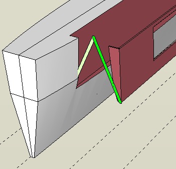

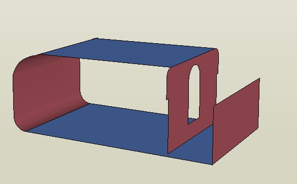

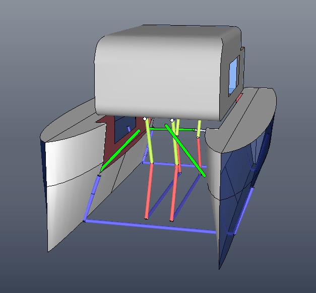

    this shows the "scissors" when assembled. the outboard ends are pinned to the hulls. the inboard ends are pinned to each other.
    the aft vertical wall of the cuddy cockpit has been removed to show the cuddy compression member blue
    the starboard hull has been cut away to show only the receiving structure in the hull dark red.
    the short vertical strop lifts the center ends of the scissors to pull the hulls in onto the cuddy

    I do not use nuts/bolts. There would some registration pins molded into the mating sufaces but the key elements are the tensioned scissors and the mast assembly which pushes down on the cuddy and up on the hull edges.
    this shows the scissors in the packaged state

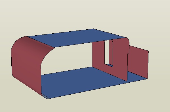

    The cuddy is built basically as a normal bridge deck structure. It resists all racking loads of hull movement and locks the hulls into place.
    The loads are transferred from hull to cuddy to hull by the surfaces and registration pins.
    The compression loads are fairly easy to design for and build as the area for transfer loads is quite large, the wracking/torque loads are more difficult as the area of loading is much smaller.
    The tensile loads are damn difficult. Building the registration pins and passing their loads into the structure would need care.
    The cuddy could actually have a dovetail flare on the outboard edges to "key into the hulls but releasing/demounting the cuddy might become more difficult.

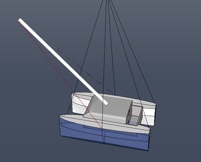

    This image shows the structure for raising/lowering the cuddy.
    The hull cradles slide out sideways to allow cuddy insertion.
    So, at the ramp. raise cuddy slight to free the hull. Slide the hulls out. Lower the cuddy. Lash the fore and aft scissors to the cuddy and tension.
    The mast with all stays attached is raised. The butt of the mast slides in from aft and the backstays are retensioned; the boom is used to lower/raise the mast.
    The stanchions and safety lines can remain in place. But care would be needed not to damaged during transit.

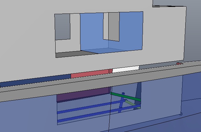

    have them, I call them mailslots 1.8 m long and 0.66 m high
    not a dignified entry of course.
    this shows port hull with outer skin translucent. The cuddy is ready to be dropped into position.
