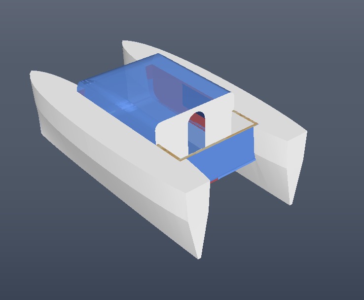

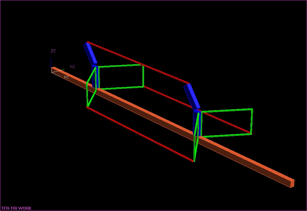

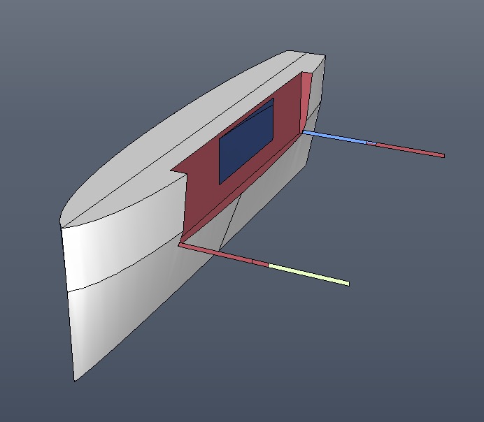

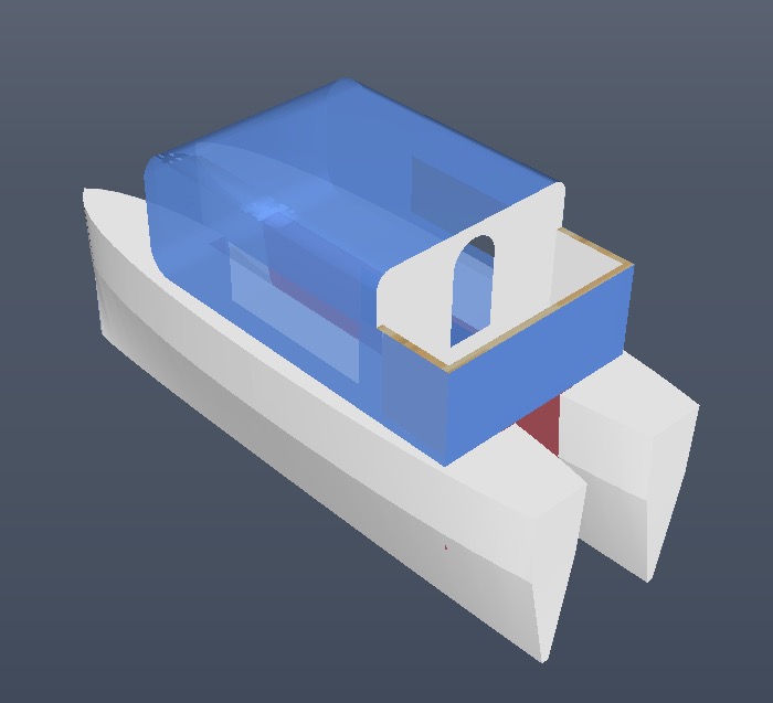

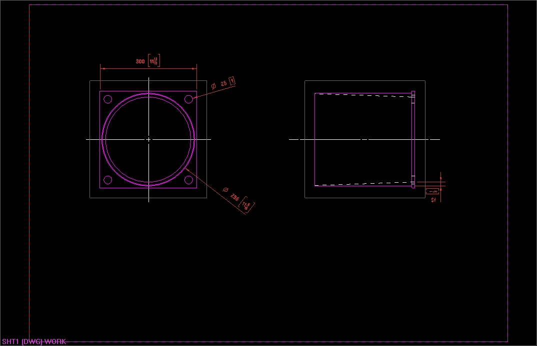

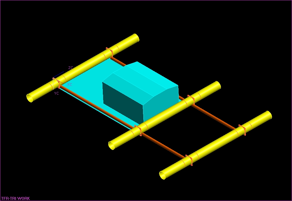

    Ok so PLEASE BEFORE LOOKING AT THE PICTURES BELOW READ THIS.
    This is really quick and dirty. It seems my explanation isn't clear I just hope this helps. I hadn't intended to raise this here at least not now but
    redreuben asked so :) It's a busy time of year...
    In theory there are some jpegs below. They should show a picture and drawing of 3 transverse beams with a rear hard deck, pod and forward open area for the nets. Conventional open deck cat layout. The 2 things to note here are:
    The longitudinal members connecting the beams. I've shown them as orange cylinders but they could be anything. Their job is to make the bridgedeck one piece, no assembly.
    The flanges in the beams. Each beam consists of a 2.4 meter yellow mid section, 2 1.2 meter long ends which fit inside the hulls (these would be trimmed to suit the width of the hull obviously) and in the join of each I've put flanges. There is a separate drawing showing what might be possible. Assuming aluminium round section beams I made them 300 by 6mm wall. The flanges are aluminium sized to slip inside the beams and glue to avoid welding. The outer end of the flange is 12 mm tapering down to maybe 3 to avoid too much of a stress rise in the beam. On the outer face of the flange is a plate welded probably and 4 holes drilled. I've drawn it as 10mm plate with 25 mm holes.
    The other pictures show the bones of the trailer.
    The hull cradles are not shown only the "swing wings". These rotate like a dragonfly trimaran's floats. Rearward and out.
    Atop the trailer is another swing wing only this time vertical. There would be a platform structure on this, again not shown, to carry the bridgedeck forward and up.
    Triangulation and details not shown.
    Mr Woods: Yes that boat is somewhat similar in that it elevates the bridgedeck, but it looks like they tuck the hulls under on their side. I want to bring the hulls in in a vertical condition. If I were rotating the hulls I might as well stick with your very well thought out Sango.
    I don't know about windage on Sango. There are other cats, like the F1 that have significant silhouettes thanks to 6' standing headroom in the hulls. Sango's cuddy is no higher and fairly short. If it didn't present problems on Wizard then surely it wouldn't be a problem on the longer boat ? 2c..
    I might try to produce another picture of the beams in 3 pieces to make that bit clearer. The flanges as drawn could be made to work. I was pondering if glass beams could be made sensibly and what options that might present for the joints.
