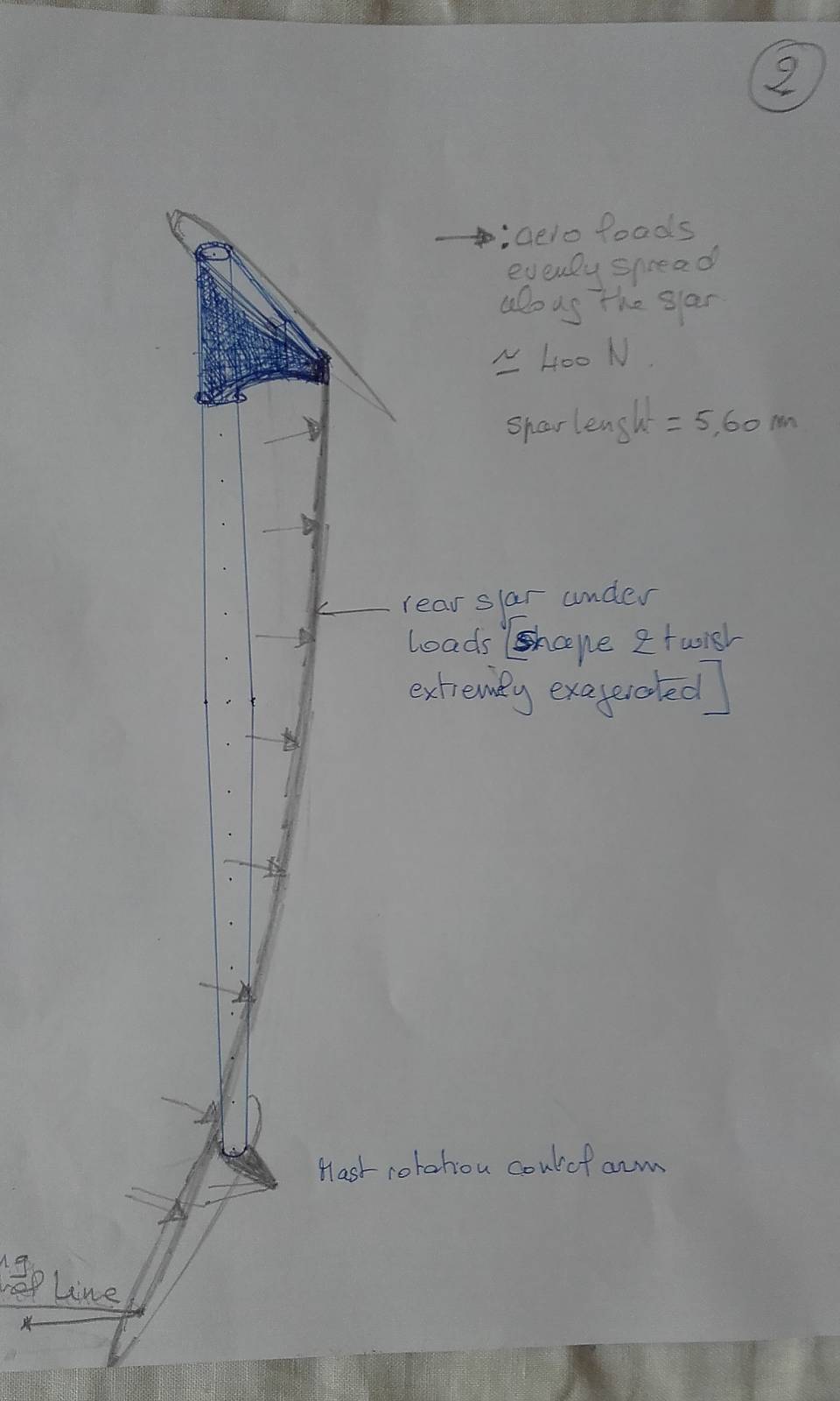

    Hi everybody,
    I d like to calculate some I-Beam/UD Carbon stifness.
    But I am totally rookie with structural engineering & FEA
    That is why I ask if anybody knows a good freeware which could be useful for my problem.
    Thanks in advance
    EK

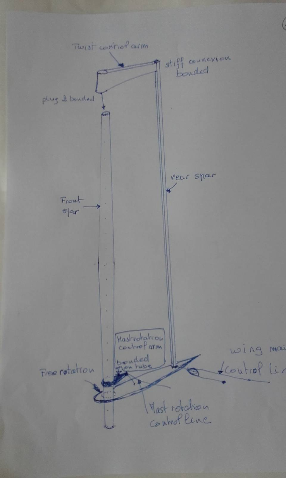

    Thank you very much TANSL, Gonzo, John,
    You are perfectly right TANSL, and before a clear understanding of heterogeneous material, I have to start from scratch, and be able to design the
    "diagram of free body forces " or someting similar.
    For instance, finding the appropriate loading case (among all available on Gonzo's calculators) remains challenging for a rookie.
    I tried to make 2 little drawings of the carbon I beam (attached) in an attempt to describe the loading case.
    The issue is to have a rought guess of the (weight/inertia) of the rear spar.
    Its thickness (as small as possible) is fundemental to define the aerodynamic solution.
    Thanks again and any ideas are welcome
    Cheers
    Erwan

    Ok, I see what you are up to. There is quite a lot of interest in 'soft' wing sails these days.
    I would suggest treating that trailing edge spar as a beam pin jointed at the ends and uniformly loaded along the length, at least for the purpose of getting a rough idea of its deflection. Clearly it is not really pin jointed at the ends, it is fixed into structures which are only roughly detailed in your sketches. I suspect those are lightweight structures and not rigid enough that the beam could be considered to be 'built in' at the ends - its probably somewhere between pin jointed and built in, but pin jointed is the 'safer' option in that it will tend to overestimate the deflection.

    Thank you John,
    You are reading in my mind.
    Before computing the E.I from the equations, it is important to state correctly the problem.
    As you suggest I should use the "pin end" assumption.
    I considered it but to make things simplier to present; I choosed the cantilever option.
    Only the bottom part of the wing sail is represented on my candid sketches.
    But there is the upper part of the rig which will be pluged above.
    So the moment of the upper part of the rear spar(around the horizontal Twist Control Arm)is likely to cancel (more or less) the moment of the bottom part of the rear spar.
    That is why to make it simple I represent the "BUILT IN/ FIXED END instead of pin end
    But I am a bit too rookie to be sure it is correct.
    Another reason, is I expect less deflection with build in end instead of pin end but it is more about whishfull thinking than rational analysis.
    Thanks for your interest in this soft wingsail project.
    Cheers
    Erwan
  8. John Perry
    Joined: Nov 2003
    Posts: 281
    Likes: 30, Points: 28, Legacy Rep: 129
    Location: UK
    John Perry Senior Member
    Erwan
    What I think you are saying is correct.
    A pin jointed beam of length 2L uniformly loaded along its length has exactly the same deflection as a cantilever beam of length L having the same uniform load per unit length. So you can analyse that spar as a beam with pin joints at the ends, or equally well consider just half the length as a cantilever beam.
    The later is possible because the slope of the pin jointed beam at the mid point is zero, so each half of that beam behaves like a cantilever beam that is 'built in' (i.e. zero slope) at one end.
    So you can use either method of analysis, depending on which best suits your on-line calculator.
