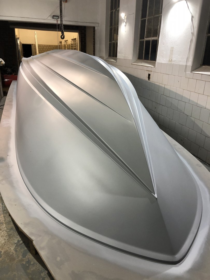

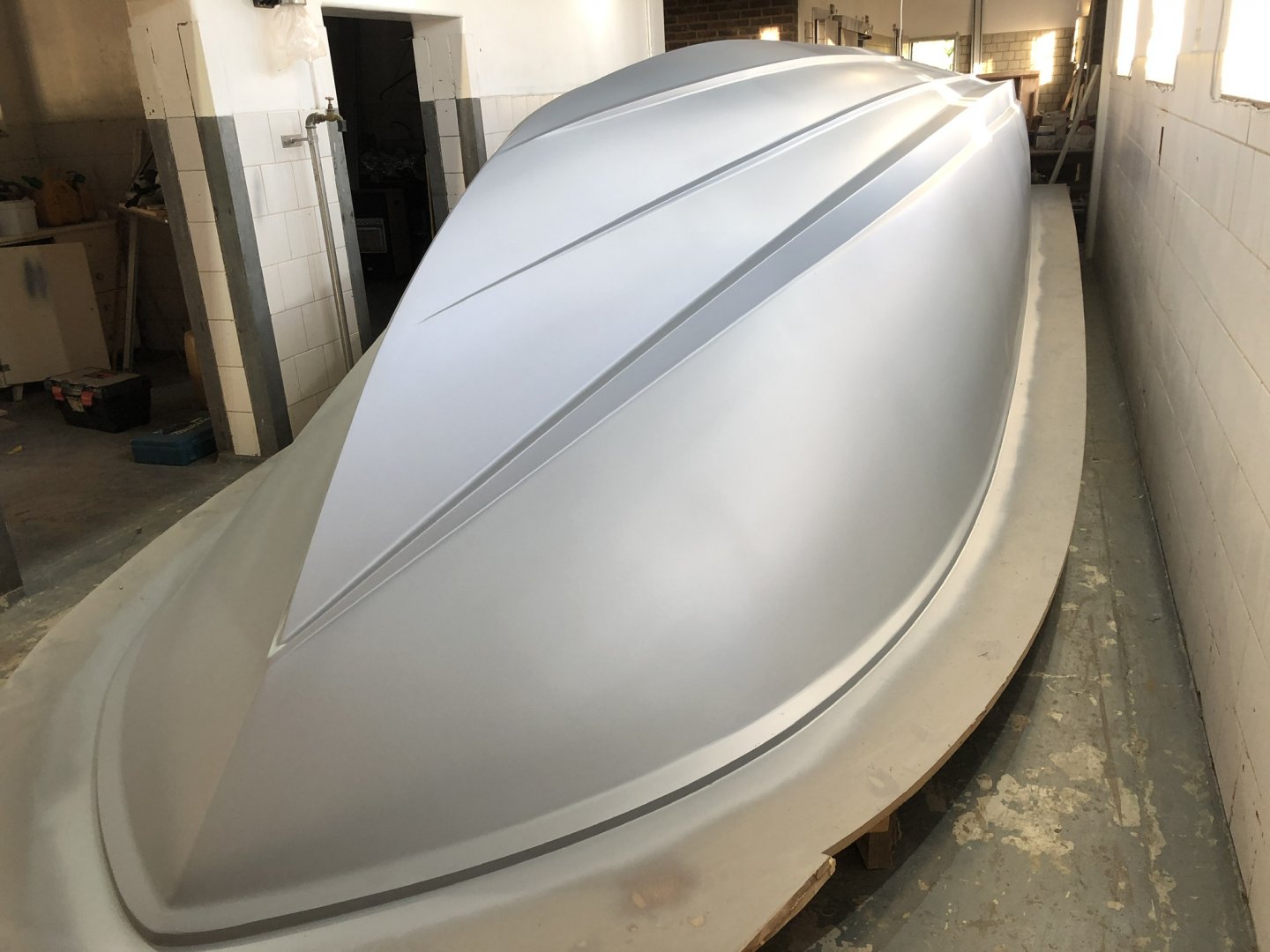

    Hi, thanks yes I am aware of this - I couldn’t find a heat stable polyester filler to use- so went with the epoxy- but now the micro balloons are a problem. I have been told to paint with an epoxy primer before applying the Duratec primer. What would you suggest ? Your input on this would be greatly appreciated.
    Thanks
    fallguy likes this.
  4. ondarvr
    Joined: Dec 2005
    Posts: 3,178
    Likes: 769, Points: 113, Legacy Rep: 506
    Location: Spokane WA
    ondarvr Senior Member
    Just a coating of regular epoxy works fine, frequently epoxy primer costs more than just epoxy.
    Either one needs to be cleaned and sanded prior to applying the primer.
  5. PBC
    Joined: Aug 2020
    Posts: 33
    Likes: 21, Points: 8
    Location: South Africa
    PBC Junior Member
    Great THANKS!

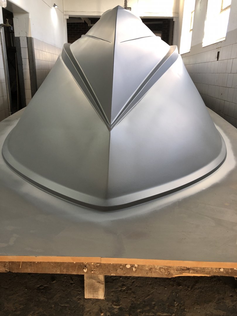

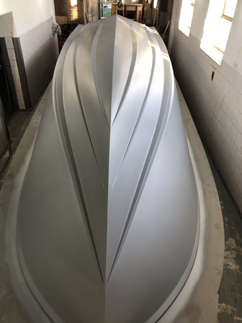

  6. PBC
    Joined: Aug 2020
    Posts: 33
    PBC Junior Member
    We finally got to the point where we where happy to spray the Duratec primer. Have subsequently spent a lot of time fixing areas we where unhappy with. Plan to respray to get everything uniform and then flat and top coat

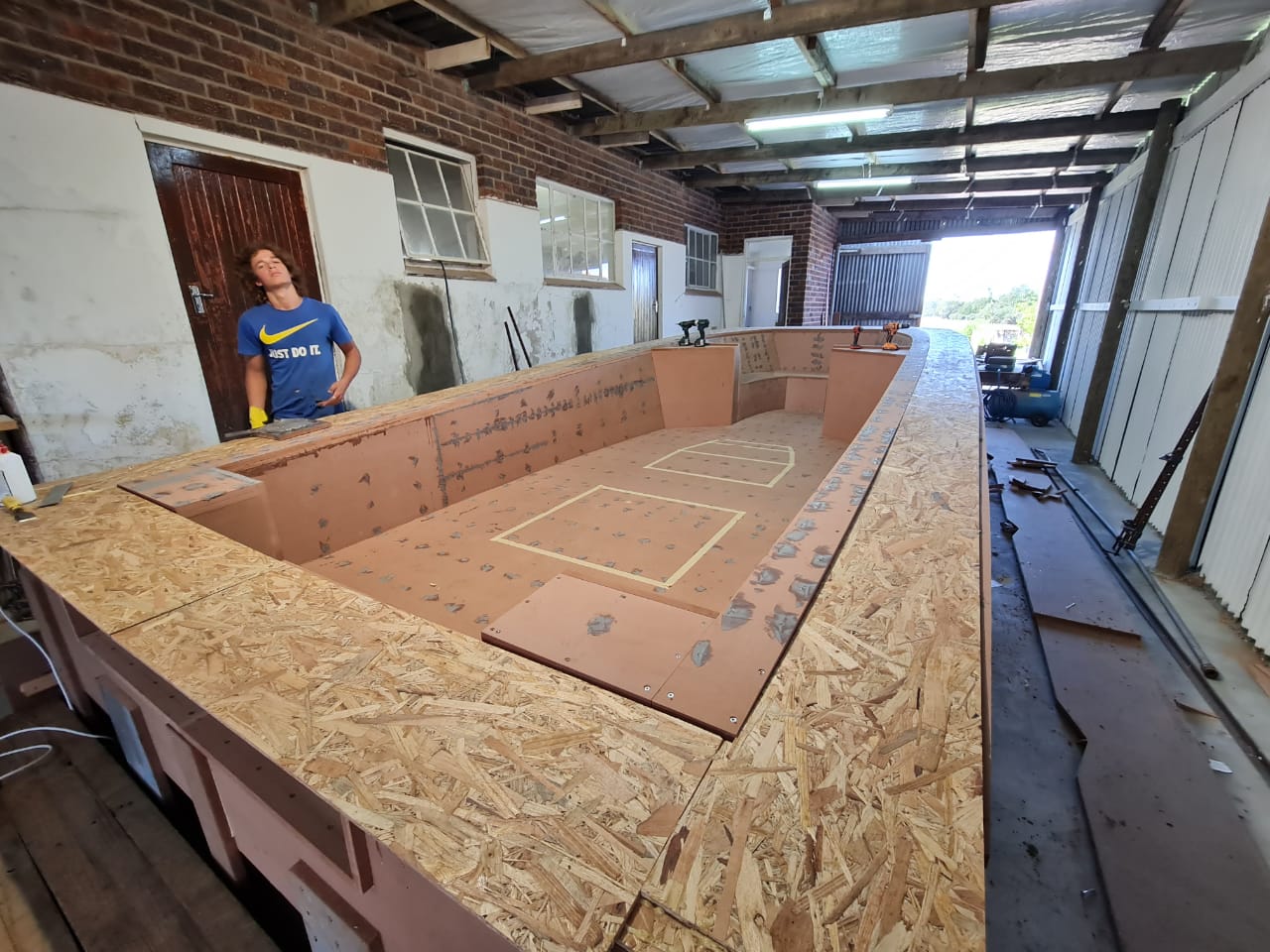

  11. PBC
    Joined: Aug 2020
    Posts: 33
    PBC Junior Member

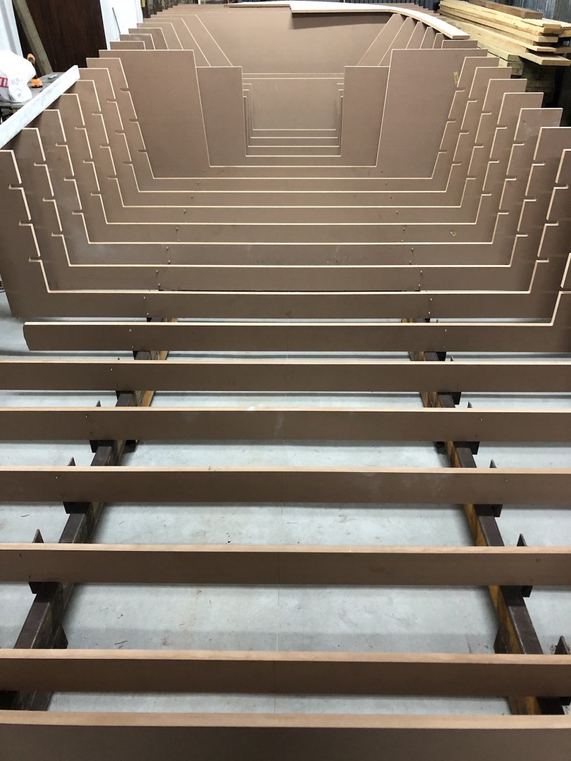

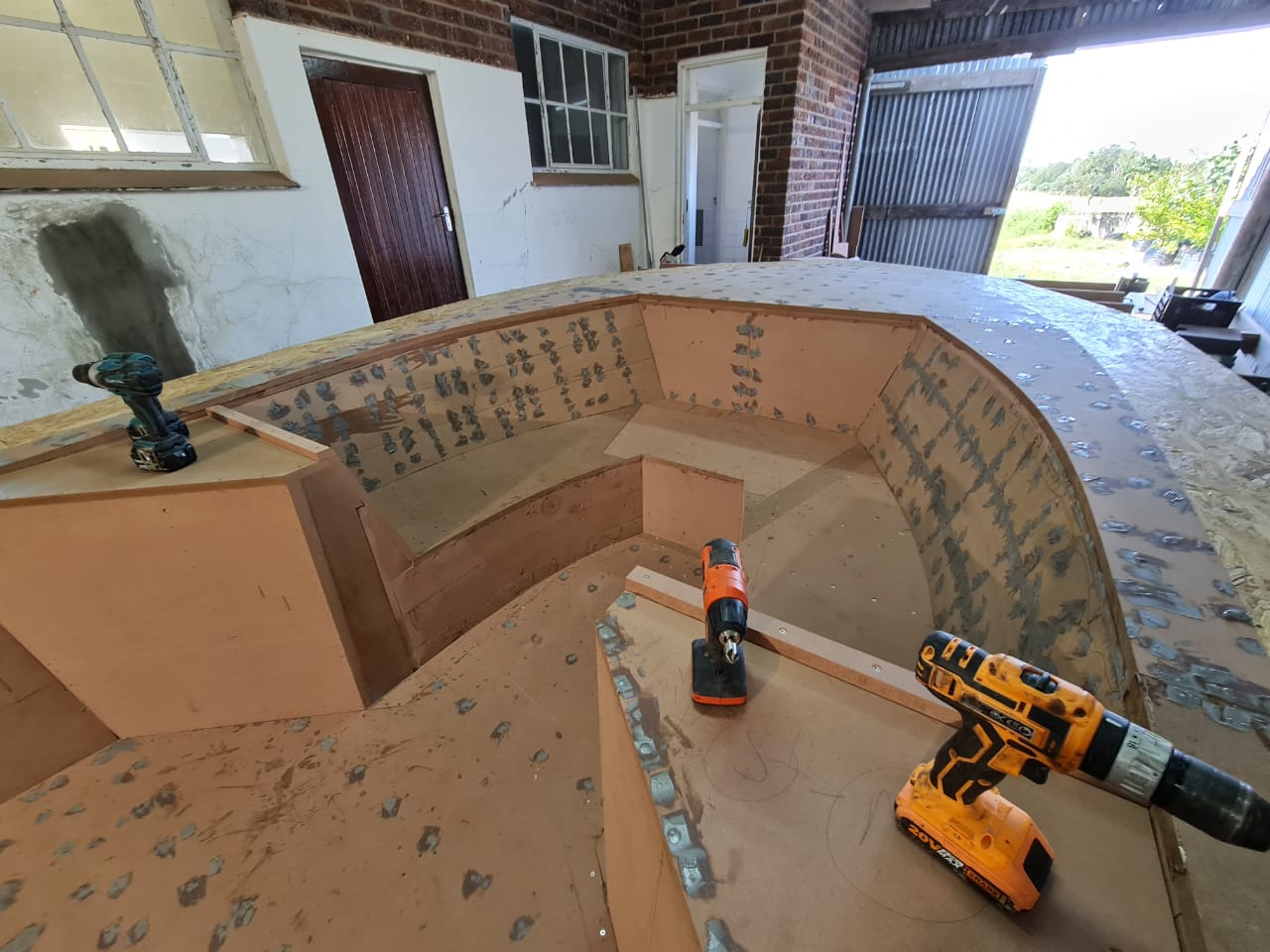

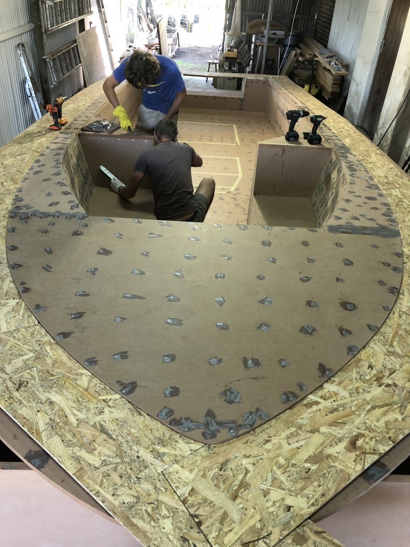

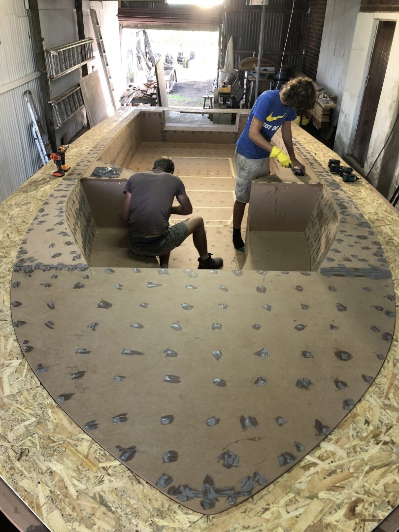

    Getting on with the deck plug. Used 2 x4 inch steel tube doubled up for strongback and then used 22mm mdf for formers and skins with a few thousand stainless steel decking screws and glue. Fairing with mixfill 80 epoxy next.
    We are doing an out turned flange deck to hull joint. We used 2 templates to aline the joint. One in the Z and one in Y plane. Anyone have a better idea for getting an accurate fit for this type of joint( other than building the deck on the hull).

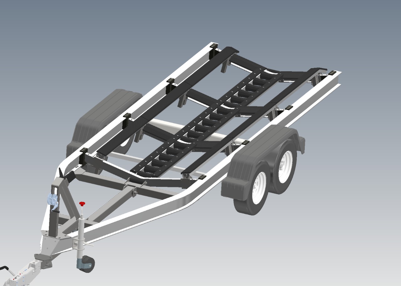

  12. PBC
    Joined: Aug 2020
    Posts: 33
    PBC Junior Member
    Trailer design, shear line template and strongback.

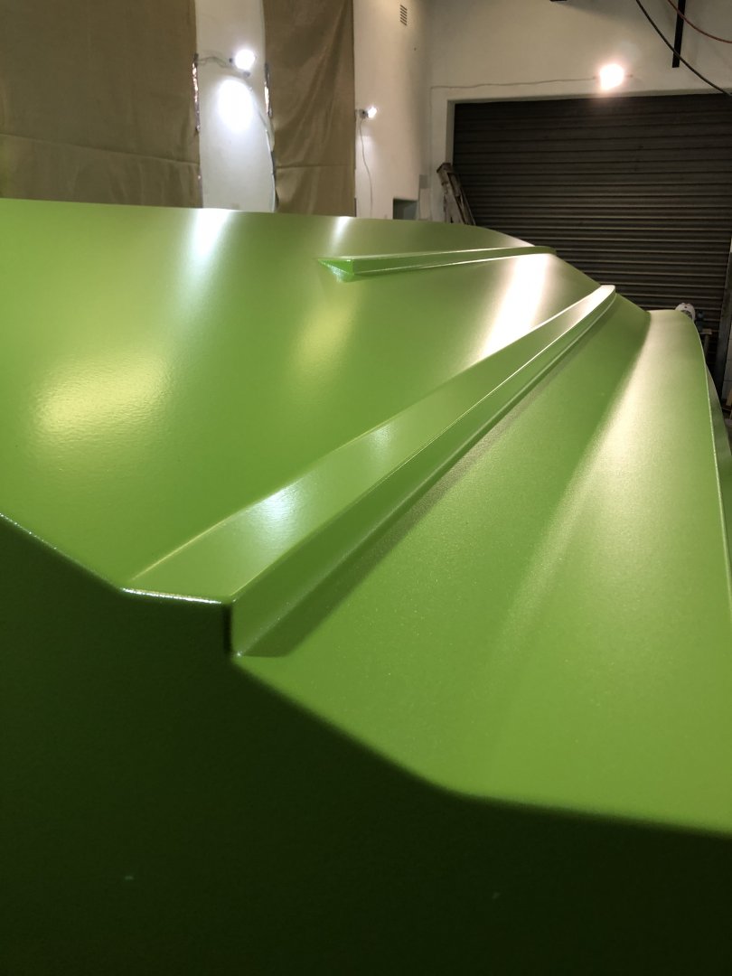

  13. PBC
    Joined: Aug 2020
    Posts: 33
    PBC Junior Member

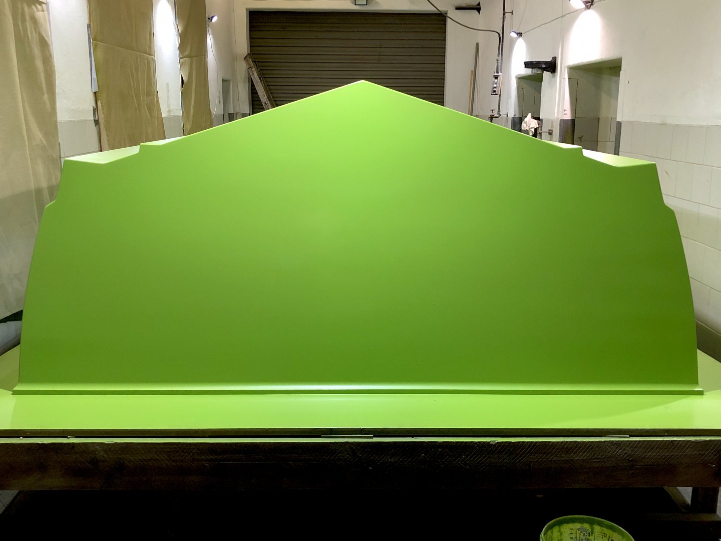

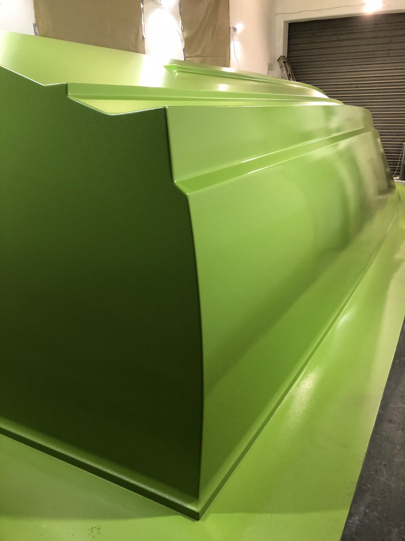

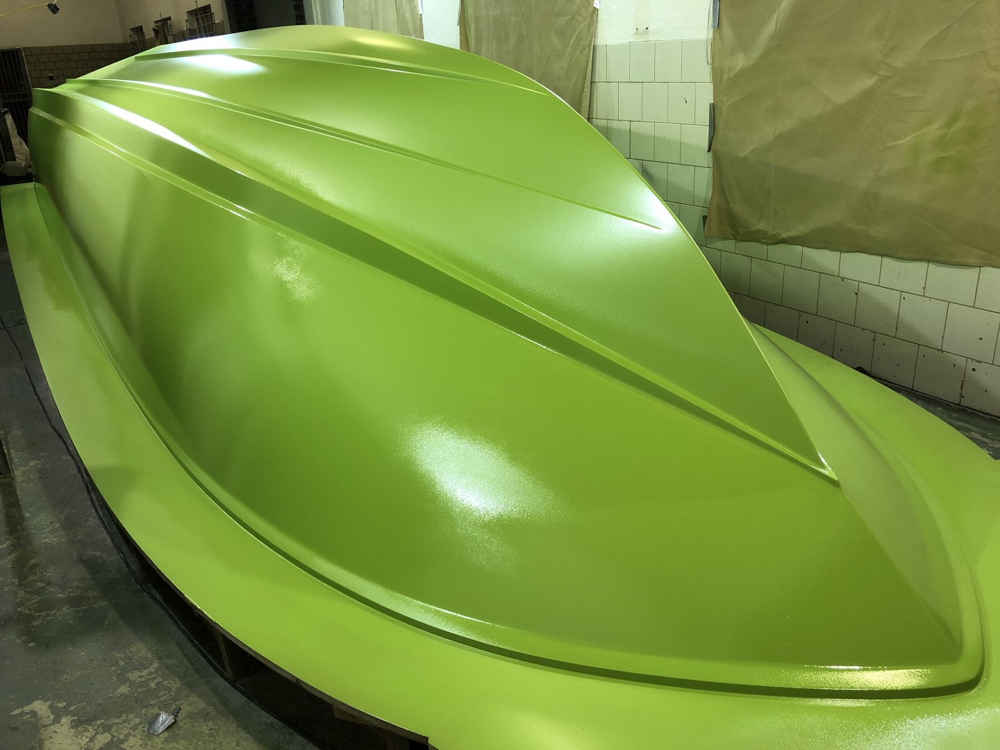

    We sprayed the Duratec topcoat yesterday. A bit of orange peel to flat out but otherwise it went ok. For a release we planning on 7 coats of Ram wax and then spraying PVA as per Tunnels instructions on this forum. Would anyone advise against that. Thanks
    fallguy likes this.
  14. ondarvr
    Joined: Dec 2005
    Posts: 3,178
    It looks green in the pics, where did you find Duratec in green?
  15. PBC
    Joined: Aug 2020
    Posts: 33
    PBC Junior Member
    Interestingly the local Duratec distributor supplies clear Duratec top coat and a pigment of your choice which is added between 3 and 5 percent. We added 3 percent.
