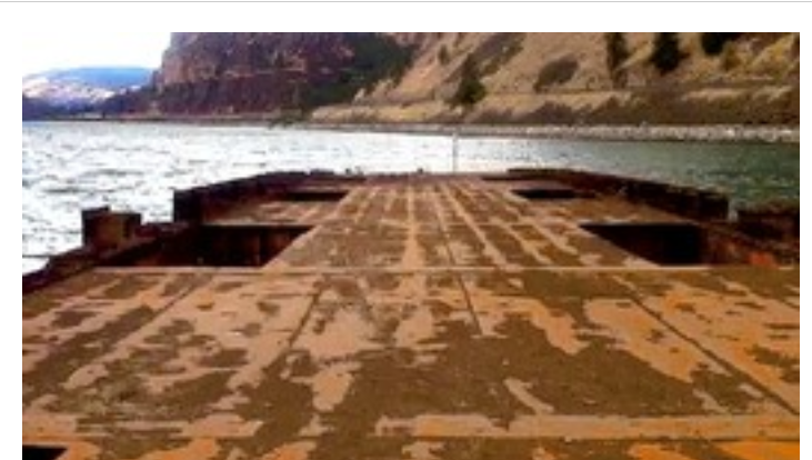

    - Maritime Sales ---> Barges for Sale ---> Look for your region and the kind of barge you want, two examples below:
    - JUS10: 2-Sectional Truckable Barge - ( Note, from 2nd above link, asking price: ‘‘US $ 83,400 Both’’ not each ! )
    - HBG10: Self-propelled Causeway Ferry Barge - MCS type

    Re post #9:
    That capacity of 60 tons of the first barge kept me wondering, a quick calculation learned that the deck would be just about submerged at 60 tons, as the draft would be 3' then, that is if those are 60 metric tons . . :confused:
    Would someone used to imperial units please look at it ?
  12. rwatson
    Joined: Aug 2007
    Posts: 5,868
    Location: Tasmania,Australia
    rwatson Senior Member
    1 Metric tonne = 1.01 Imperial ton, so there is not much difference.
    36ft = ~11 metres
    12ft = ~ 3.6 metres
    3fy depth = ~ 1 metre
    = 35 cubic metres, or 35 tonne
    so no way can it be a 60 ton barge.

    There's my mistake, I've just looked at my notepad and saw that (mistaken by the specified 60 tons capacity) I've used 60' for length, hence I came to the 60 tons for 3' of draft. :eek:
    So anew:
    L = 36 feet = 10.9728 meters
    B = 12 feet = 3.6576 meters
    D = 3 feet = 0.9144 meters
    1 imperial ton = 1.01604691 metric tons
    1 metric ton = 0.984206528 imperial tons​
    L 10.9728 m x B 3.6576 m x D 0.9144 m = 36.699 m³ = 36.699 metric tons = 36.119 imperial tons = 1 imperial ton total weight per feet length to submerge this barge.
    Thus when the total weight (barge's own weight + payload) is 36 imperial tons then the deck is level with the water surface, and the barge is about to sink, if not capsized by some uneven load already. :(
    So, what would be the Max Safe Workload for this barge ?
